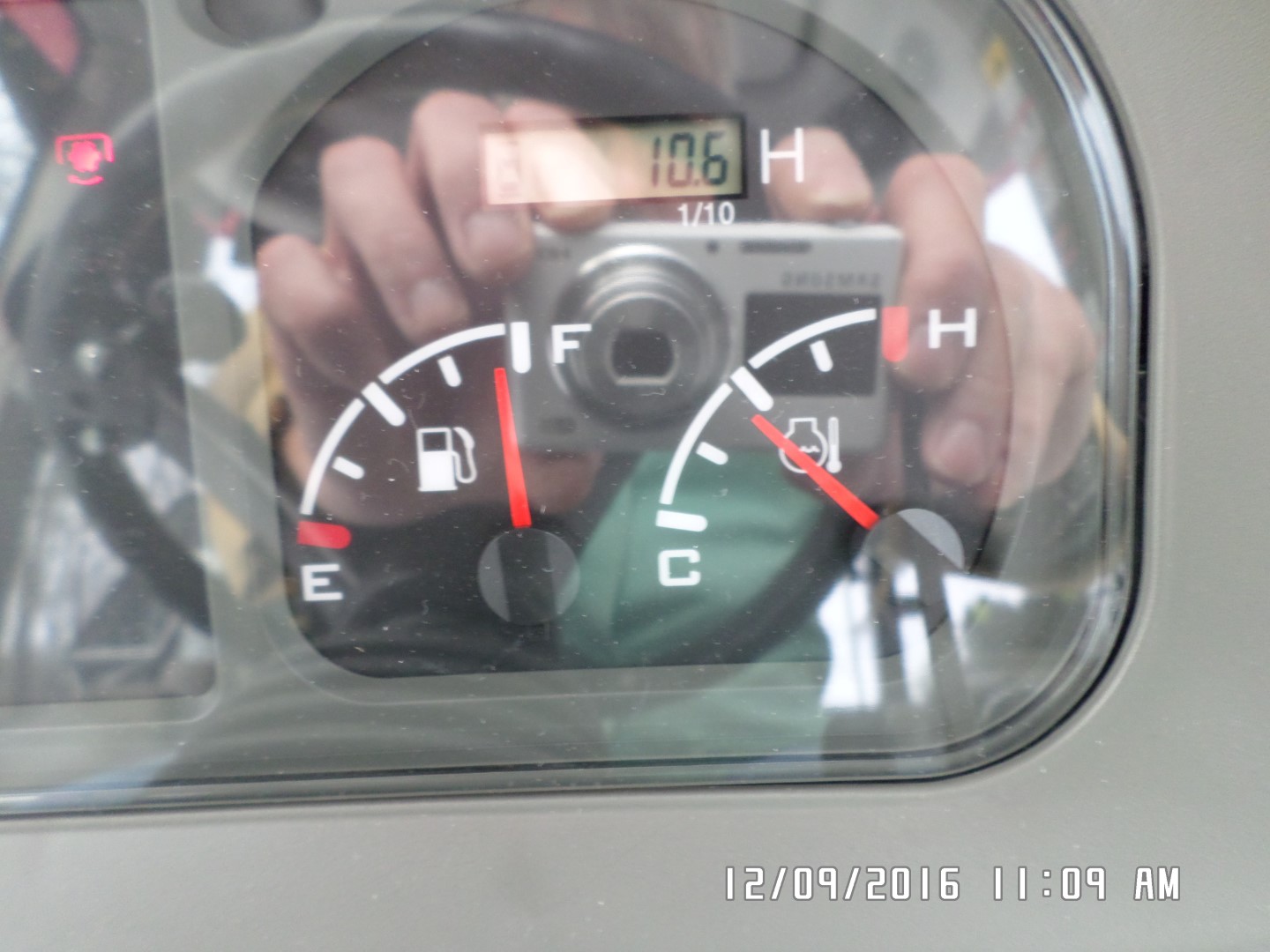

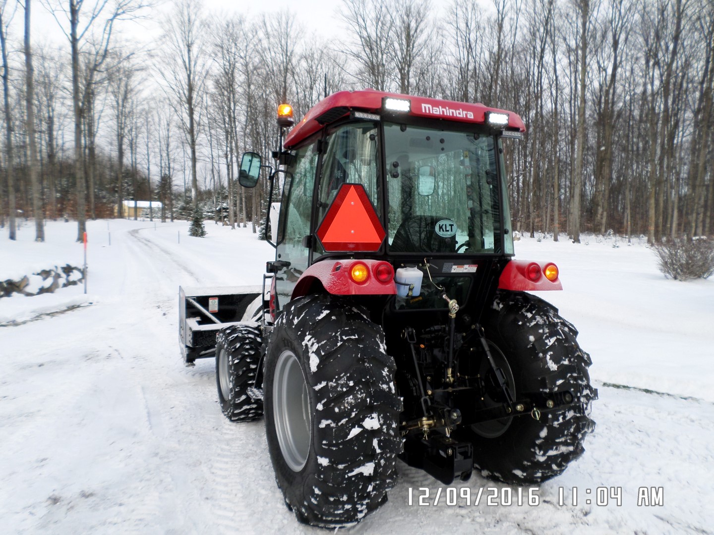

Oky doaky... had mine out blowing snow today, about 20 degrees outside. Temp gauge went up to 1/4 like your picture when I was warming it up, soon as I started working went up to just below 1/2 way and stopped, probably thermostat set point. When I got done, and was idling cleaning up before returning it to barn, it went back down to 1/4... good 'nuf fer me... [ note, I have a 12" holed sheet of plastic installed front of the radiator ] Tried to catch a picture with the super bright orange LED emergency flashers lite up, but couldn't do it.......
