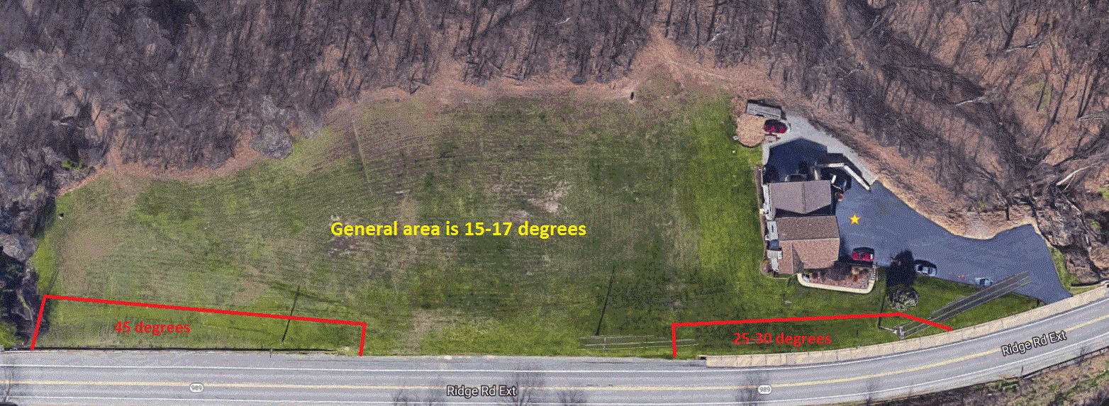

So, would you choose to side cut a 17 degree 3 acre yard with a CUT, or cut up and down? I go side to side because the yard is a long rectangle, going side to side along it means way less abuse of the Hydro unit on the GT, maintaining full 6-mph speeds and fast turn around at each end. I only cut up/back down in reverse on the 32 degree bank, and I believe that this area is what looks my hydro transaxle in these garden tractors. This bank is also why I need the belly mower, I couldn't back up it and if I pulled up with a pull behind finish mower I would have a huge swath to weed eat ��
The problem with the SCUT is the light weight and weaker hydraulic performance. I desire to move the lower edge of the yard back about 15-20 feet into the woods over time. That will require a few hundred trees being dig out over a few years. The trees aren't overly large as this was all cut 16" and larger about 20 years back. It's about time to sell the standing timber again, and then use this for clean up and pushing the annals back to add yard on the low side.

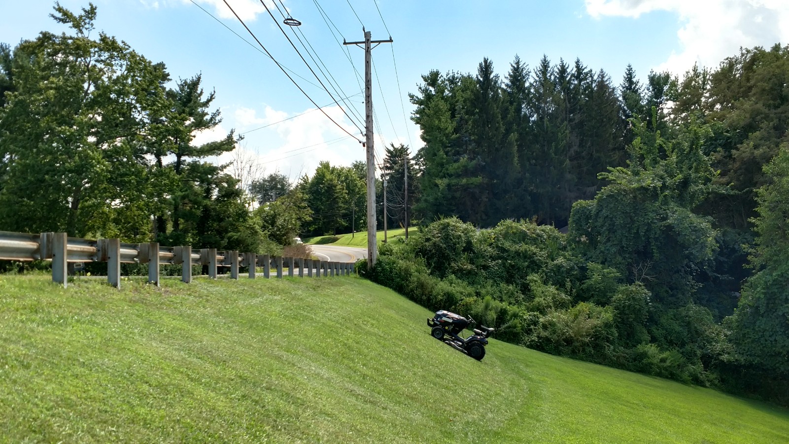

Generally safer to go up/down instead of across a slope (tractors are narrower than they are in length; hence a rollover happens sooner than a wheelie). Hydro trannies in a CUT or SCUT are in a whole different league from those in GT's and lawn tractors. Much more rugged, climbing slopes isn't an issue.
Have been using my SCUT since 2005... relative to the GT it replaced, it's double the weight and eats hills for breakfast. The hydraulics are plenty for a 2,000 lb machine. Admittedly I used a much bigger tractor for really heavy work, but with your mowing requirements, the low COG of a SCUT vs. a larger CUT would get my attention.

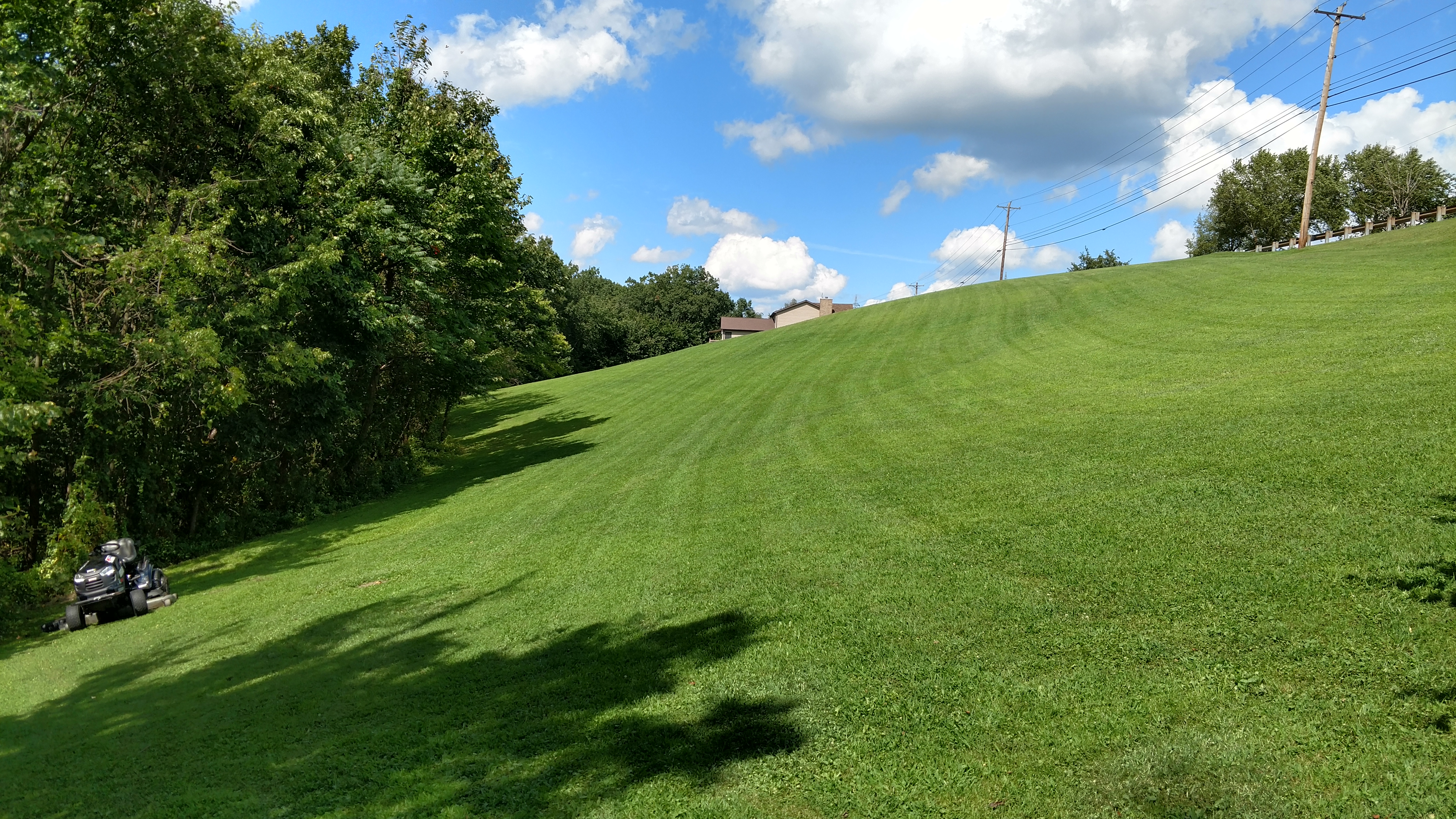

Our property is a long rectangle, the long side is along the top and bottom of the hillside that we are built on, and I've found that to maximize mowing efficiency and reduce wear and tear on the hydrostatic units that mowing side to side long ways is by far the best option. Before we went to this, we cut the perimeter and worked in towards the center with 4 corners that each require a back-up to re-position. That adds time of around 15-20 seconds per corner. Then I GPS clock my speed going up hill and find that I bounce between 3 and 4 MPH uphill full tilt, going across I am 6-7 MPH and going on a downward angle I am at 8 MPH. So I eliminate the 3-4 MPH uphill travel times along with the 4 corner adjustments and in trade I still spend 15-20 seconds doing end corrections, but always move at 6+ MPH. That is fast and it saves eating the hydrostatic transaxles, it is a win/win with no downside on the Husqvarna (Craftsman branded) GT with high speed cutting ability.
I am not against adding some time, as I do admit to enjoying cutting grass! I cut at least once a week, I actually GPS recorded my cutting times and ground distance and I know that I travel 5.7 each time I cut and do it in 1 hour and 40 minutes. That does not include the additional hour of push mowing and weed eating. So adding a half hour is not a bad thing. But adding an hour or more will start making something I look forward to doing into more of a chore.
I have been working an excel spreadsheet as I collect data on various units. A new one that may come strong into play is the Kabota B2601 (wider and faster than the B2301) with its 3 range hydro unit. The LSXJ2025 was a very pleasing unit with a notably faster low range over the Mahindra Max26 XL. That slow low range took the MAX26 out of the running... even though prior to driving it I thought that it was a serious contender. We also asked the Mahindra dealer who is 8 miles away if he would bring a MAX26 to our place to test, he says no. He does not take machines to a potential customers property because he feels that you can test and get enough of a feel of the machine on his property. My problem is that his rolling hills are not a match to mine... so I fear making a $30,000 purchase and being upset that it was a bad choice. When I get really ready to make the move, I will absolutely be asking to have the prospective purchase brought to the property. I don't know what I will do if no one will allow this.
I am going to examine a KIOTI CK2510 soon as well, on paper that one has the most going for it... but it is a 2 range unit. I need to see if it is more like the Mahindra (slow) or more like the LS XJ2025 (fast).
So currently, the way I am ranking on my spread sheet I see them rank as follows:
#1 KIOTI CK2510 HST
#2 Kabota B2601 HST
#3 LS XJ2025 HST

Having owned the LS J2023 which is essentially the exact same machine as the XJ model, I'll tell you from experience that the tractor feels tippy on slopes. It has a narrow width and I didn't like driving sideways on slopes whatsoever.
It looks like your yard is wide open without any obstacles. For that, I'd much prefer a wider more stable unit like the LS XG3025 and a rear finish mower.
The Kioti 2510 vs the XG2025 is not really a fair comparison. The Kioti is a larger framed machine than the LS.
But if this were my choice, I'd buy a good used zero turn mower like a Grasshopper, Scag, Deere, or Hustler and just blow through that grass in half the time you'll spend with a tractor and mid mount mower or finish mower. A zero turn will be ideal for mowing slopes. They are very wide and have very low centers of gravity and are meant for mowing on some pretty steep slopes. Tractors are not really meant for that.
Geez, I just saw your budget was $26k. For that kind of money, you can buy a brand new LS XG3025 ($14k) and a brand new commercial grade zero turn ($10-12k) and have the best of both worlds. A tractor for playing around on and working and a commercial grade zero turn to blow through your mowing in less time and that will last well over 1500 hours.

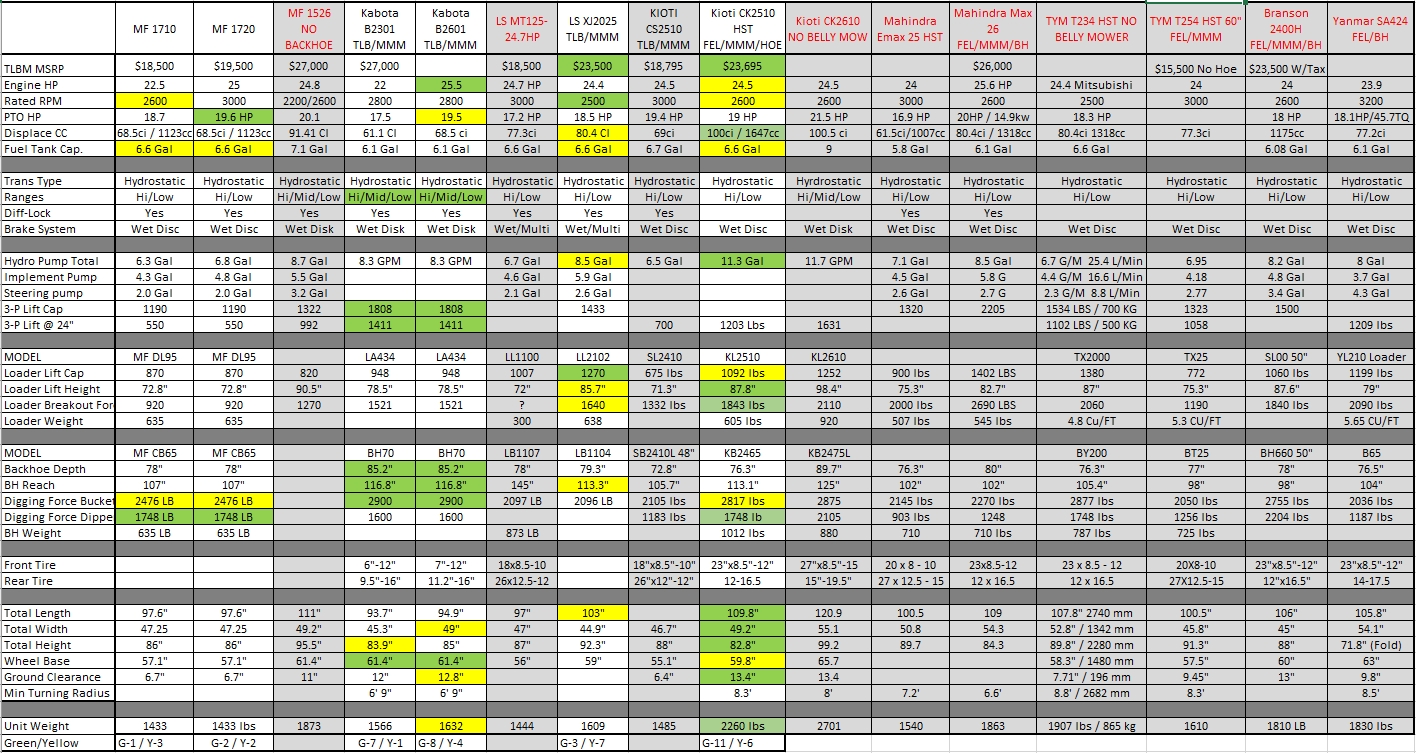

Sorry, I forgot to stick my updated spreadsheet in.
Green blocks are the most #1 ranked desirable trait to me in that category, yellow is the #2 ranked desirable trait. The yellow blocks should not be considered bad, they are just not weighted quite as heavily as the green. But looking at the bottom where I total greens and yellows on each unit, you see why the KIOTI is one that I really want to go see in person and test drive.
There are also intangible items from a spreadsheet perspective such as the Kubota having a fender mounted FEL joystick and tilt wheel for comfort. The KIOTI has a suspension seat with spring tension adjustment. Some things like these do have value yet are difficult to "chart" out. I could keep adding to the spreadsheet, but at some point the water starts getting muddy from data overload.
I am looking at low height, wide track width (hill stability), heavy weight, best digging/hydraulic performance, obviously low cost of entry, PTO HP.... so I am trying to look at the traits that make the machine better overall. Paint color is NOT a part of the decision.

Again, you're comparing apples to oranges with the Kioti 2510 and LS XG2025. You're going to get a bunch of "green boxes" in the dimensions category because the two are not even close to comparable in size. So if you're just counting green boxes, that's not really the best way to compare. Especially when you're comparing machines of different frame size. The same with your hydro pump size. The Kioti has a larger hydro pump because it's a larger machine than the LS. And look at the loader capacity! The LS has more lift than the Kioti and it's even a smaller size tractor!
The LS model that is in the same frame class as your Kioti would be the XG3025. Now that would be a more apples to apples comparison. XG3025 has a 12.5gpm hydro pump which beats the Kioti. Lift capacity and breakout force blow the Kioti away also.

Where is the Kubota B2601 in that mix? Is it more comparable to the LS XJ2025, or would you move it up to be compared more in the KIOTI CK2510 area?
When you talk about size, I think LxWxH and the CK2510 only 6" longer, 4.3" wider, +0.8" wheel base and 10" overall shorter height than the LS XJ2025, so I would think that standing between the 2 units that they are visually very similar in size. There is a 628 weight difference... now that I agree is a HUGE change.
It's hard for a non tractor guy like myself to comprehend the defining line between one "size" and another when the physical sizes are so close.
If weight is the deciding factor, I guess that the Kubota B2601 is not equal to the KIOTI CK2510, but would be compared to the LS XJ2025?
   / 25HP HST tractors and low range speed. #20
Yes, the Kubota B series and the LS J and XJ series are similar in size and would be a good apples to apples comparison. Think of them in terms of cars as a "unibody" whereas the Kioti would be a traditional "frame" body. The larger and beefier frame size is where you're getting the extra weight from with the Kioti.
I consider the Kubota B and LS J/XJ series to be kind of a "half step" between the SCUT and CUT class machines. They are slightly bigger than SCUTs, but not as big as a CUT class.
But again, if I owned your exact property with a budget of $26k and you want a backhoe, I'd buy a new LS XG3025 with a shuttle shift and backhoe and buy a dedicated zero turn mower.
