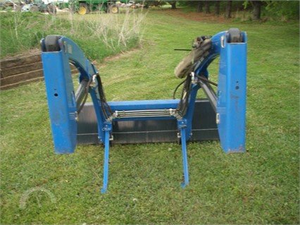

I just ordered a new Boomer 55 a couple weeks ago at my local dealer. They don't have a "Boomer" on the lot and do not stock them. Their excuse is that most customers want the cheaper Workmaster's. They know very little about Boomers. The salesman did not even know that NH made one with a CVT transmission until I brought it to his attention. While we were discussing options I asked if there was another loader besides the 260TL that was available and he said that he was not aware of it. Since then I have discovered that a 270TL is available for the Boomers with the CVT transmission and I would think you could put one on a Boomer 55 with HST. The 270 has a lift capacity of 1000 lbs. more than the 260 which I like. One of the reasons I am stepping up to a 55 from my TC34DA which I purchased new back in '08 is the much higher loader lifting capacity. Does anyone out there know for sure that a 270TL FEL will fit on a Boomer 55 ? It's no use to ask the dealer as they probably don't know. I am getting a cab, 935GBH BH, radio, front grill and just about every option you can get on a 55 and I sure don't want to skimp on a loader on a tractor that's costing me over 50K ! This is the last new tractor that I will ever purchase. Anybody know for sure if it will work and if it will I will get it instead of the 260.

The 270TL appears to be for older model CNH compacts that may have used different mounts so it may or may not fit. The mounts on the loader appear to be different. I'd definitely want to try it before hand. The picture attached is a 270TL loader end mount. This is different then the 260.
When I look at lift capacity to max height 500mm forward, the 270TL is 1830lbs and the 260TL is 1849lbs. With that said I would just stick with the 260TL. img.jpg

The NH build page only lists the 260TL as an option for the Boomer 55 so I would stick with it. I do see an older spec sheet where the 270TL was for the Boomer 4055 but that is an older model so I doubt it would fit the newer model.

Still trying to wrap my head around the 270 fitting. The picture I posted shows the 270 loader mounts closed on the back. Whereas the 260 is open in the back. So I'm trying to figure out how it would mount.
