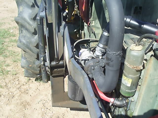

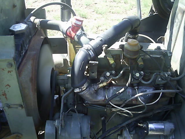

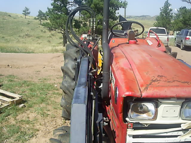

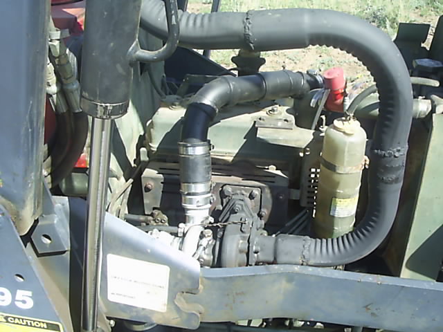

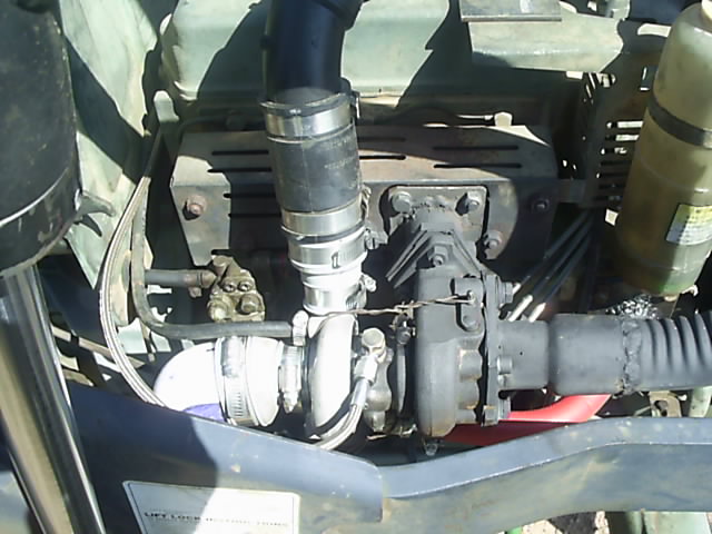

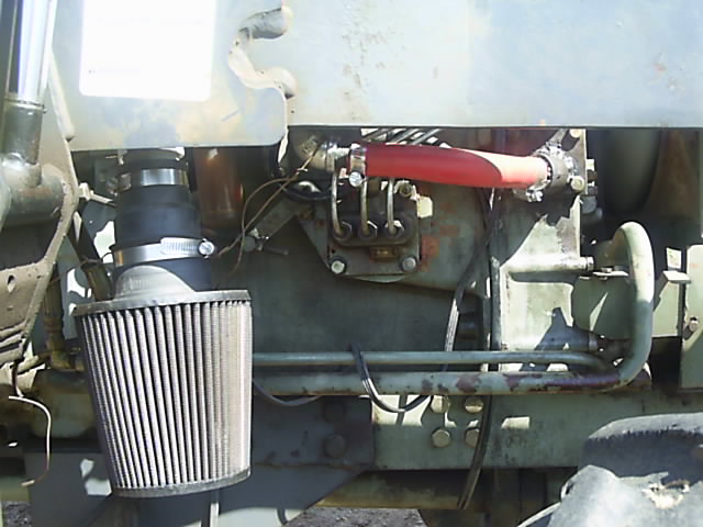

Finally got time for photos.. I still cannot believe the increase in torque and power!!! Usually while driving up a small hill if I were to pull full throttle the tractor would maintain 2000 rpm and smoke black like a tractor at a tractor pull. NOW WOW I drive up hill and push throttle as normal and with in 3 to 5 seconds the govenor has kicked in at 2800 rpm and I back off!!! WOW!
I am still grinnen!!! If this is what a 26 HP tractor is like I cannot believe what a 40 HP tractor is like.
Couple of other things to mention. I have to get a on/off (brass) valve for thermostart. Intake pressure blows diesel fuel out of storage bowl. I have it clamped off right now as you can see from photos. Also intake manifold gasket was not designed for pressure I do not believe. I had to remove mine and install a new gasket that I cut for size. I was able to use gasket sealer on the new one. The old one was rubber and would not stay set with sealer on it. This stopped all intake leaks.
