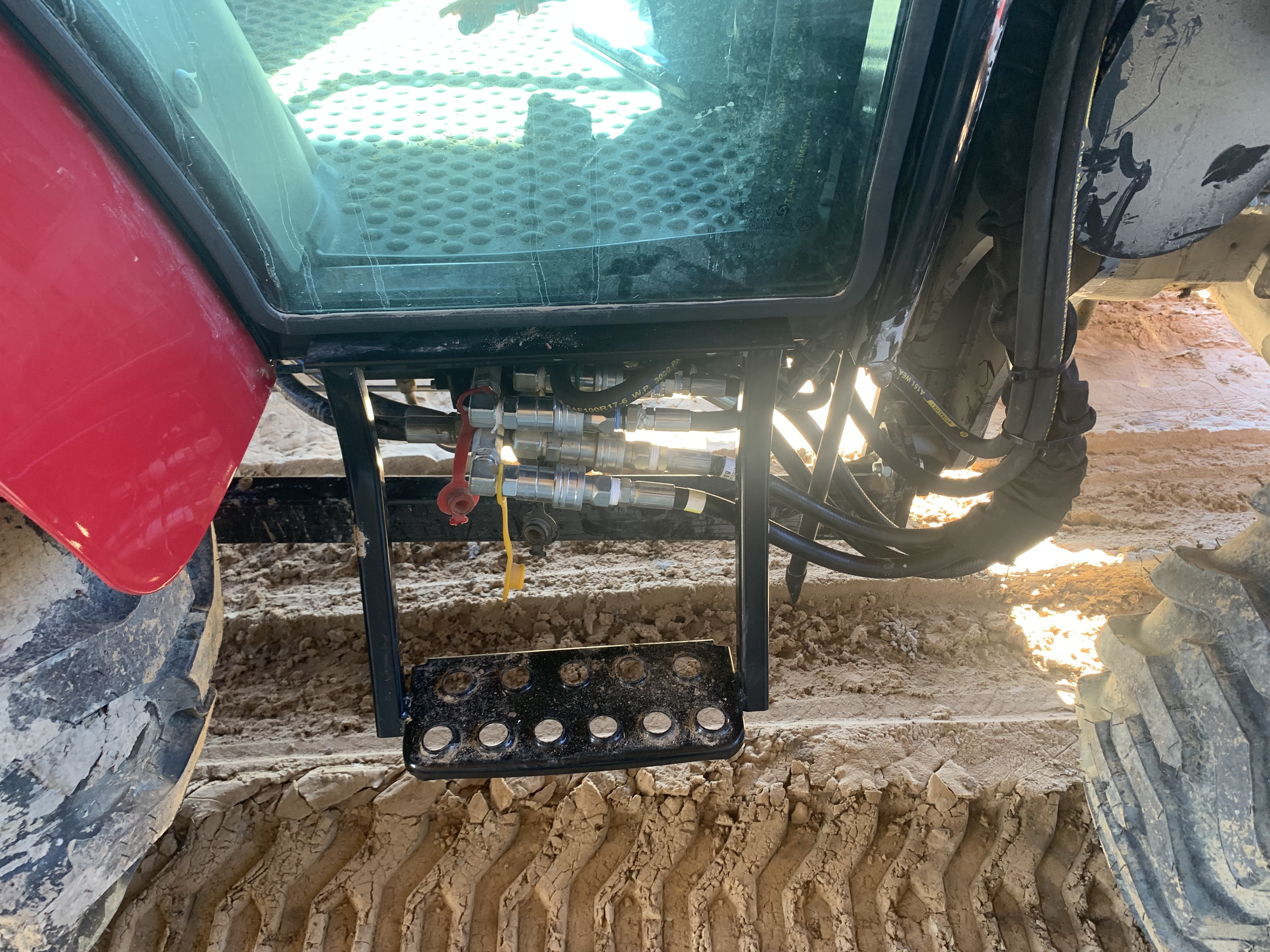

I have a 2022 Mahindra 2660 built by TYM with one rear remote and i would like to add another to have two remotes anyone have any idea where i could try to find the factory type remotes for a cab tractor. Wondering if maybe TYM might fit.
I have tried on google nothing so far in stock.
/ 2660 cab tractor remotes #2
Besides you should still be able to get them at your Mahindra dealer, yes the TYM valves should be the same.
Or just add a diverter and use the same valve-controls and add as many sets of couplers that you may need.
Right now I think that Summit probably has the best deal for diverters.

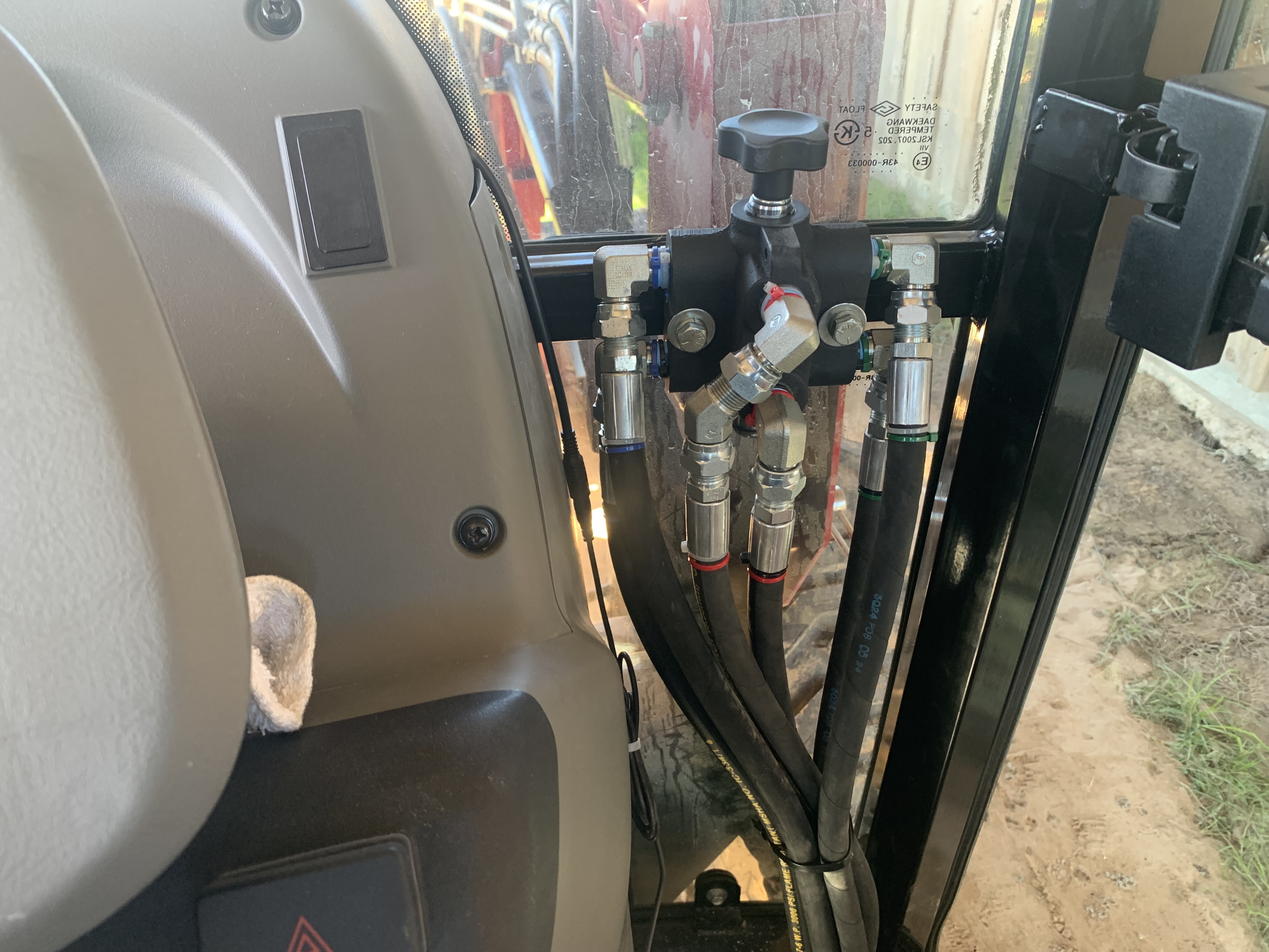

I am thinking about going another way by using tractorinnovation remote hydraulic kit to be able to use my loader control to operate my grapple when i need it, check them out i really like Andys kit and especially the ease of installation. Just what i needed.

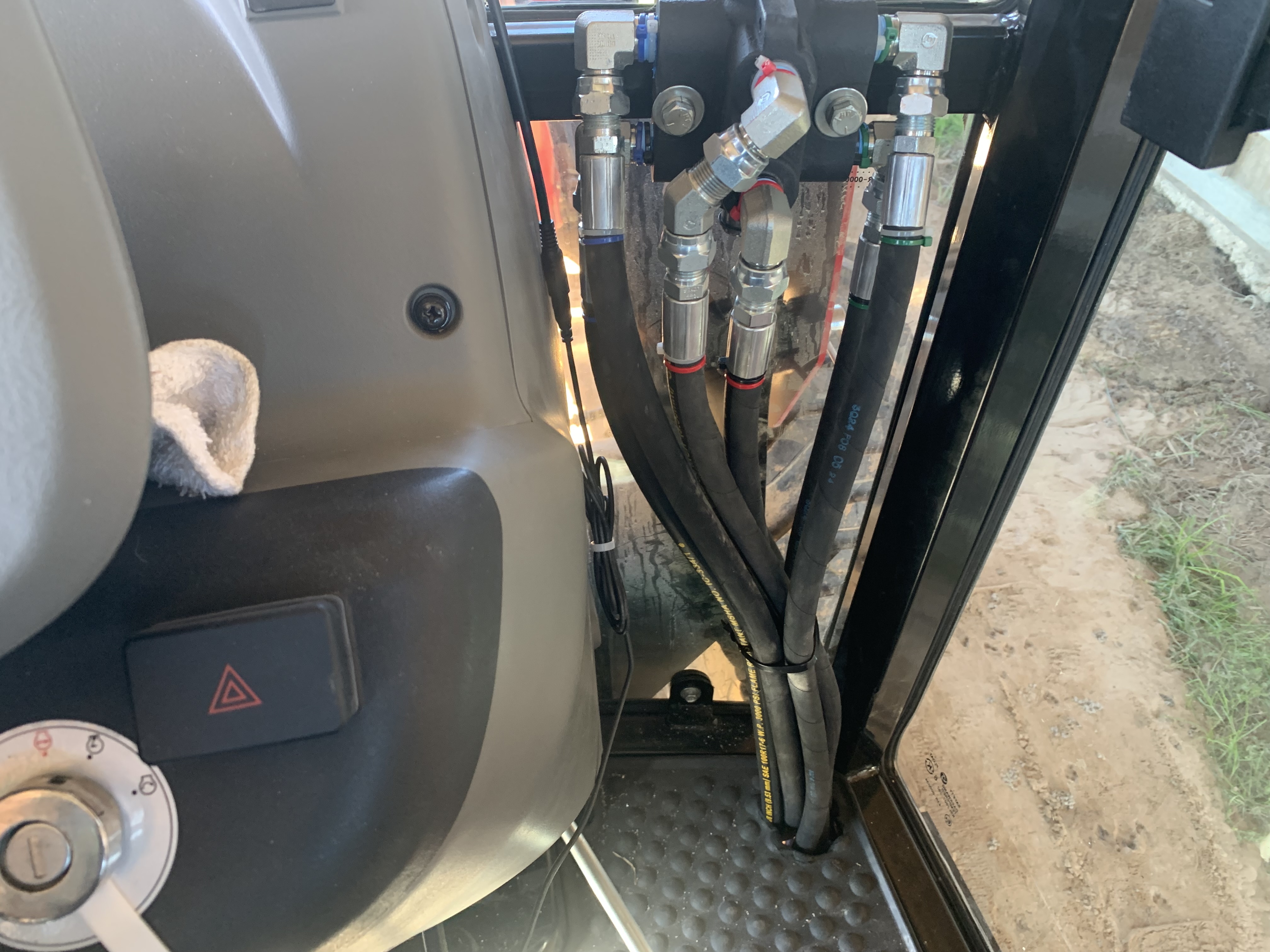

This is what the kit looks like installed from tractor innovations at a cost of $625 tax shipping total cost,it is connected to the dump curl cylinders only and Andy with TI is great to work with if you have trouble installing. I love the price and simplicity of this kit, it does the job without breaking the bank.

Glad that it worked for you. I do have a concern for the amount of heat that is going to add inside the cab tho.
#13
Thank you Engineer for the comment but can you explain how it will add heat to the cab?

How do you add a second rear factory remote? Does it just stack on top of the existing valve?
#15
No instead of placing the
just install the hydraulic quick connector to the rear instead of the front of loader, go look at one of his u tubes then you can see how simple it is.
