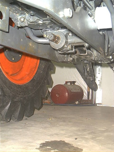

Alan,
If the new filter is the grey one (as seen in your photo), and the frame below the filter has a notch to allow access to the filter, could that frame rail also be new?
Peter
   / 2710 Power Steering Fix! But...
#32
>>>>>If the new filter is the grey one (as seen in your photo), and the frame below the filter has a notch to allow access to the filter, could that frame rail also be new?<<<<
Thats a good question. But they didn't mention this as being one of the parts replaced.
Alan L., TX
   / 2710 Power Steering Fix! But... #33
Alan
The frame part numbers changed after Serial # 11499. The different parts look like an added hole at front end of frame.
