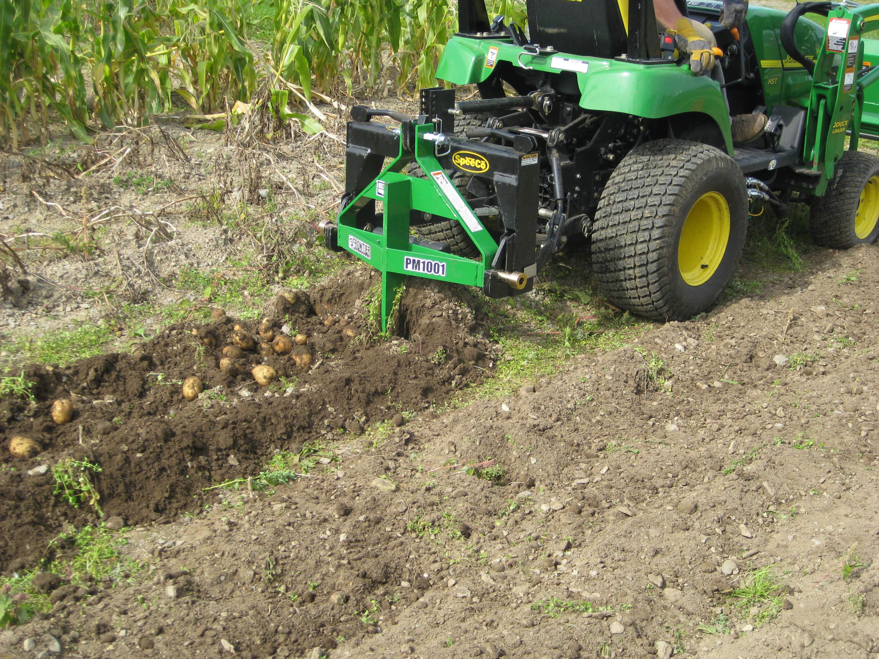

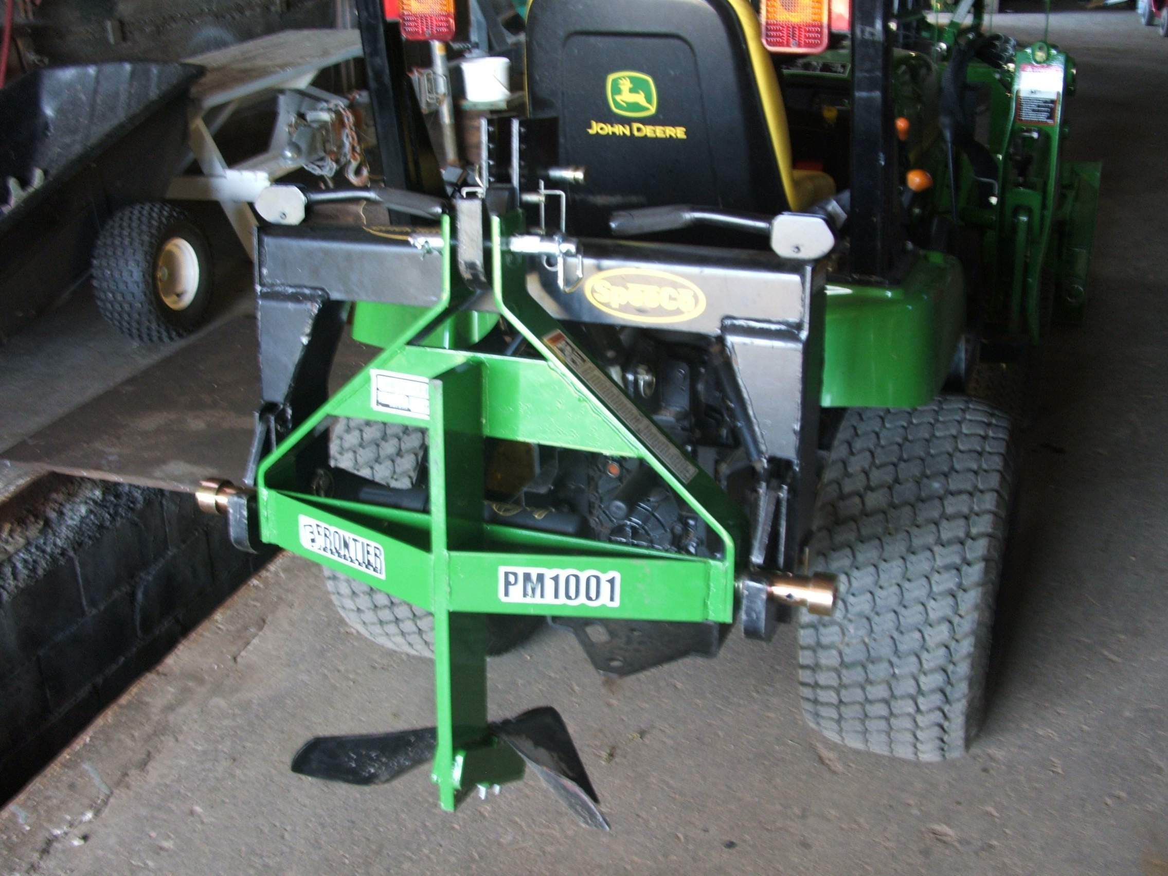

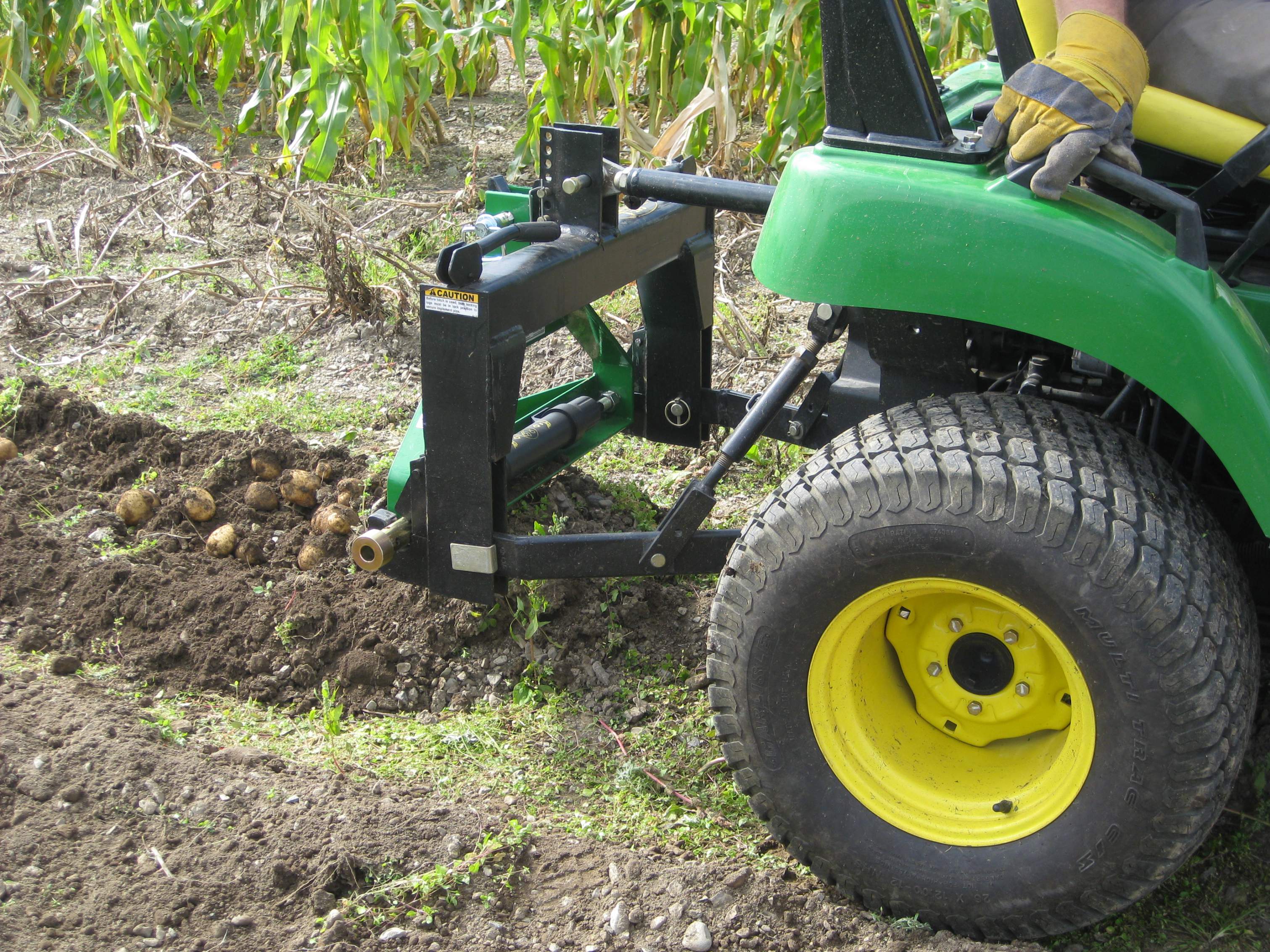

The OP mention a middle buster which is usually use for potato digging or making furrows and that will not be a problem with his 2720. On the other hand, if he is going to use it as a subsoiler, I can not see this thing working for ripping ground. JMO
