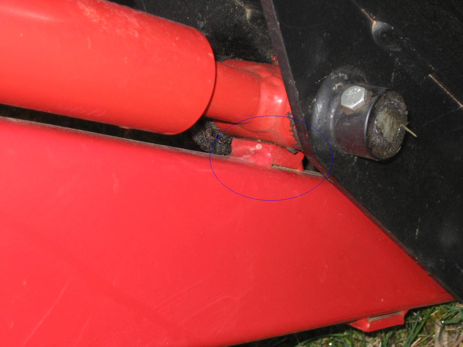

One more thing. My front end loader has a peice of 3/8" plate welded under the lefthand actuator for the FEL. The right side doesn't have one. When you retrack the bucket all the way the back the bucket twists a bit because the right side can travel a bit more than the left. The ft side stops on the plate and the right side has no stopper. I'm assuming all 2310 FEL come this way. I'll probably weld something up there. I can't see this constant twist doing any good in the long run.

If this is the piece you mean, I have them under both cylinder ends.

Yes those are the pieces I'm taking about. Why would my tractor only have one?

Hi, Keith, my tractor also has two pads , one on each arm. 1972 has a point about the dealer. You seem more than capable of fixing it yourself, and maybe even making your own thumb, I ordered mine from Bro-Tek , I would be foolish to think I have the time right now to build one. there are many threads on building thumbs alot of great information on this site. I won't tell you how much I paid for it, if you email Richard he will give you a price. I will post my mounting and usage when I get mine.

I have two pads as well and I think they are used as stop pads when the loader bucket is curled. I think one was missed and you should have two.

You could bolt or glue a stop on the right side easier than having the dealer do it if they are that far away. I could fabricate a piece for you if you want to help.

That stop is really no big deal. I have seen several over the years that had two of them and one didn't even touch. Let you dealer know that it is missing. Then have them put it on when ever you have to have the tractor in the shop for servicing etc.
