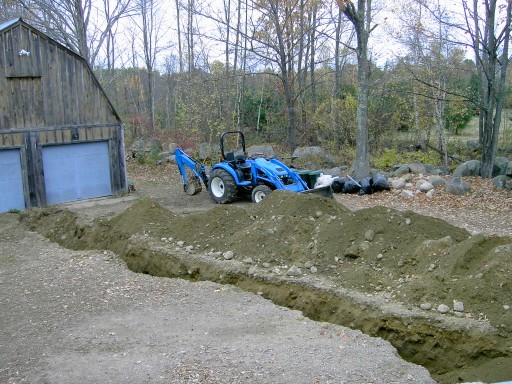

I'll check mine when I get it back. I traded with a friend for his TC-35 w/ backhoe. I needed a backhoe this week & he needed a tiller.
I changed the hydraulic fluid & filter at 50 hours. Did it myself, pretty simple. So far I'm real happy with the tractor (mine, his is nice as well).
