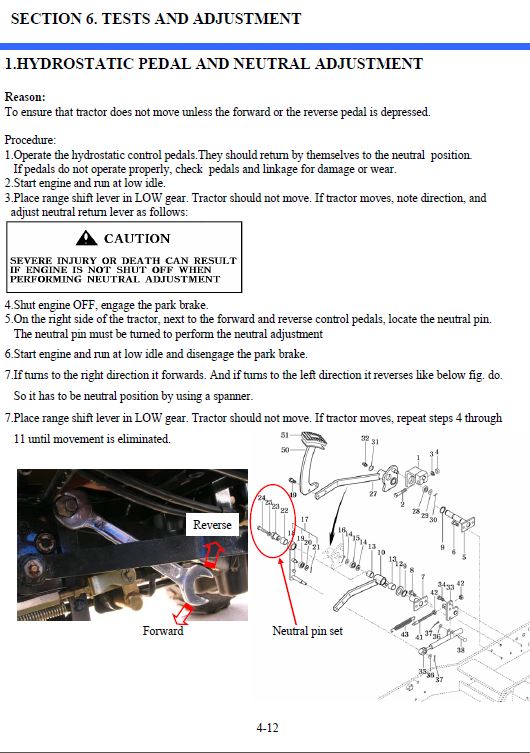

myyaz33 has the fix for you - just be aware that 1) it isn't running when you do the adjustment and 2) it doesn't take much of a turn to make a big difference, more of a 'suggestion' of a turn should do it. It is easy to do though.
   / 293 Tranny creep #13
Thanks for the tips.... the "isn't running" part is funny:laughing:
