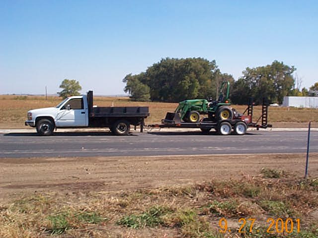

I have a real hard time believing that is a 10,000# trailer. Maybe so. For a year 2000, and all that is wrong with it, no fenders and the owner claims that he over loads it, no way. There are plenty of good deals out there on new or very good used trailers. I'd encourage you to keep looking.
Paul
   / 2OOO Hudson 5 ton Trailer #26
Sorry Jeff, forgot to add what I thought it is worth. Knowing what you discribed, and the abuse the owner gives it: $20.00 a ton. I'm not trying to be smart, but there is no way I'd load my tractors on that and head out on the roads. I use my equipment commercially and for my self. My insurance agent would have a stroke if I asked him to insure that. The attached photo is of my trailer, yeah its hard to see, but its a 2001 DCT, made here in South Dakota. 7000# GVW, 4 wheel brakes, all lights, 5000# tongue jack, 2 5/16" ball hitch and spring assist ramps. I paid $1800 for it just 6 months ago. I feel real strong about good equipment, you are responsible for it. If you would like better photos of the trailer, I'll be glad to get them and post them here.
Paul
