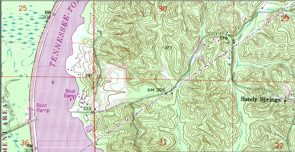

However I'm in the "hillls" of northeast Mississippi and virtually none of my land has extents of "flat" (that's probably why I got so much so cheap). This section of topo is just west of one of my parcels. Lot's of up and down.
If all you have to do is go up and down a few slopes between large expanses of flatland you might get by with 2WD if you make good trails, and carry a good winch. But try and spec out how much you will hav to lift or drag.
