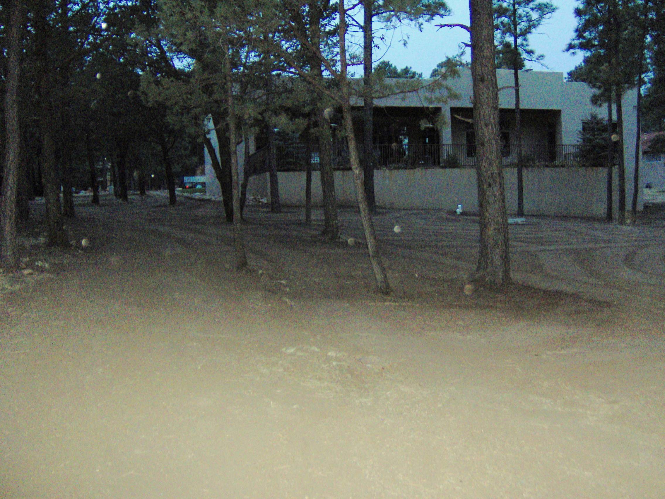

Gary,

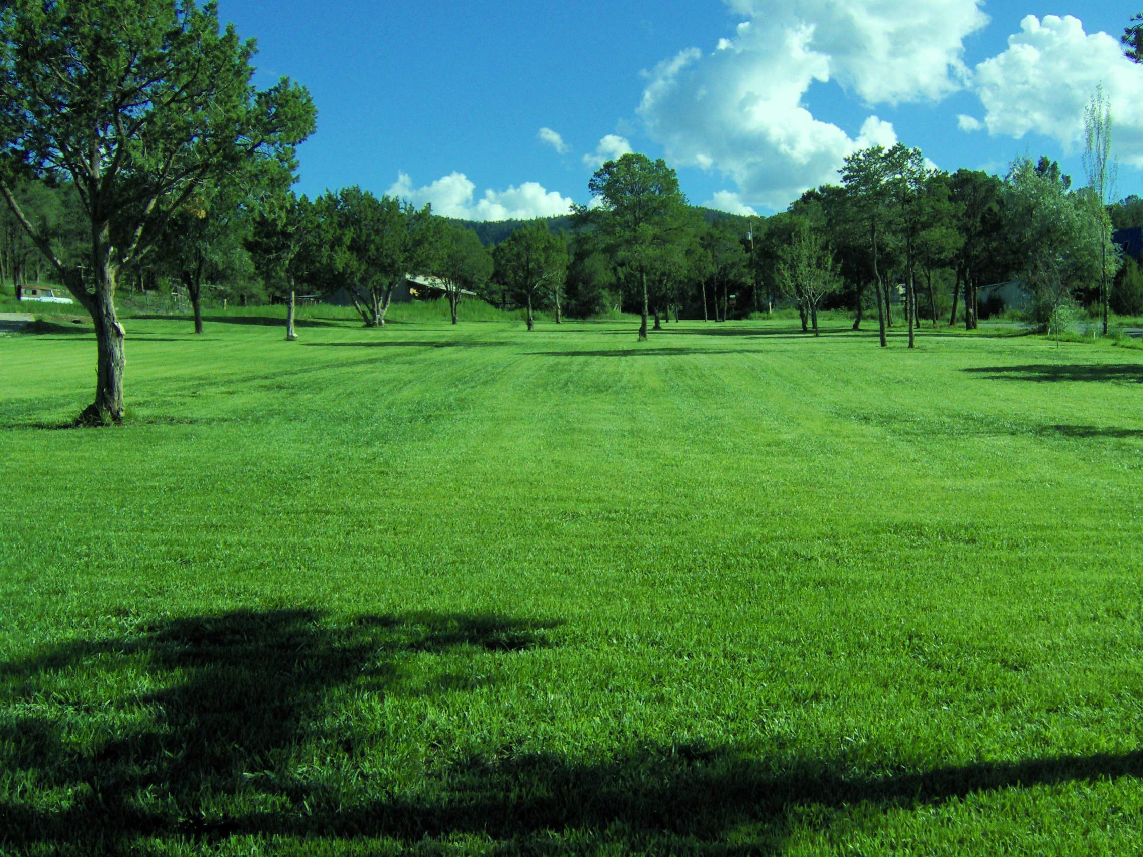

I have had good luck with tillers, no problem with their use for seedbed preparation. My point is that while disks are fine they are better suited to heavy tractors since the big requirement is to have enough draft to utilize them properly. The modern CUT's are light tractors which is suitable for using tillers and at the same time is better for mowing tractors too. When I had 4020's and a Case 1370 I used chisel plows and disks but that is a different world from today's small 1 ton tractors. Using the pto power to get the work and hp to the ground via a tiller just makes sense.
First picture is my rear lawn and the second and third are one of my customers lawns. Tilling seems to work for me.
