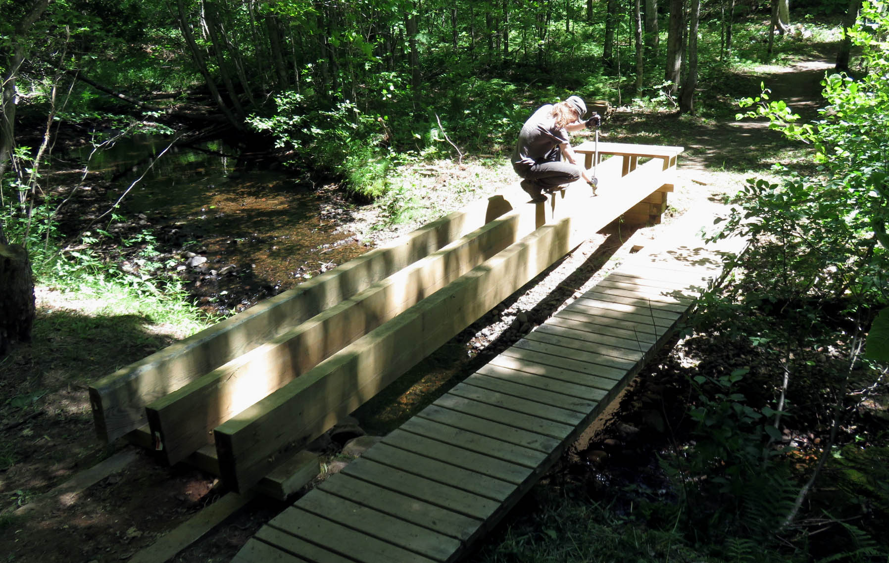

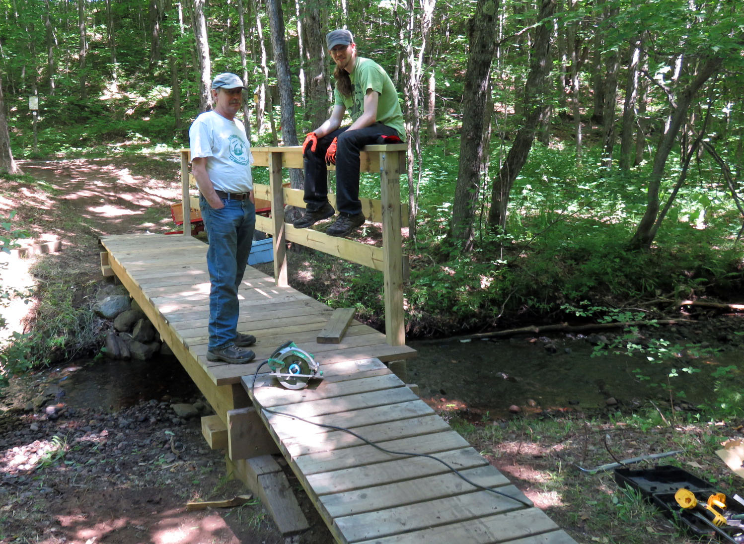

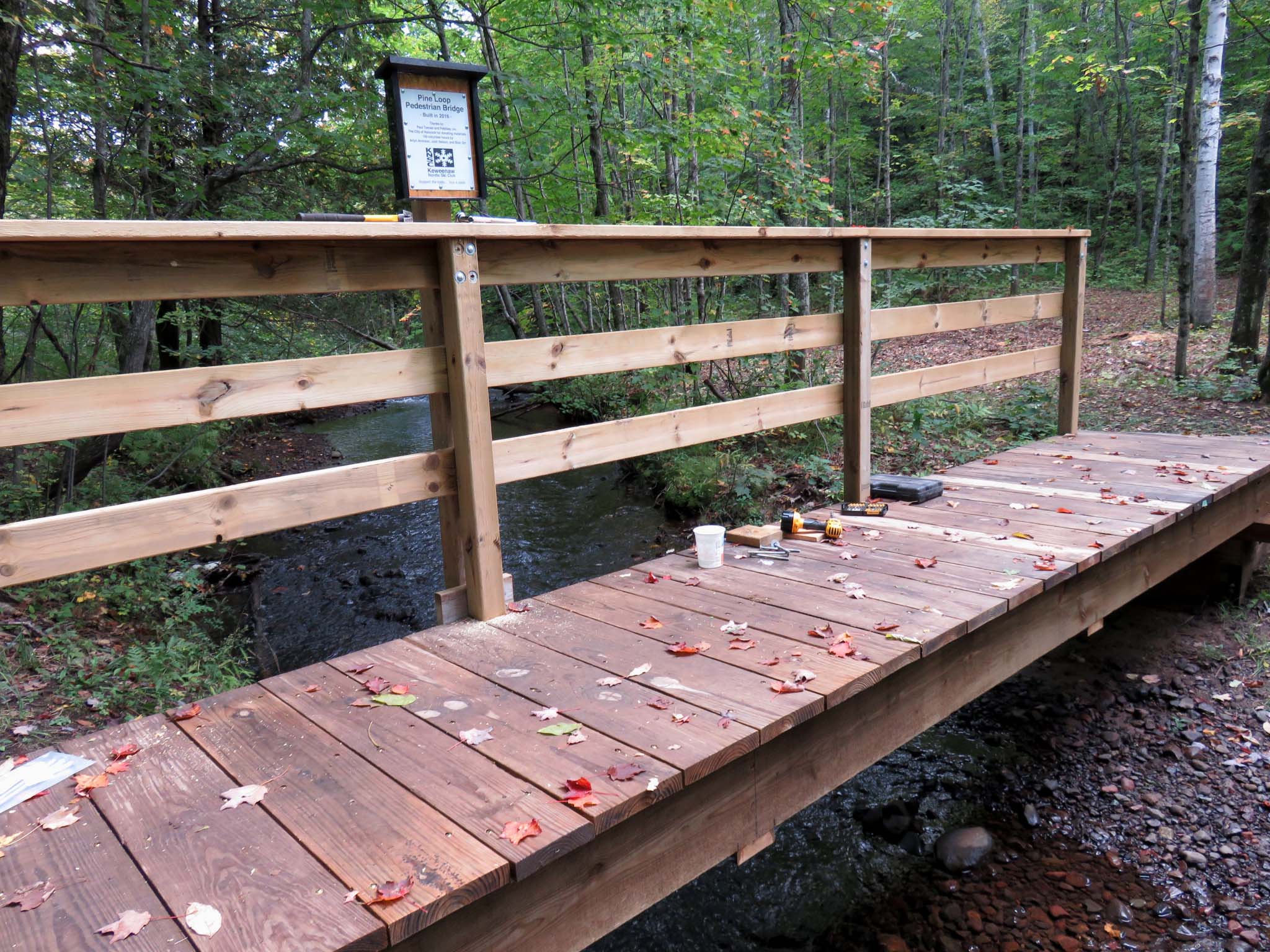

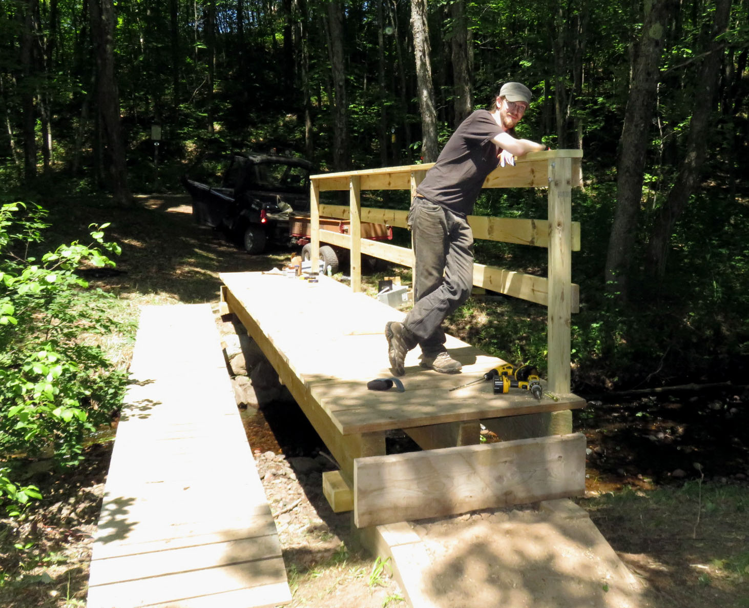

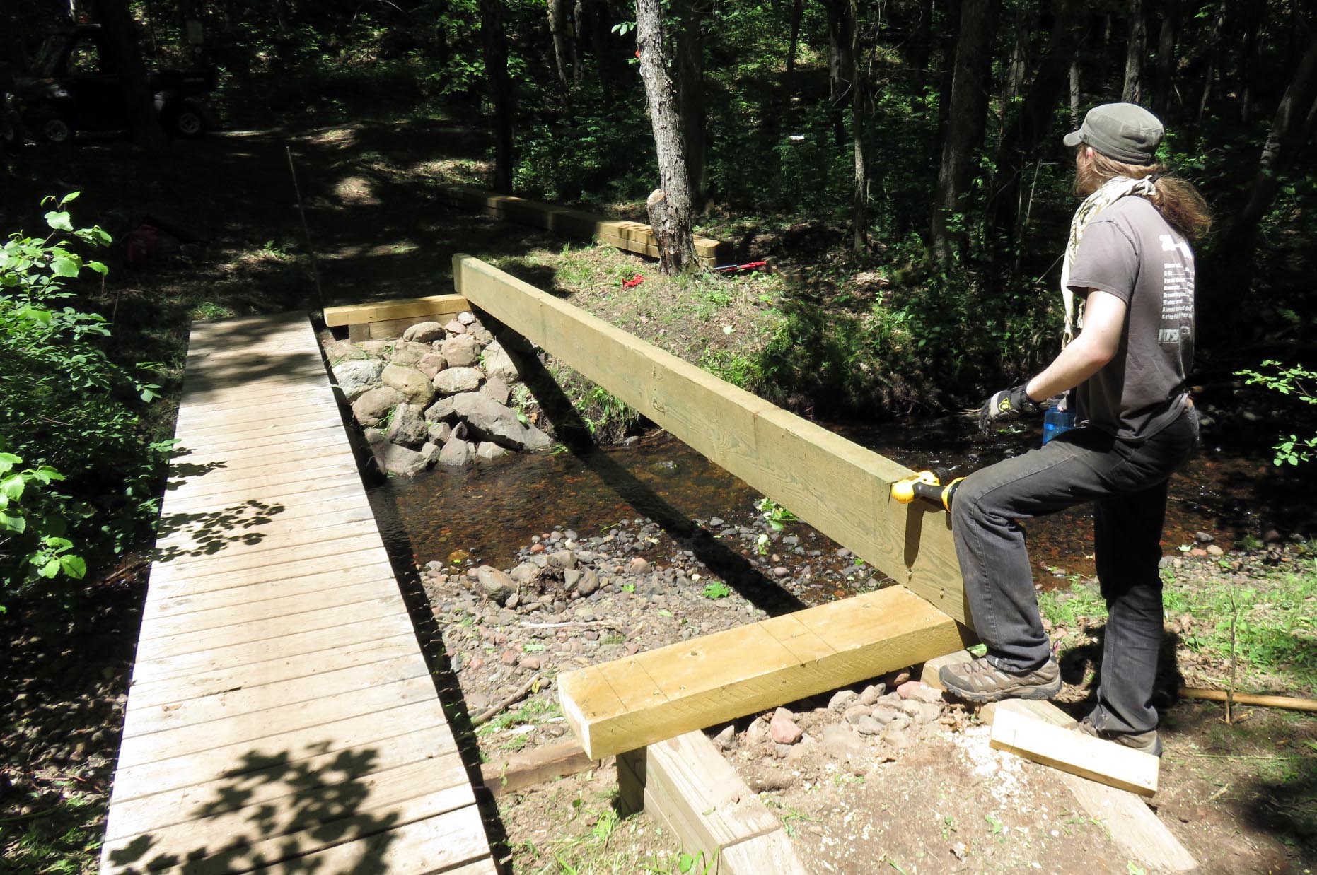

Rod, You on the right track and you have received some good answers. We build and repair bridges on a regular bases but receive snow here so we need to build them for that load. Do you there? Here is the latest one did this past summer that was just under 4ft wide to keep the atv's off it and 22ft long. Its stringers were three 4x12 unplanned treated lumber. All fasteners were structural screws or hot dipped bolts. Hope this give you some ideas.. This structure has no steps.

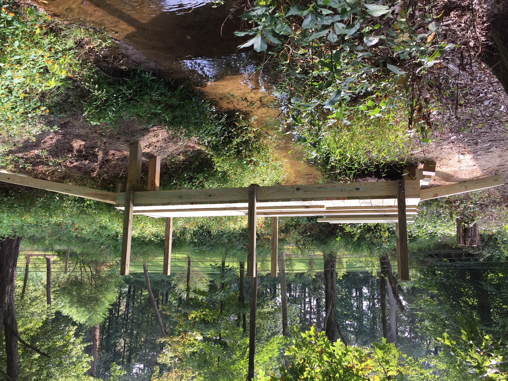

Thanks for all the ideas and advice. I decided to go with 2x8s for the 14 foot span. I used 5 of them for the 4 foot width and it seems solid as a rock. Here's a picture of what I have completed so far:
The thumbnail looks like it's upside down but when I open it the photo is right side up. The boards off either end are for the approach ramps I am making rather than steps. They're not final and are just laying there for measurement etc.

Are you making ramp to get on it? ADA says 1:12 pitch, and every ramp I've built, I've used that slope, and would go any steeper.

I am doing ramps. Thanks for that pitch info! I will definitely use that advice. (I edited my post to mention the ramps just as you were replying)
