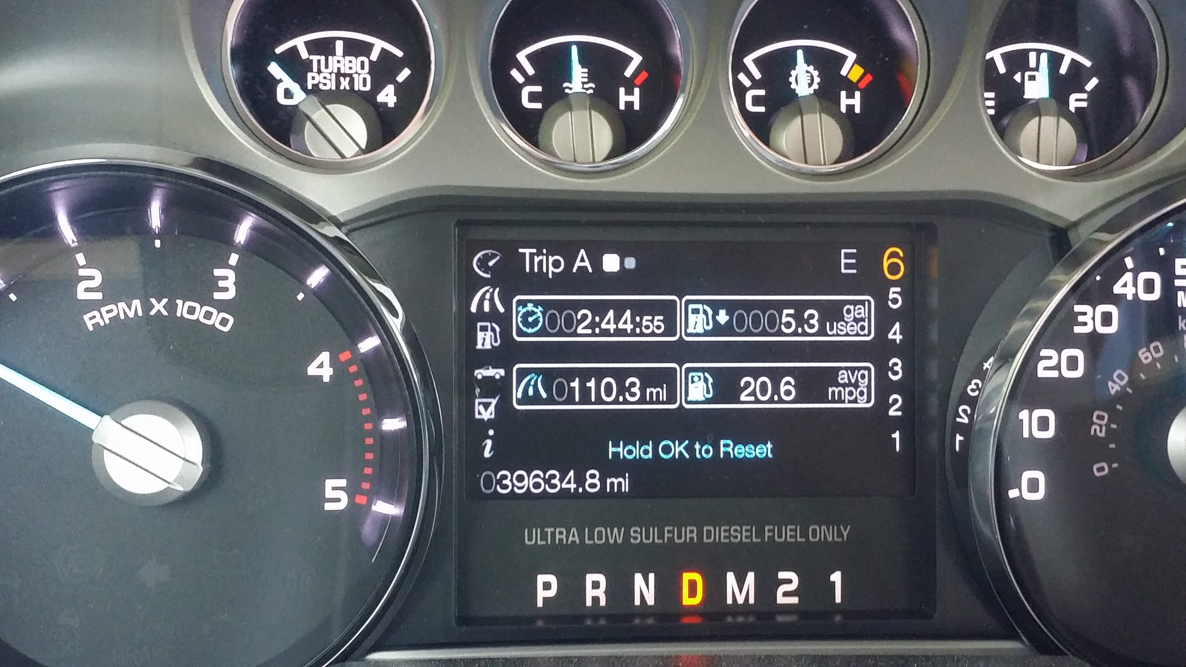

2012 F-350. 6.7 diesel, 38000 miles. Over 95 % of this miles are unloaded/no trailer and my average commute one way is 19 miles with few stops and almost no traffic in the morning since its so early. I've been getting 20-22 mpg for the last 7000 miles. Overall since mile one about 19 which includes about 1500 miles towing.
   / 3/4 ton mpg empty? #116
<img src="http://www.tractorbynet.com/forums/attachment.php?attachmentid=388827"/>
What speed do you drive generally? Would you consider yourself a fuel miser type of driver or just average with no major regard for fuel consumption.
Reason I ask is I'm impressed with your mileage.
My dad had very similar mileage with his '11 F250 6.7L. And he ain't no fuel miser!
