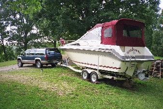

GEP, maybe my assumption or estimate as to what a 24' trailer weighs loaded is too high. I was guessing maybe around 7,000 to 8,0000 lbs. A race car and trailer, I would consider a light and reasonably managable load. I have enclosed a picture of what my rig looked like ready to roll and it was a hand full on hills. I would estimate the load weight to be around 8,500 to 9,000 lbs. maybe more when the gas tank is full. (has a 100 gal. gas tank, 32 gal. of water, 454 Big Block Chevy, plus all the goodies) I can tell you from experience if you plan to pull a load similar to mine; you will burn up the transmission sooner or later.

Hey Chief that Sub most have been straining with that setup. Now wonder you got the diesel PU.
I had been using a Chevy conversion van to pull a couple of horses and the difference now is like night and day. I could never go back to the van. It didn't seem all that bad but now the difference is huge.
The kids do miss the vans TV, video games, bed and all the rest though. We never realy use it for trips anymore, because I like the truck /forums/images/graemlins/smile.gif
