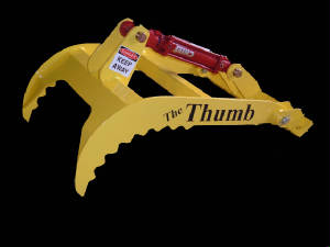

I set out to use the weld on type.
I have one 3/8".
I called my neighborhood industrial fastner supplier and the didn't carry them in the store.
TSC,ACE,LOWES,HD - none of them carried weld-on
So I had these sitting around.
I actually liked the fact the slot for chain is slightly higher off the surface.
I am pondering turning the bucket upside down and reinforcing the bottom side of the top with some plate steel.
I read a thred on the " Thumb Grapple" there is no pipe cross support.
I might build one like this.
