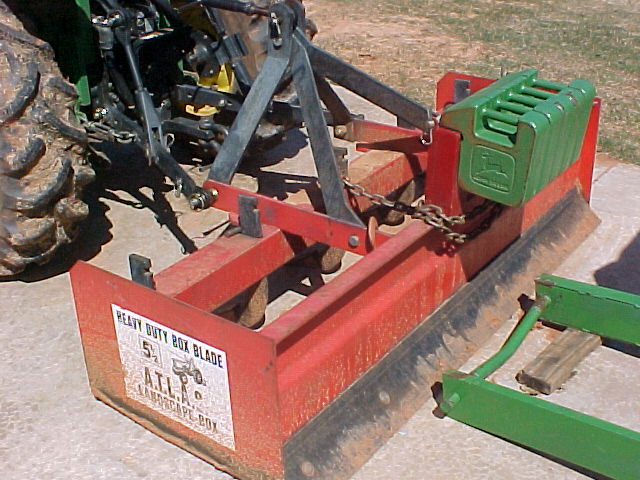

Lots of folks use a box blade or other heavy implement. You might justify a heavier boxblade which also works better than a light one. You can add weight to the boxblade, too.

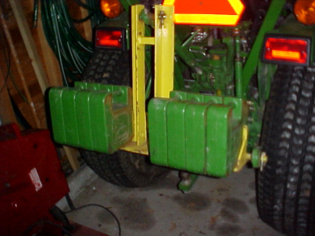

I have a bracket that holds suitcase weights built by the prvious owner of my tractor, Thought I would post a picture
in case you might want a peek. This is my picture downloaded hope it works,

Thanks ! That's a pretty slick set up ! John

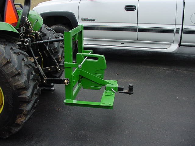

My daughters boyfriend made this weight braket & hitch for me out of a carry all frame. It will hold 8 100lb weights.
Chris

Tsc had those carriers on sale last week for $68.00.

Chris, Nice job ! I can't weld . So if I attempted something like that it wouldn't hold itself together ,let alone 800 pounds /forums/images/graemlins/smile.gif
