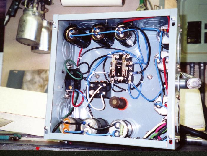

I too built my own rotary phase converter. It’s great because you find used industrial equipment like your welder, mills, lathes etc. that are great bargains because they are older 3 phase units. My converter is a 5hp unit and cost me about $80 to build with some parts scrounging. The output balance is within 5% between the phases from no load to full load. Works great.

Running 3 phase equipment from single phase power happens all the time. You can do it several ways, depending on your needs for balanced power legs.
Static converters are the cheapest, rotary converters are what most people use, adding capacitors to balance the legs makes them better, and then you have the ultimate, which is "Phase Perfect" which are a little pricey, but do the job everyone wants, the way it should be. If your running 3 phase CNC equipment on single phase power, then that is the best way to go.
