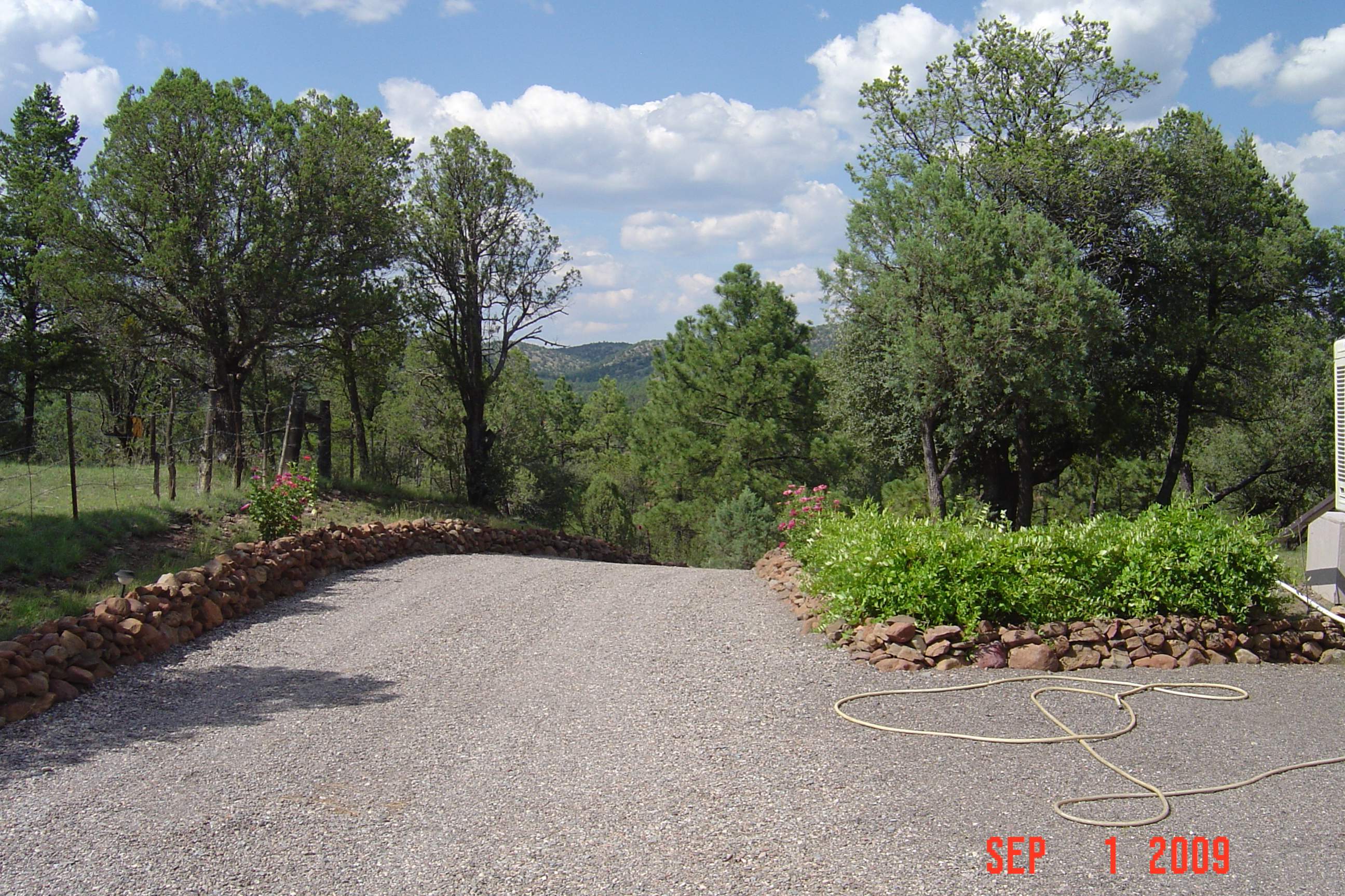

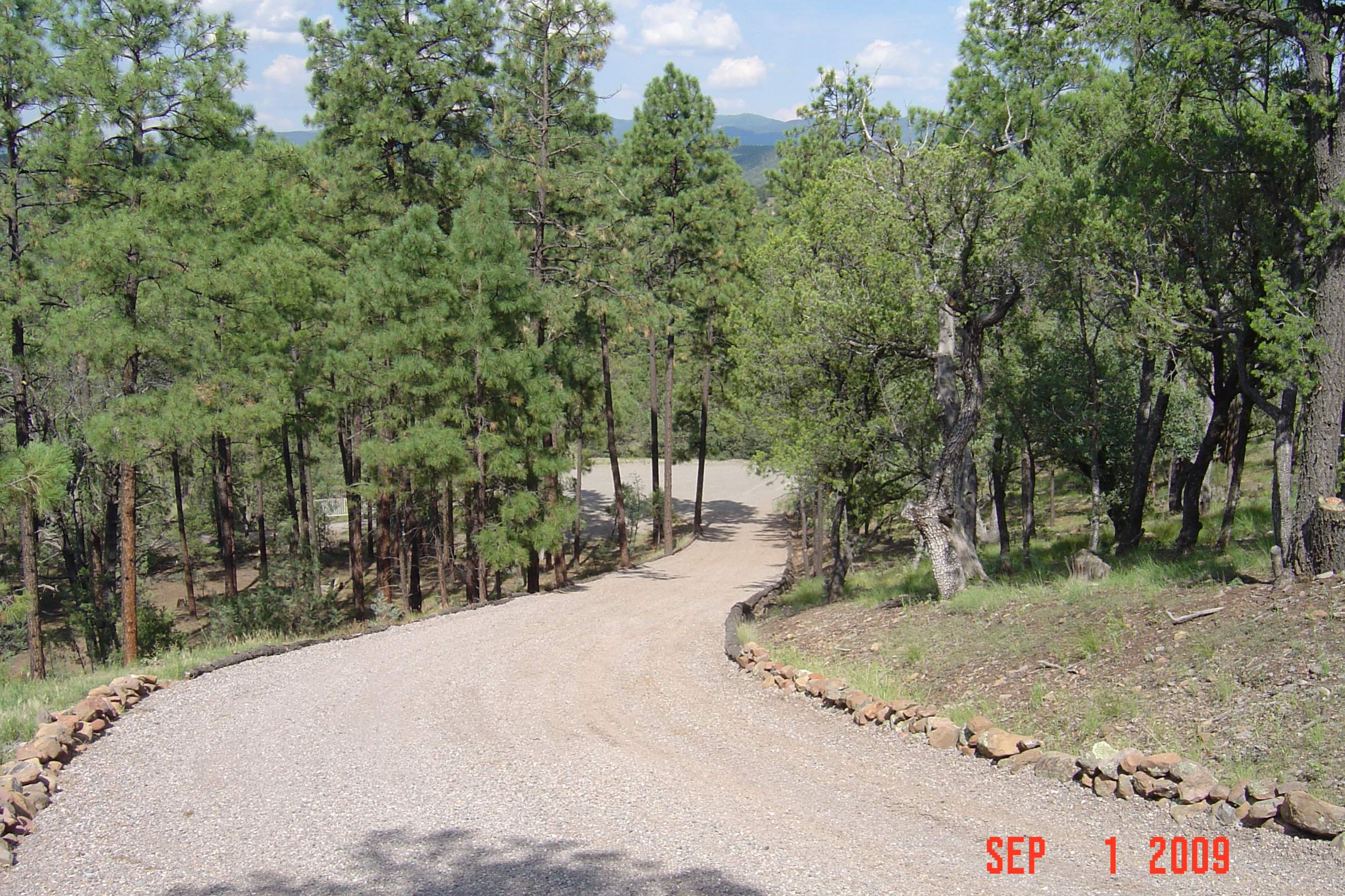

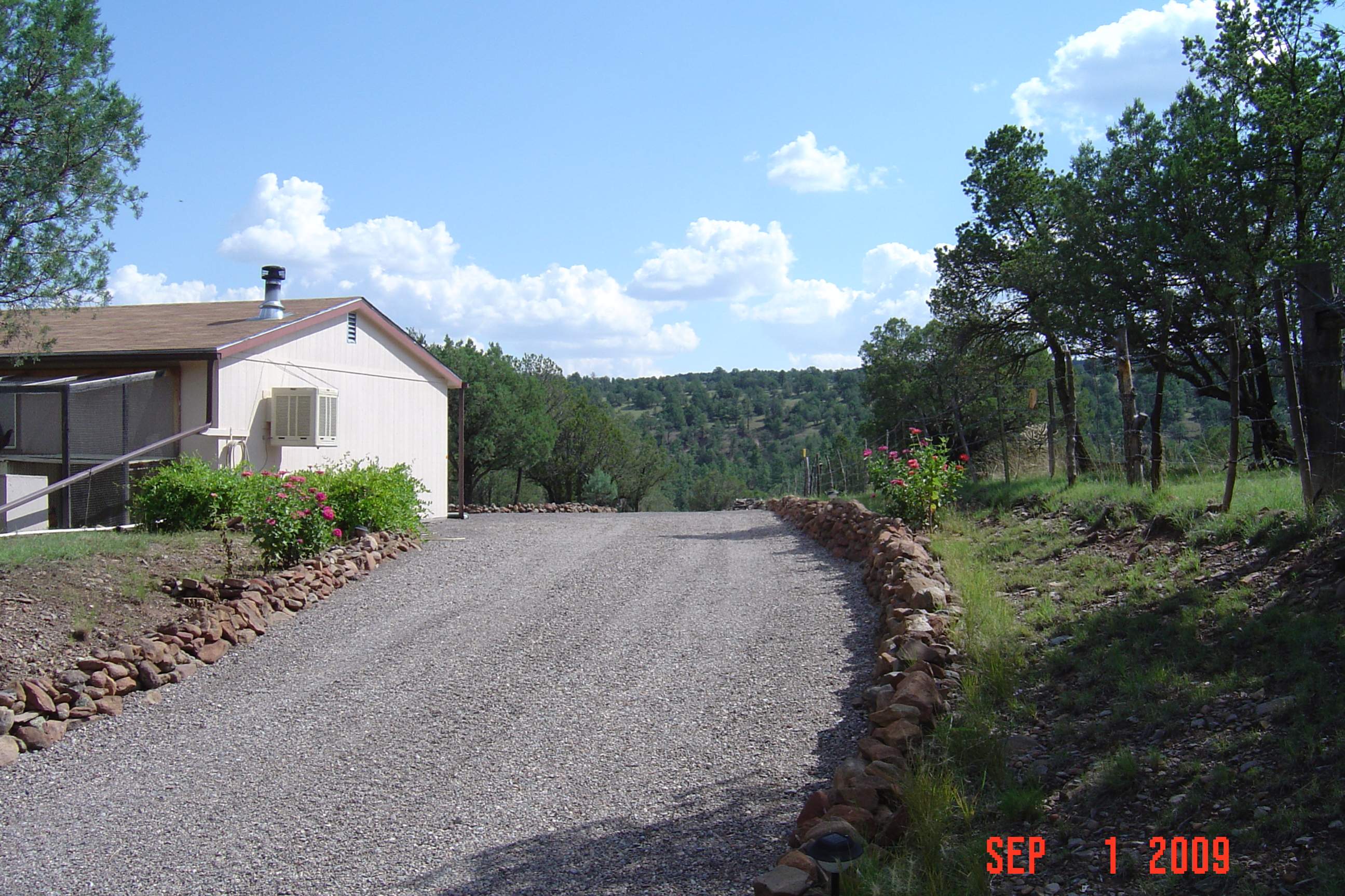

My manual does not mention draft control but based on my experience with my old 8N and another unit I believe it's there. I have limit stops for both up and down on the 3PT lever control also. It does work smooth and the control is ok, just not what I would like when considering soft ground/gravel. That's what prompted my query. I would like more finite control considering the terrain I work in. Attached are shots of the upper level of my driveway.

Unfortunately we did just that with the stones, placed by hand after hauling in a trailer behind the ATV. There is several hundred feet not shown also, all from our "mountain". No fancy mortared walls here, left it as natural as possible. Glad you like it, just need to rework the place now after the last snow removal, but expect 6-8 inches tonight.

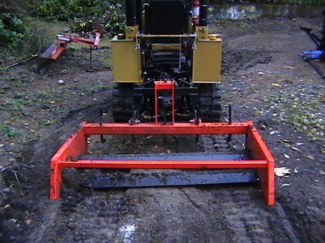

I borrowed a scraper blade but was not really happy with the results and my lack of finite control over the hydraulics. Purchased a landscape rake which works fairly well scraping and moving dirt - same lack of control. I stumbled across Everything Attachments video demonstrating a land plane. I traded a tool bar with middle busters for a 5' land plane and have not looked back since.
I am adding a hyd top link as I have discovered that adjusting the top link can control the amount of bite the front blade has. I can go from cutting 3/4 inch to just skimming the top of the material which allows the rear blade to just smooth.
Have received great reviews for leveling back yards and grading just prior to laying sod. I had the dealer install the hyd remote and purchased a top link from Fit Rite. The top link has not arrived ... maybe it will be here in time for Christmas. :)

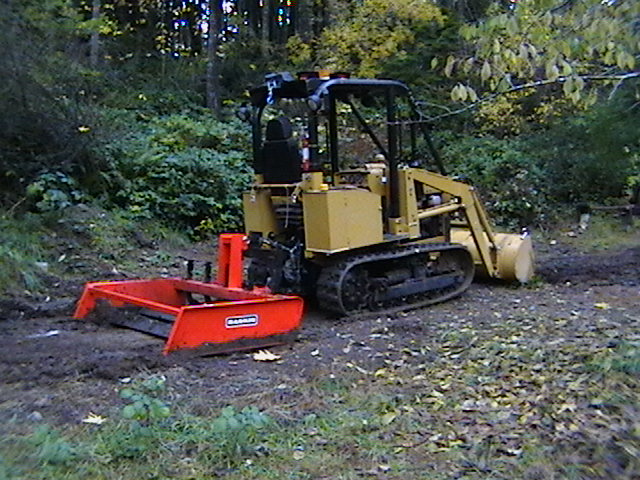

Forgot to mention that I too have a grader-scraper, a Rankin. Since these pics were taken, I have added a hydraulic top link. Makes the grader-scraper even better when I thought that would be impossible.

Gramps, you sure did a fine job on that driveway.

Gramps, beautiful drive! I can see why you want to be careful and not tear it up too much. Can't find the post , but others have added adjustable/removable wheels similar to skid shoes to the back off the blade. It could roll behind you without worrying about adjusting the height perfectly. You could have your 3pt all the way down 'floating' on the wheels similar to a 3pt mower.
