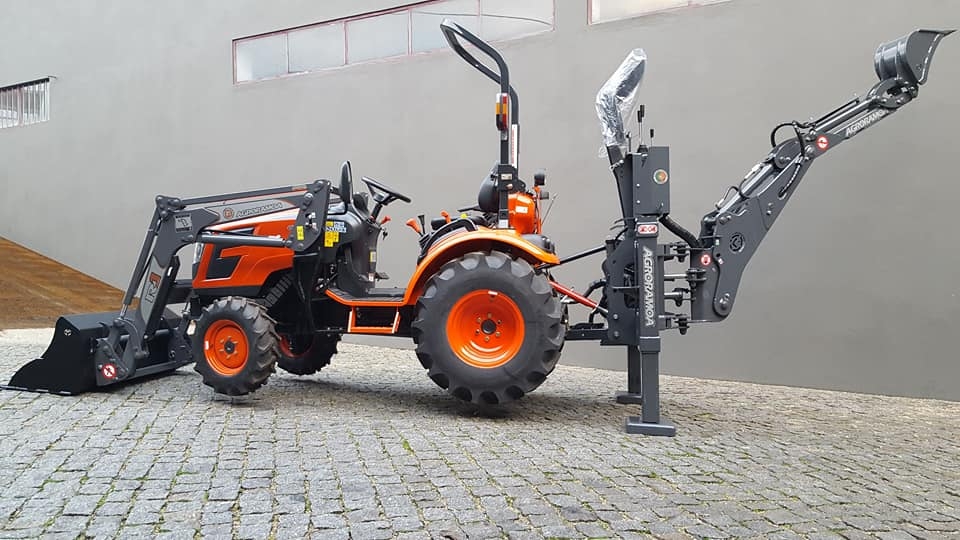

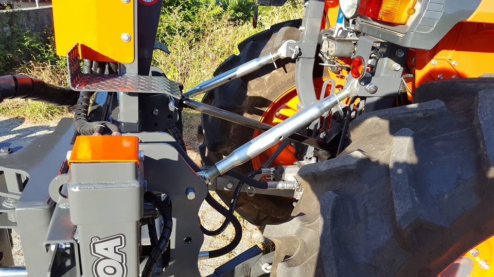

Sub frame mounted backhoes don't really exist on this side of the pond but 3 point backhoes are fairly popular.
However, they typically add 2 extra links attached to a solid point on the tractor to spread more of the forces so it's not all concentrated on the top link mount of the tractor. It also adds stability to the backhoe. Just like this:
View attachment 4506737 View attachment 4506738
The ones sold here also have side-shift which is honestly a must.
That is what's really needed for the 3pt hoes is the double brackets instead of just the top link connection.
If I had a choice I would definitely get the frame mounted one. It would just be so much easier to mount and dismount and one less thing to worry about.
