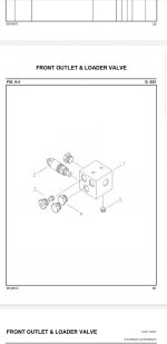

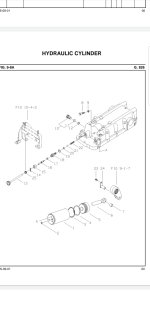

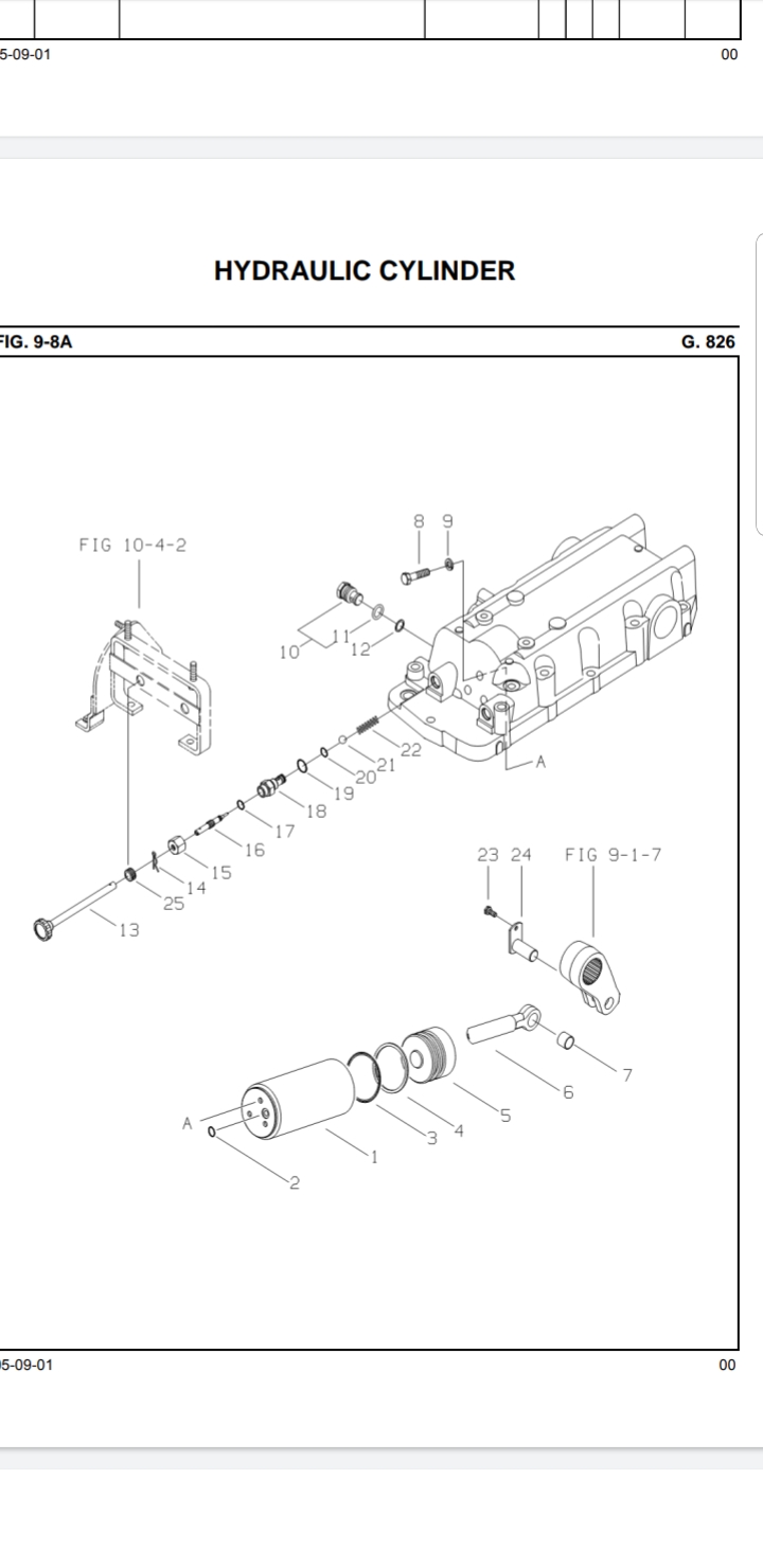

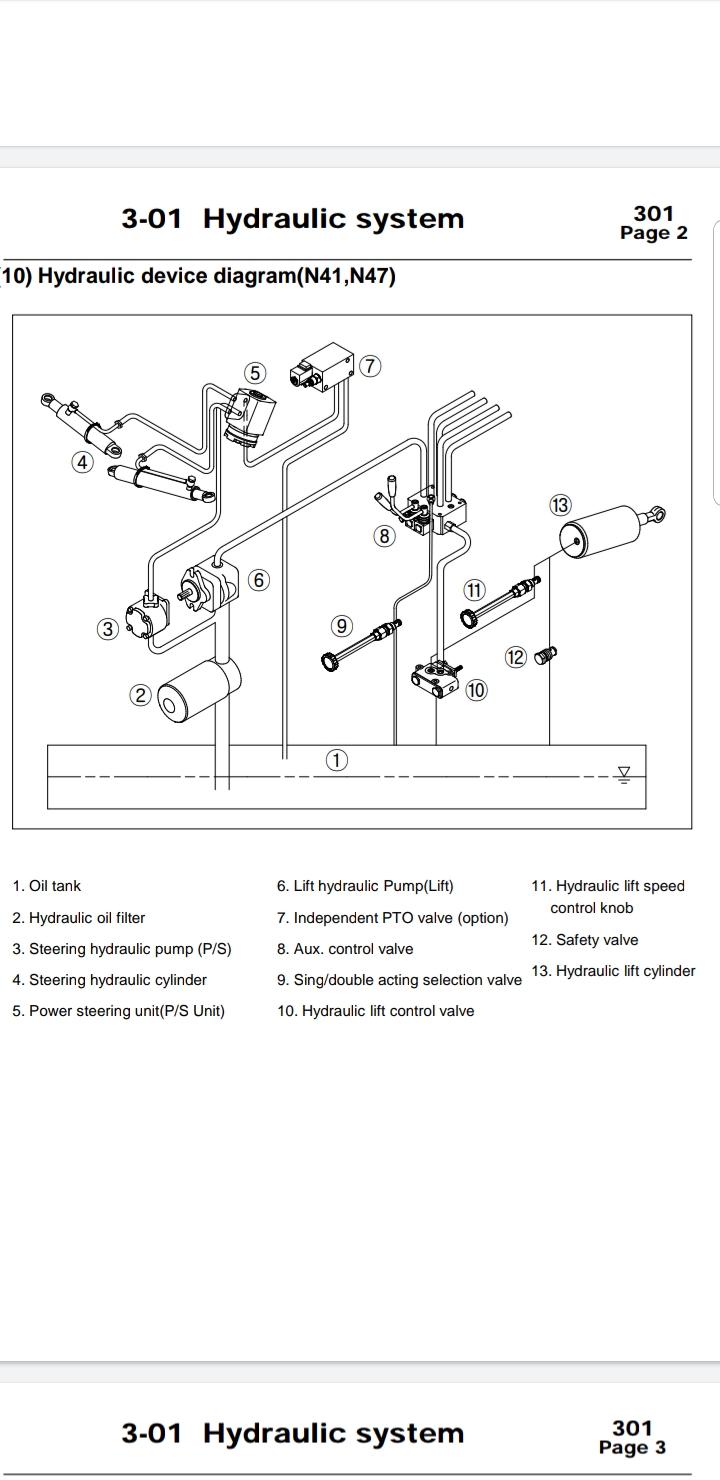

I would post the PDF but the site will not let me.
/ 3 point and remote weak
#26
Screenshot_20191120-151011_Drive.jpgScreenshot_20191120-150933_Drive.jpgScreenshot_20191120-150941_Drive.jpgScreenshot_20191120-150950_Drive.jpgScreenshot_20191120-150958_Drive.jpgScreenshot_20191120-151005_Drive.jpg
#27
Screenshot_20191120-151020_Drive.jpgScreenshot_20191120-151028_Drive.jpgScreenshot_20191120-151033_Drive.jpgScreenshot_20191120-151039_Drive.jpgScreenshot_20191120-151046_Drive.jpgScreenshot_20191120-151052_Drive.jpg
#28
Of course it didn't post them in order but this is the entirety of the "service" manual from the factory. For the hydraulic system
#29
I am not trying to be a smart butt to you Jim,. It was towards LS and thier so called service manual. It is 230 pages from cover to cover and the 12 pages I posted is the whole hydraulic section. Which is not very helpful.
