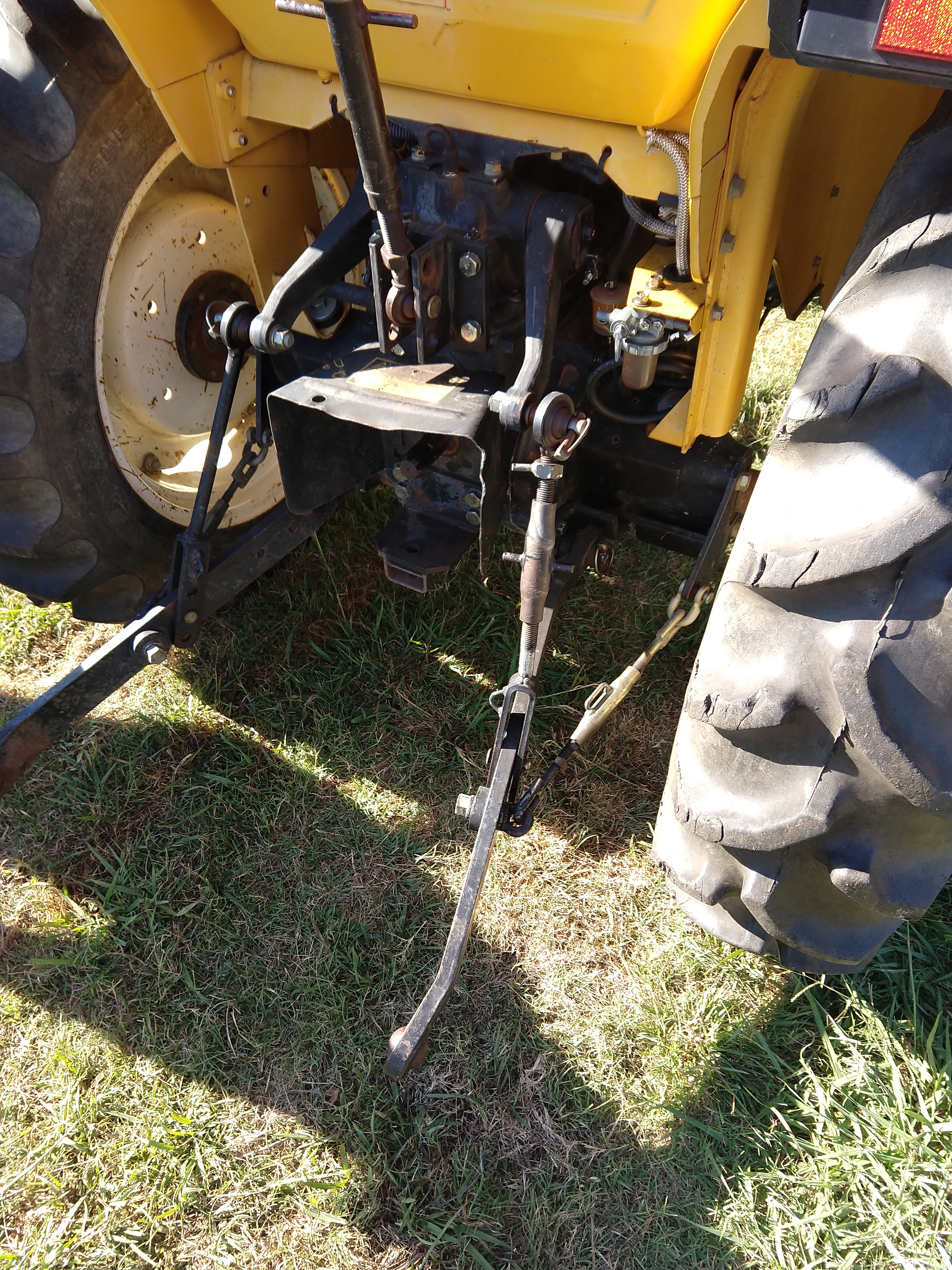

While cutting up the soil & removing it to put in a chicken coop with cement foundation..... the twin curled blade type tiller (don't remember the correct name for this old school tool) was cutting great. raise and lower wonderfully every time.... then all of a sudden, it wouldn't lift. I backed up the tractor thinking maybe its caught on a very big stone; then pulled the handle to full up and still no reaction at all. So, I disconnected the twin blade from the 3 point and spun around to use the bucket to move the twin blade out of the way.
Tried to cycle the engine to see if maybe the line had a pressure inducing clog on the 3 point internal stuff (my brain assuming this logical 1st thought). Still no response to the up & down of the control handle for the 3 point. Yet, the FEL still worked just fine.
Took lunch break and came in to research in forum and look at the pdf's i'd found here and online for the tractor..... didn't see anything the same. saw several stories of snow-bound issues based mostly on fluid dynamics.... Saw at least 2 on something about a internal pin and an allen head bolt(?) that a service tech didn't charge for the re-tear down to fix from the 1st go round....
So This evening about 8PM I went out to test the system...

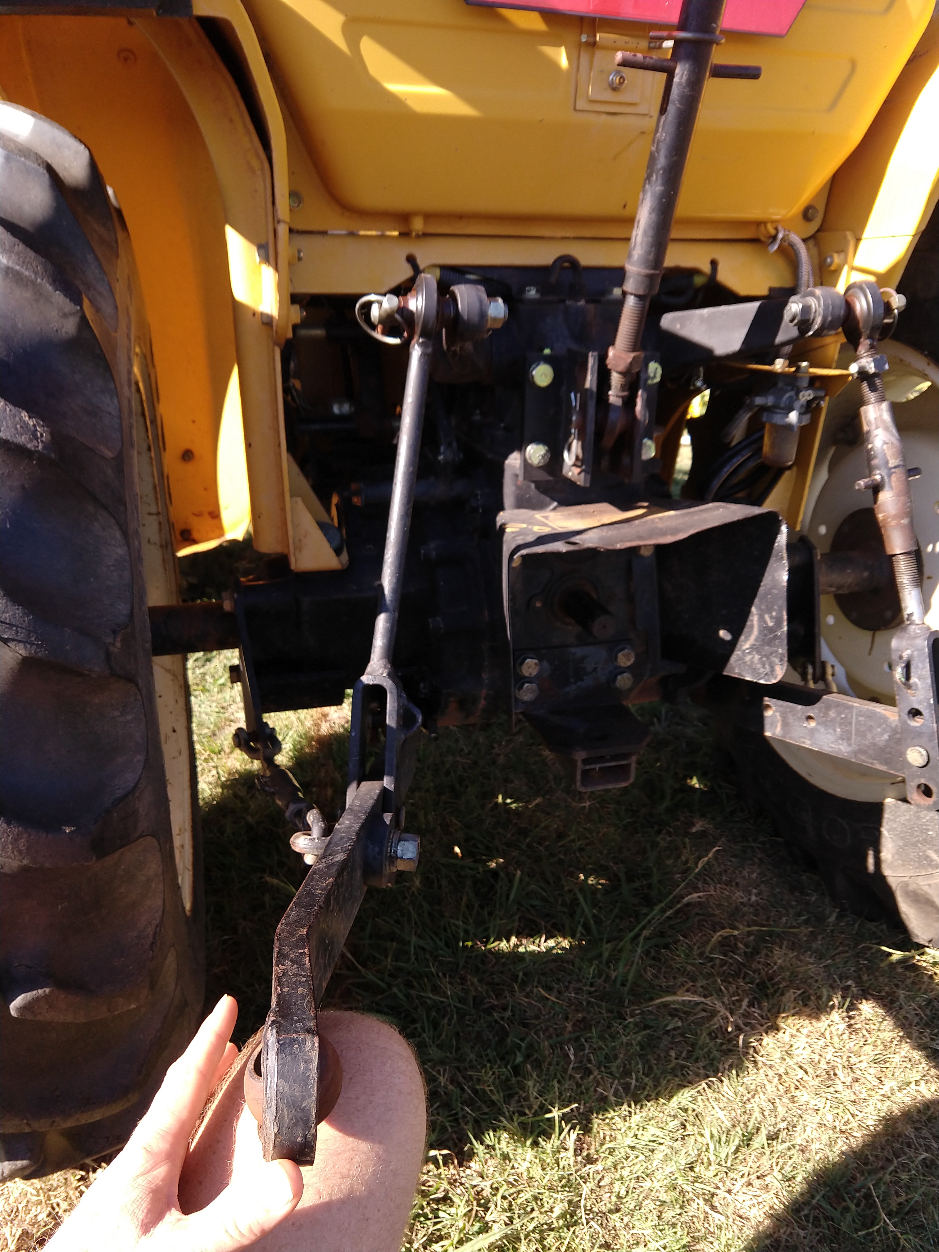

FEL worked fine. 3 point still no response to control handle at all. So last thing to do was test to see if I could manually move the lower 3 point arms....
piece of cake! they lifted and lowered in my hands like the top link. yes they are heavy steel but, there was no detectable resistance (hydraulic or mechanical) to moving them (by hand) with the engine off and the control arm in either full up or full down position.
I thought of making a short (under 15 sec video) of this manual test but, don't think that's the best use of bandwidth out here in DSL-land. I could upload a couple pics tomorrow if that would help?

CUTs with rockshaft 3PH lift do not provide down-pressure, so it's perfectly normal for draft arms to 'float' or to easily be lifted by hand. A red herring this time, I'm sure.
"Lifts unloaded but weak overall" can sometimes be a blown seal/ring in a rock-shaft piston. (BTDT) I second that this time something has likely fouled the 3PH control valve somehow.

Update....i hope i can upload these pics w/out error. We're out in DSL-land with a whopping 3.5Meg download speed and .75Meg upload speed.
So to give data to pics here in case the upload is not completely successful.
picture 1: the 3 point in its current full down (dead) position
picture 2: my hand holding 3 point in nearly full up position (or full up) was difficult taking pic simultaneously & balancing it with my bad knee (smirks)

Have you checked your fluid level?
If you have any other remotes, check their position. If open 3pt will not function.
Do you have a 3pt control valve with handle that you adjust the rate of drop with (also locks 3pt at a specific height). If this is closed 3pt will not function.
Good luck
   / 3 point arms won't respond to control arm spontaniously today #10
Unless I missed it the OP did not say if they had checked the nut on the 3ph lever to make sure it is actually moving the internal rod and it's not just slipping...?
