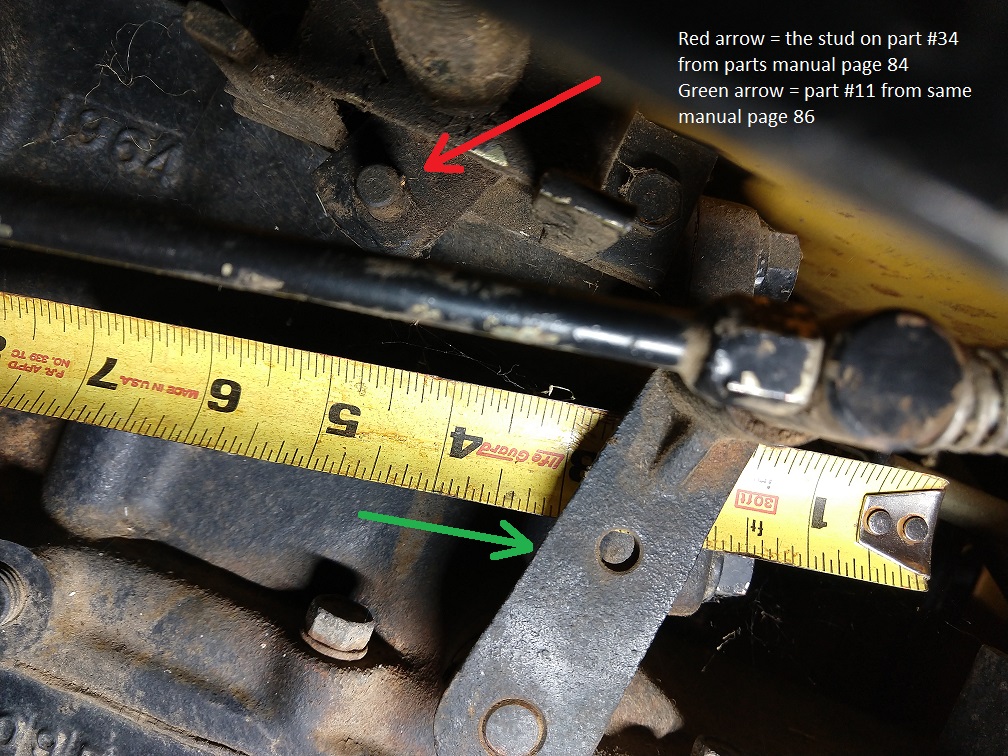

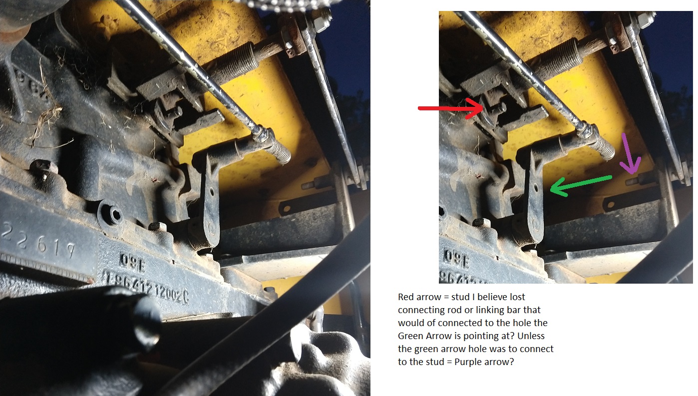

So, yes. part of my situation was this rotating knob centered below the seat but, the weird part is this ---I'm gonna punt with this guess,"missing connecting bar?"
I took pictures and for over 3 hrs last night phone & PC didn't play well together for me.... USB connection 'times out' or drops the ball entirely.... so today I'll try to upload the pics tonight ermm, this AM [this post failed to send 2 times around 1:30AM so now its 8:27AM & I'll try again] I'm gonna try to explain where its at. on one of the pdf's that was filled with parts diagrams, i believe it was page 82's diagram of parts for the 3-PT control arm and the part #34 is this "arm" with a tab that has a ~3/4" long stud parallel to the main shaft that connects to the linkage which connects to the base of the 3-PT control arm you use to raise and lower the 3-Point.
there is a different arm that has a small shaft that has a 2.5" long spring at the top of it against this arm that goes all the way to the lifting 3-PT arm under the fuel tank.
there is a obvious machined hole in the middle of this arm that shows signs of a pin/shaft residing in the hole & back over on this part #34 the 3/4" stud also shows the same signs of wear....
What made me choose this idea? with the engine idling I pushed against the different arms and the lifting arms sprang to life & started to raise the lower arms like nothing was wrong. As soon as I stopped pushing on that arm (not the #34 arm) the 3-Pt assembly started to drop.... so I found the under seat knob/dial you mention and start fiddling with it....while testing the all the other moving parts and bam, the arms started to raise and stayed put....

That extra arm should be the 'position feedback linkage'. Reset is a few steps, in order, to restore function. If it's out of whack, another prob is for the hitch to try to raise all the way and try to keep going.
Such happened to me once. I'd reinstalled a rock-shaft arm one spline 'off' but didn't readjust 'feedback'. When I raised all the way I could hear the system go into bypass as it 'topped out'. Patch was to leave the setting a tad lower until I fixed it.

first thing i did was removed the cover plate next to seat to give me seated access to the linkage rods and stuff
'position feedback linkage' ? there is a rod ~1/4" dia. with a couple of washers holding a compressed spring, ~2.5" long on the end thru a hole in top of the "Arm" I pushed to the rear to get the 3-PT arms to raise magically. I did a test with 3-PT finish mower for about 30 minutes of mowing and cycling 3-PT arms.

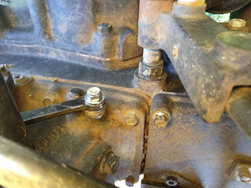

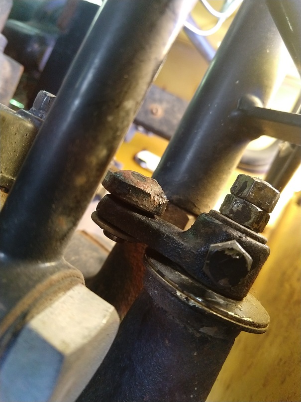

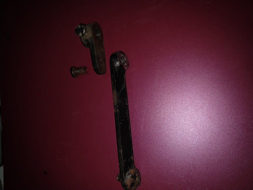

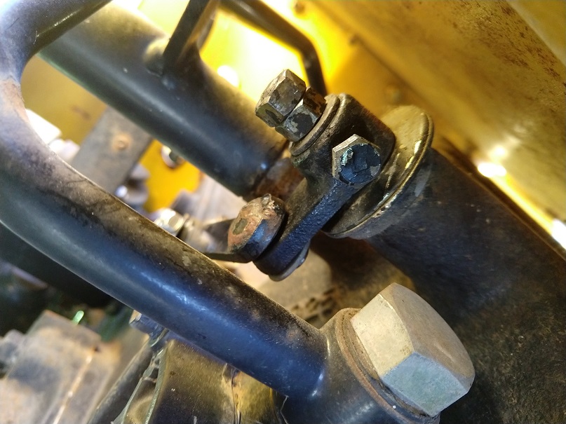

it was a connecting arm. exterior on the other side of the seat.
I repaired by drilling out the broken parts "factory weld", filing it down & replacing the broken pin with SS 5/16" bolt, nut, washers & a dab of green lock-tite "just in case."
On the other side I also replaced the 1/4" bolt haphazardly installed with another SS 5/16" bolt, nut, washers, & a dab too.
Still have a nice smooth control lever action that stays put where ever I stop movement & I tested with engine running: 3-PT Instantly came to life. I also checked the adjustment of the knob under the center of the seat too.

so, here are those pictures, with a bit of notation here too.
previous picture i posted of "page 84 or parts manual" has parts #18, 25, 26 & 27. you will notice in tha couple of pictures here that the 'dogbone' section of #25 is flipped to have the "C clip" now on the piece with #26. Reason was simple. keep the 2 parts of #25 together before trying to instal "C-clip" in very tight quarters. This also made for making sure the SS bolt, nut & washer where easily and nicely snugged down with 'at least' some whiggle room.left-side-of-seat-3.jpgleft-side-of-seat-2.jpgleft-side-of-seat fixed.jpgright-side-of-seat fixed.jpgdogbone-prepped.jpg
Edited from Thursday night..... Forgot to ad this picture. showing the dog bone shaped part with the lousy factory weld that held a pin in place-sorta & finally gave up.
