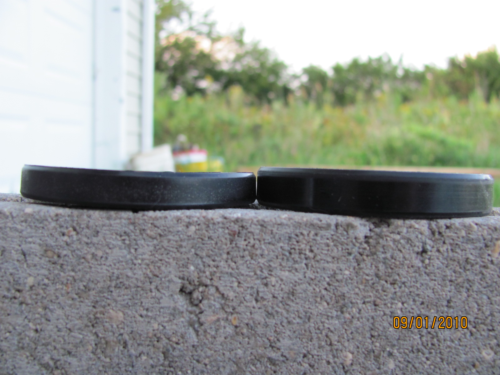

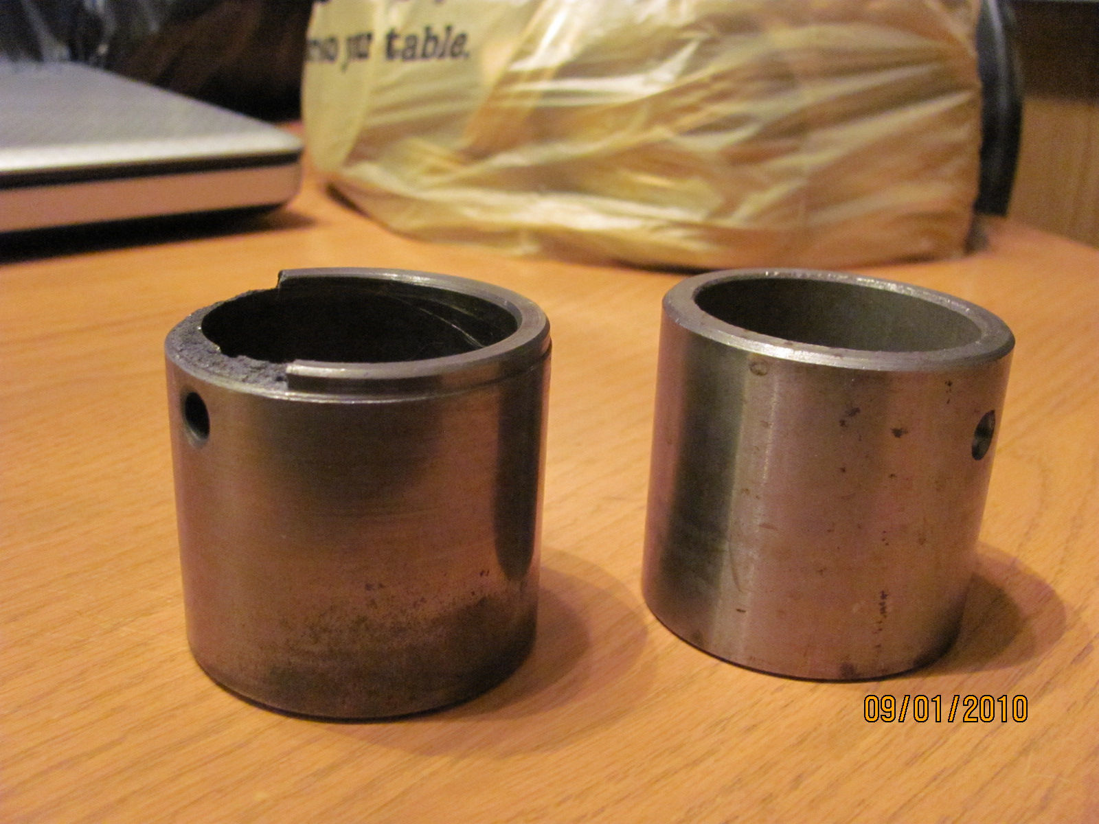

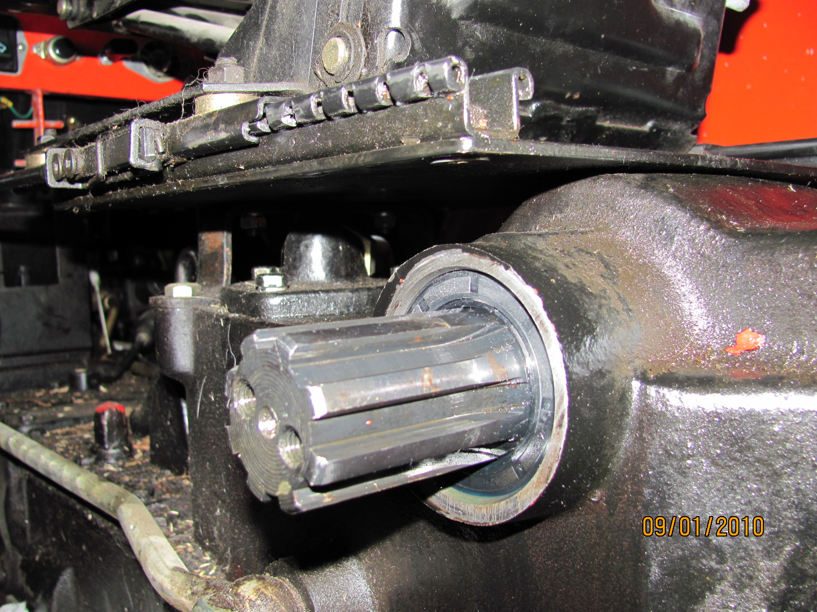

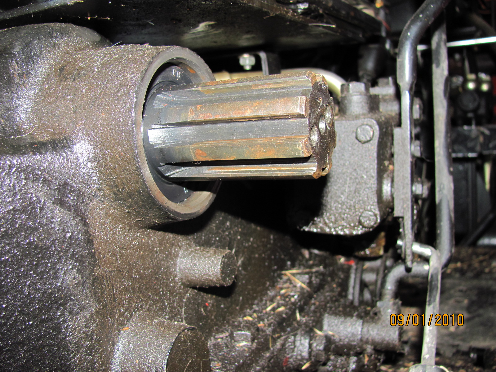

When I put fluid back in the tractor it was leaking. I drained it and when I took the back cover off the bushing was loose. The photo shows the bushing was bad. I replaced the bushing, oil leaf and oil seal. Filled it back up with hydraulic oil and it sat for 2 days and didn't leak. When mowing I was using the 3 point and the next day still no leak. The next time I mowed the next morning there was hydraulic oil on the floor and it was leaking a lot. I don't know if the outer side of the seal is to keep debri out or to help keep the oil in. The seal that was in there originially was a 60 42 8 and the seal I replaced it with is a 60 42 10. You can see the difference in the oil seals in the 2 pictures. The outer lip of the 60 42 10 seal doesn't cover the splines on the shaft but I don't know if that would cause a problem. I used locktite on the set screws.

That's curious. My book shows the seal to be 42x62x10
//greg//
/ 3 Point bushings
My mistake measurements are 42x62x8 and 42x62x10. My book says 42x62x10.
