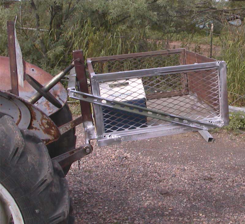

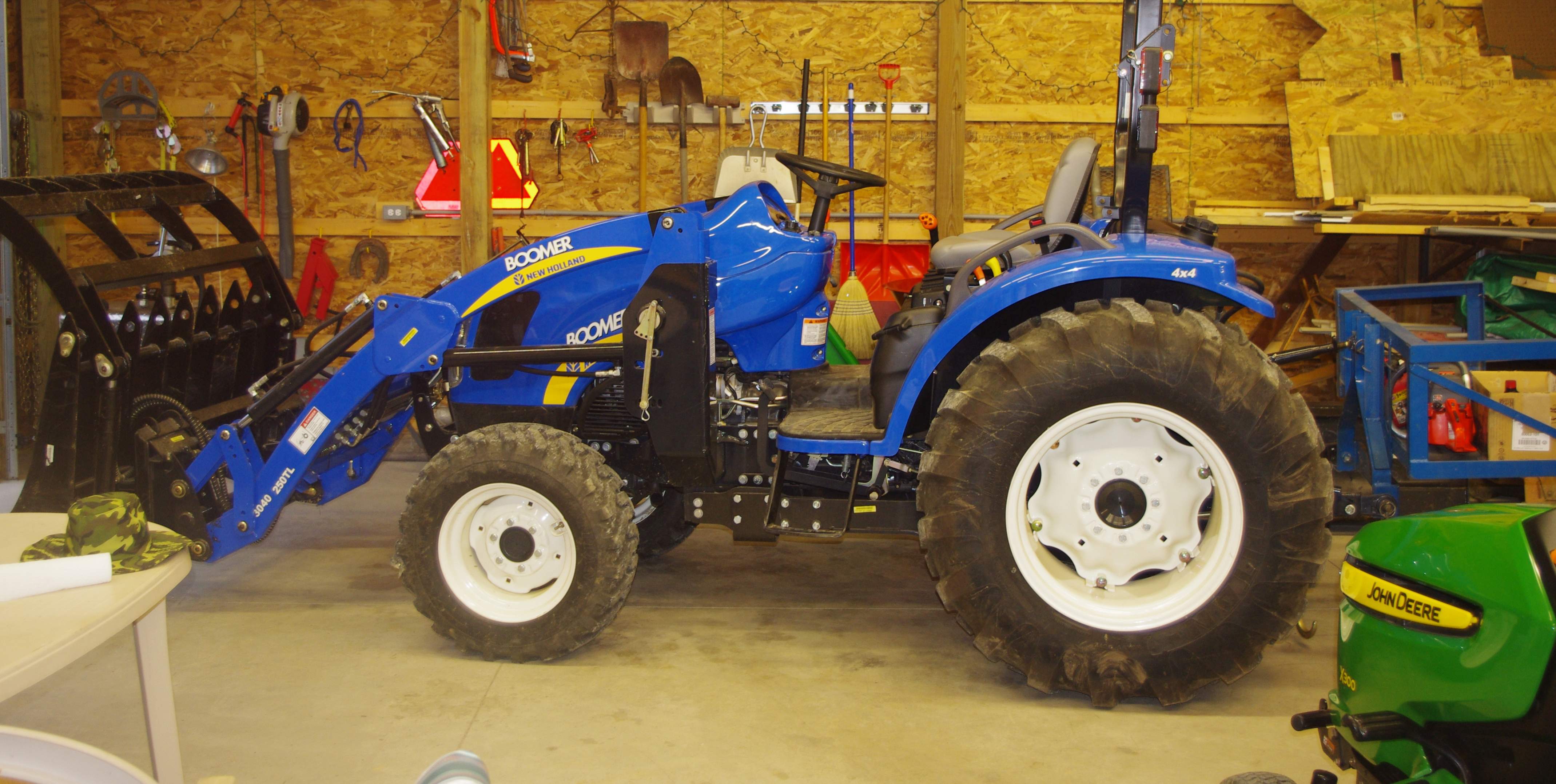

I opted to build vs buy. Using 2" x 2" x 1/4" angle iron and treated plywood for the bottom, it ended up heavier than I probably needed, but it works well and you could put 750 lbs on it if need be.
I had a 3 point hitch weight bar that I use in the winter for snow plowing and decided to use it as a platform mount. My carry all is large enough for a chain saw, tools, fuel, bar oil, log chains etc. Bungee cords strap it all on.
It has a single pin mount on the Top Link and steel pads that rest on the tapered arms of the weight bar. The result is that I can carry weights on the weight bar and have the carry on at the same time. Having the extra suitcase weights + the weight of the "carry all" really helps keep the rear tires on the ground when grappling logs.

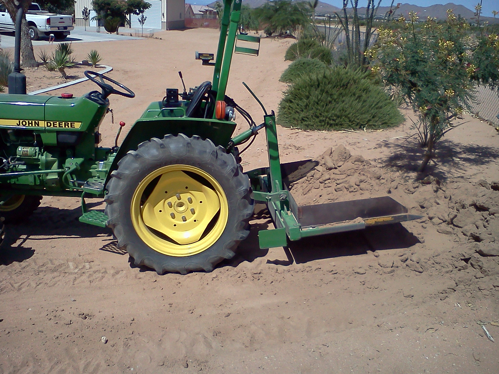

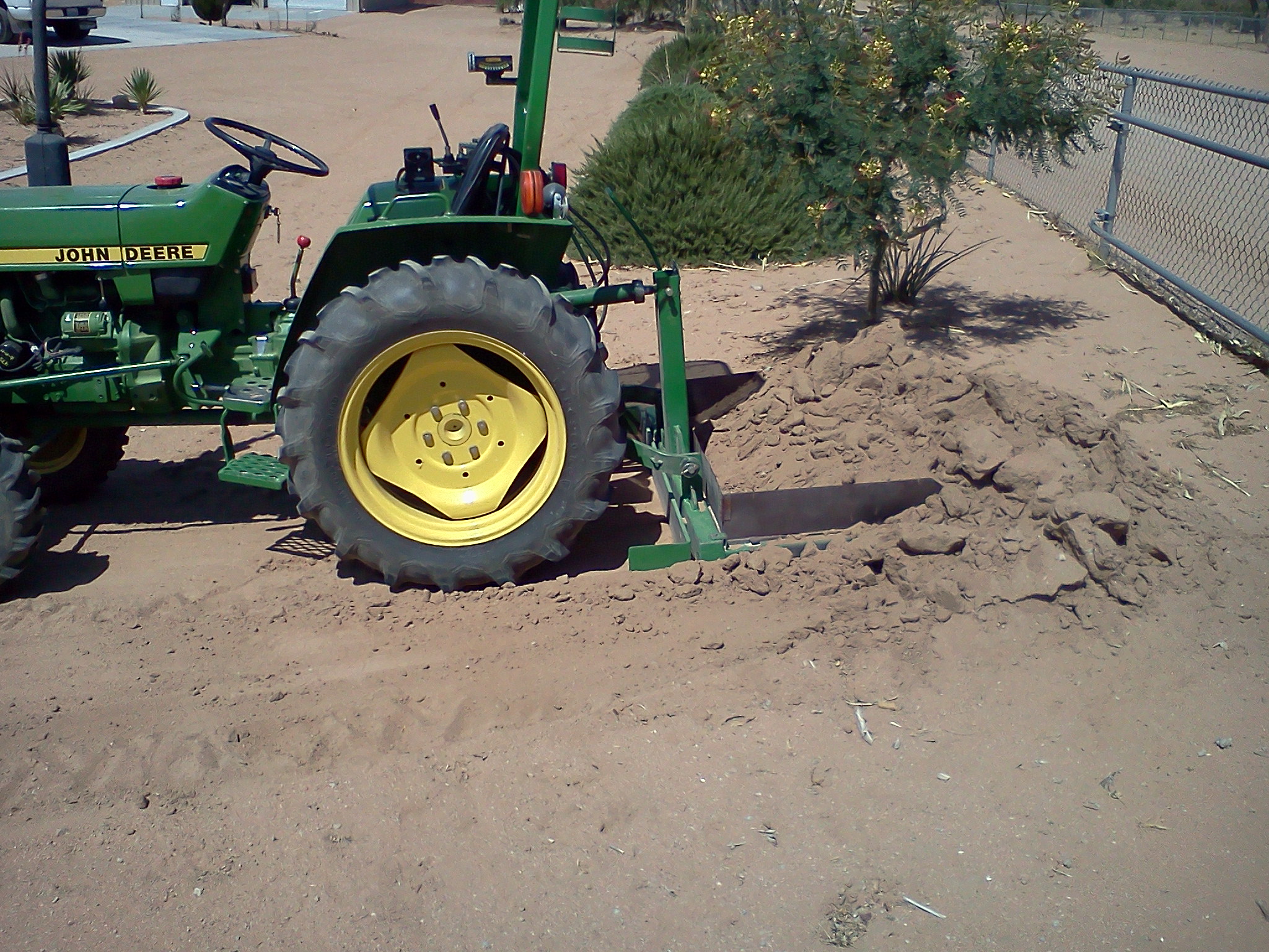

definately make it yourself. i am having a ball making my own implements, at some point i will have to stop because i will have none left to make :laughing::laughing:

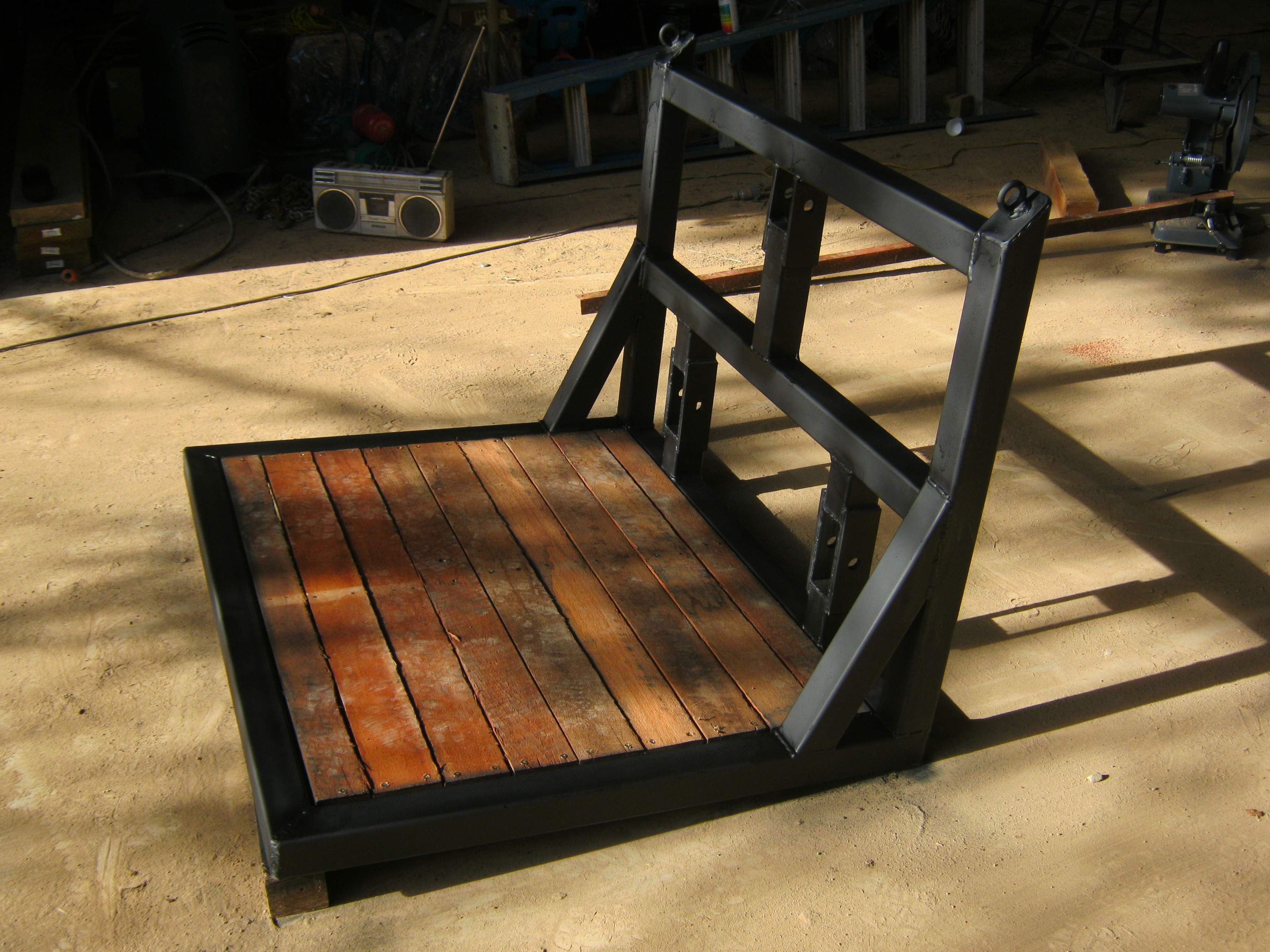

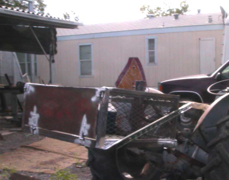

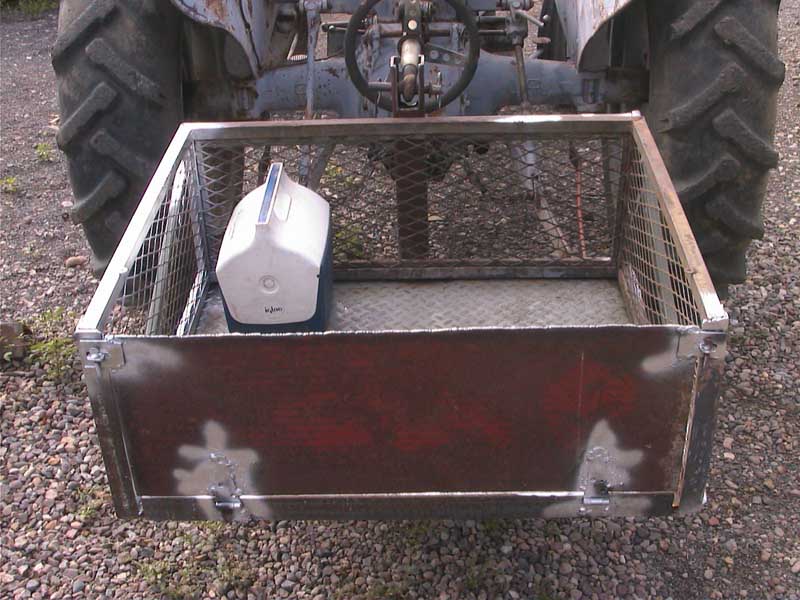

As is clear "Pretty" is not on my agenda. I did offer to paint it, (PINK" :laughing:)
But the tractor owner had a fit.
Nice 1/4" steel diamond plate bottom. Way more than he needed, all he has ever carried is a Beer Chest. :laughing:
