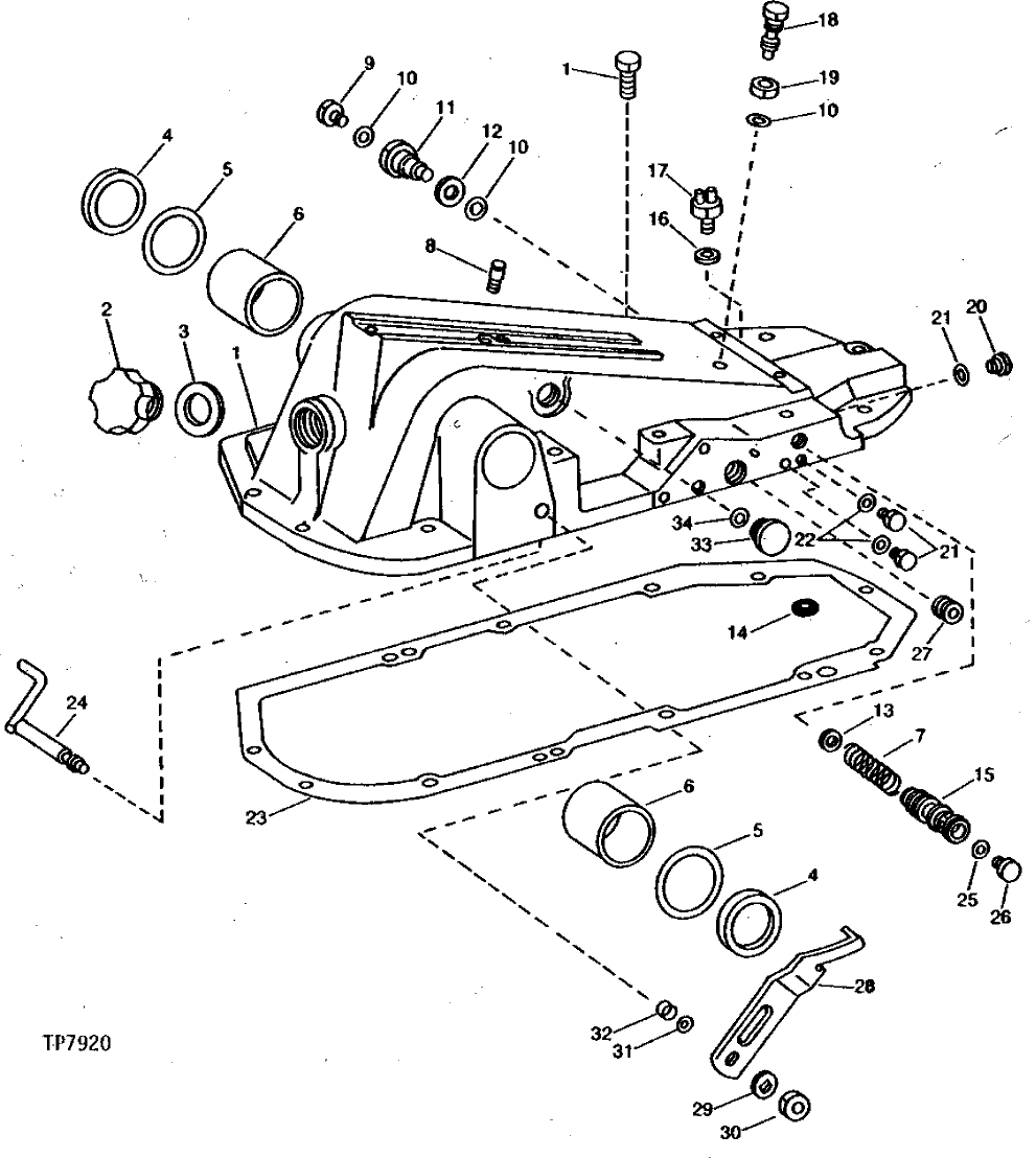

Apr 4, 2015 / 3 point falls very fast #1 M Mike Semper Fi USMC New member Joined Apr 4, 2015 Messages 1 Location glen Burnie Tractor jd 401-b my rock shaft starts to come down slow and controlled be then if completely lets the disk fall. Rate of drop screw or check valve. JD401-B

Apr 5, 2015 / 3 point falls very fast #3 Tx Jim New Member Joined Jan 26, 2007 Messages 10,400 Location Coyote Flats,Tx Tractor JD 4255/Kubota M7040 HDC Rockshaft(3 pt) rate of drop screw is parts key 18. Loosen lock nut and turn screw clockwise to slow 3 pt decent. Attachments TP7920_________UN01JAN94.gif 31.9 KB · Views: 109
