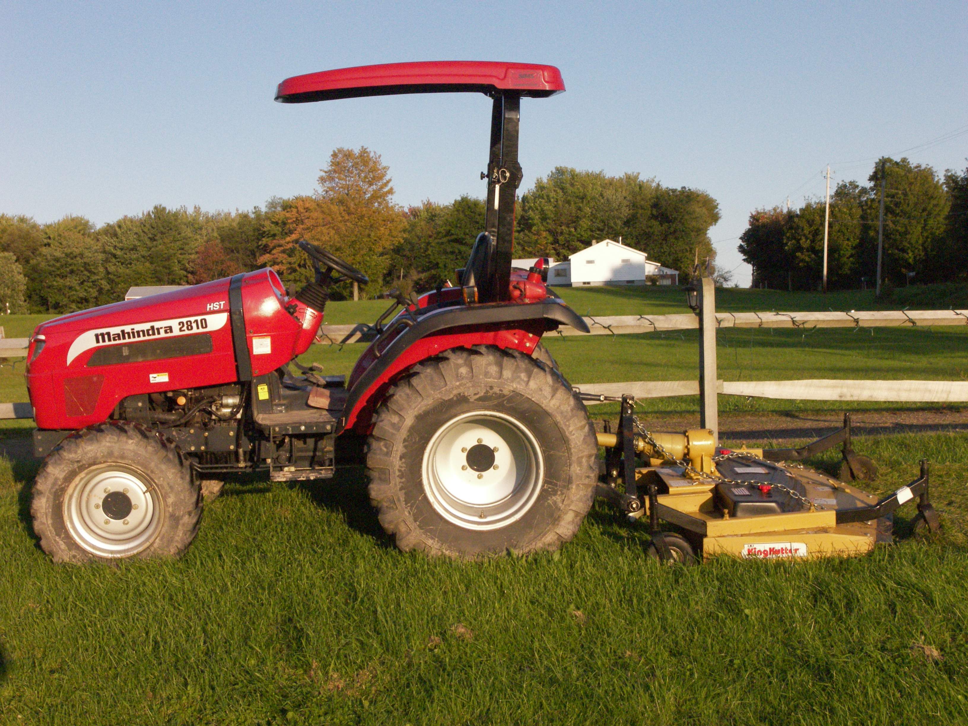

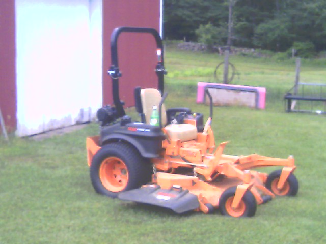

After reading the responses above i have to jump in and say thru my experience that a zero turn mower is the best and the fastest cut but i mow with both, my mowing is heavy grass, wet and hilly with very steep sections that get mowed rain or shine. I have in the past 5 years of large acre mowing never had my RDFM mower "dogwalk" nor cause me any problems on side hills. In my area we have all types of mowers from MMM to zero's to RDFM's and have matched my RDFM to anyones mower there with fantastic results. everyone whom i've mowed for is extremely impressed with the finished result of my RFFM and it stripes too! I'm really sold on the RDFM even though its slower than the zero turn. Mowing 33-37 acres a week when the snows gone and hopefully more this year. . . John
"Big or small" i mow-um all. . . :cool2:
