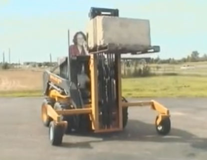

Looks easy to operate, relaxing even. But hey that guy's not wearing a seatbelt! :laughing:
415493d1425747199-3-point-forklift-mast-go-forkster-jpg
That skidsteer unit looks like a useful device. Certainly more useful than what I envision. I like the heavy-duty caster wheels, I was thinking about that, and whether it would be a necessary modification. Great to see somewhat similar device. I'd like to see a video of a guy using a 3-pt mounted lift mast.

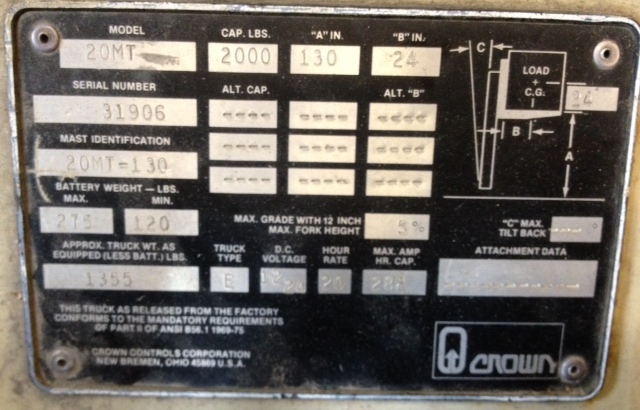

Thanks for the help Renze. Here's the Crown 20MT plate listing capacity, 2000 lbs. In general I anticipate lifting under 1,000 lbs. The unit weight is 1355 lbs. I'm guessing after stripping the electrics, pump, drive motor it will weigh about 700 lbs.
415495d1425748607-3-point-forklift-mast-go-20mt-plate-jpeg
Your first two pictures I looked at appeared to ha e the wheels between the mast and the tractor. If you have them out under the forks that would be a much better arrangement. That is doable for the 700 to 1000 lb loads you mention.
