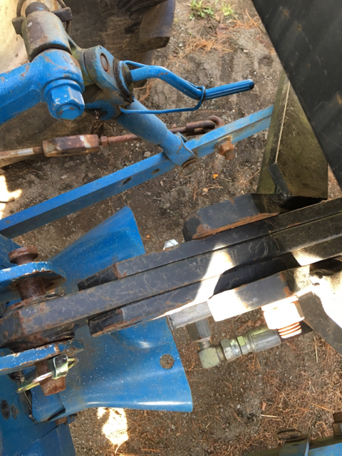

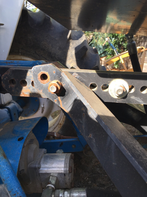

I have a 1980 model backhoe made in the US that was sold as OEM by both Yanmar and Kubota dealers. Its manual has an addendum for a recall kit, which is installed on my hoe. The kit adds restrainers below and forward of the three-point pins. The restrainers touch the lower edge of the 3-point arms and won't let the hoe fall forward if the top link should fail.
(This photo is a little confusing - the hoe is off, and parked. The tractor is parked next to it)
101845d1209852791-kubota-mystery-backhoe-does-anyone-p1180632rbackhoechaindetail-jpg
But this hoe still has a safety deficiency - there is no 'handlebar', loop, extending up over the control levers so falling forward would unavoidably push the levers. Also with nothing there, there is no way to pull yourself upward to get on the hoe. I added a barn-door handle (photo, similar) on top of the 'dashboard' to make a grip point there.

California, those restrainers would definitely work if needed. Of course the failed top link would need repaired, but at least you wouldn't have to crawl up out of the hole to fix it!!!! :)
/ 3-point Hitch Backhoe Top Link Buckled: A Cautionary Tale #39
I found a better photo showing the safety restrainer (described in post #35) under the 3-point arms that will prevent the backhoe from pitching forward if the upper link breaks.
I took this photo for a different purpose initially, to show a weed, a little oak tree with more root than expected, that I pulled out using the backhoe from next to an orchard tree trunk. These (some are larger) were near impossible to dig out by hand right next to an orchard tree with their roots intertwined, now the backhoe pops them out like carrots.
This backhoe is a great toy. :)
