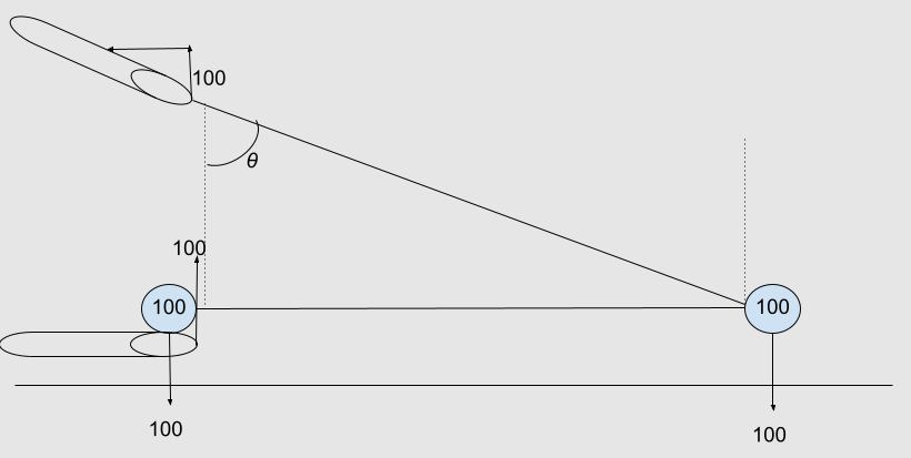

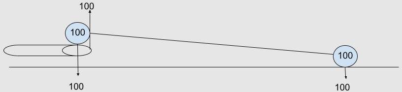

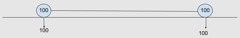

/ 3 Point hitch upper link #64
In the first example, the top link will be exerting force in both the x and y direction, and in actuallity some, albeit smaller force, in the z direction. In this example the top link would be in compression to provide those forces.
In the typical configuration with the top link positioned above the lower lifting arms, the link would be in tension to provide the forces in the x, y, and z direction. Call it lifting, pushing, resisting the moment, whatever. It still exerts a force in those directions.
In the second example above, clearly the top link is not needed since, being in “perfect” balance there is no force in those 3 directions.
But in reality, if you were to use the lower arms to actually lift, it would no longer be in perfect balance. Since the lower arms rotate on a pivot point there would be some movement either toward the rear or front direction and it’s going to fall over without the restraint provided by the top link.
Could you estimate the magnitude of the top link restraining force in the second example?
Is it in grams? or ounces?
Or "Depends on the lift arm speed of motion?"
#65
I hope that nobody thinks my comment was sarcastic....it wasn't meant to be.
I think that the original diagram posted by TerryR is a culmination of applied knowledge to a specific set of variables.
But in my humble opinion they are not representative of real life applications, just an example of how forces are determined.
For it to be correct....the weight distribution would have to be exactly as illustrated..
In reality, and in these circumstances very few implements would have the balance or load points as the illustration suggests.
There are some variables that cannot be calculated, just measured and documented.
