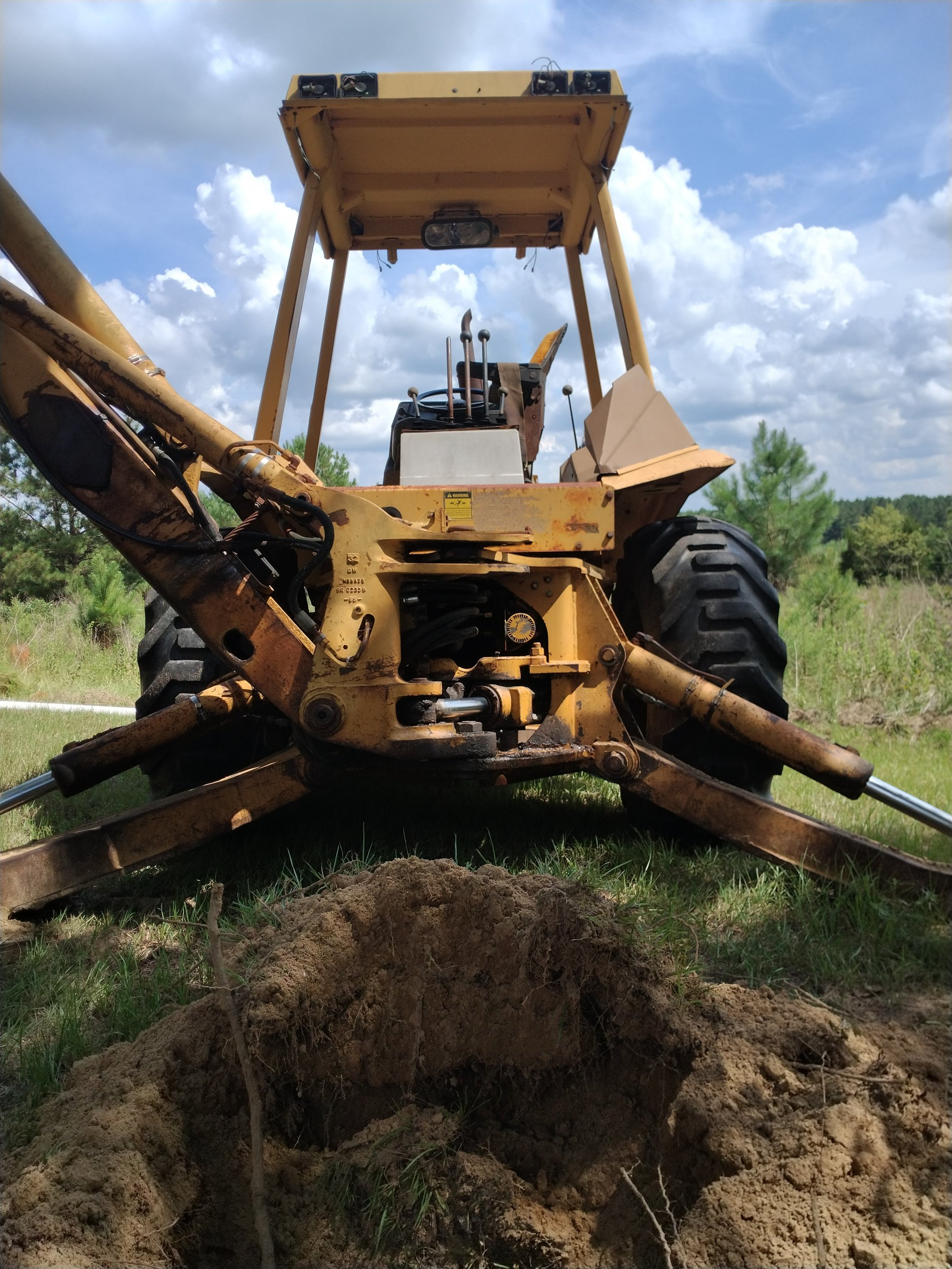

We have the biggest 3 pt type we could find. Had it for 17 years now. Still have the same tractors. Digs great, no problems. I think it's a Bush Hog 962, but not sure. Dig stumps, footings, ditches, water well reserve pits, fix water leaks. Does it all. But, my friend just sold a John Deere backhoe that was good for 900.00 , he had two, his dad died, and he kept the CAT. They were his dad's. JD just got water in the oil, so we had to drain it after use. But that could be a thermostat causing that.
