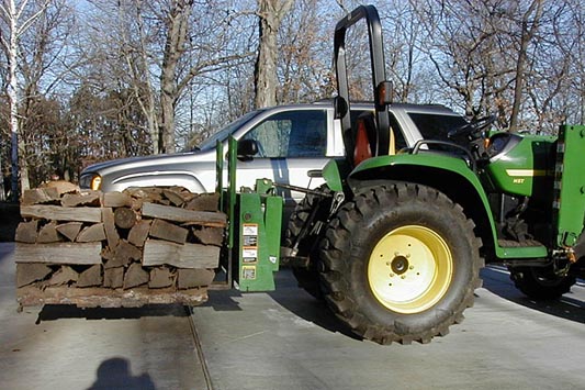

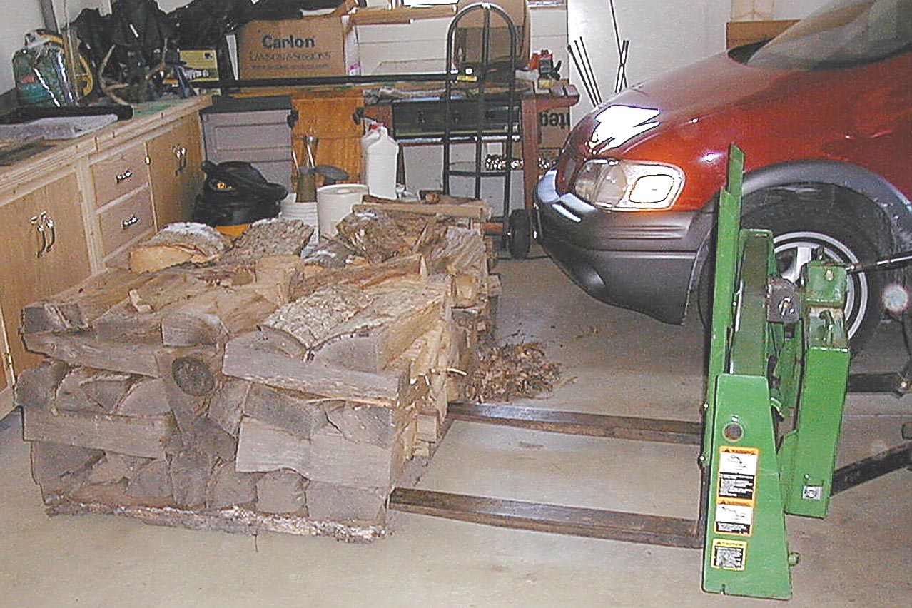

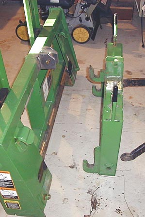

They are very handy to have, and especially handy with HTL. I move all my firewood on pallets from storage into the garage with the forks on the iMatch. Not much additional iron to make them iMatch compatible.

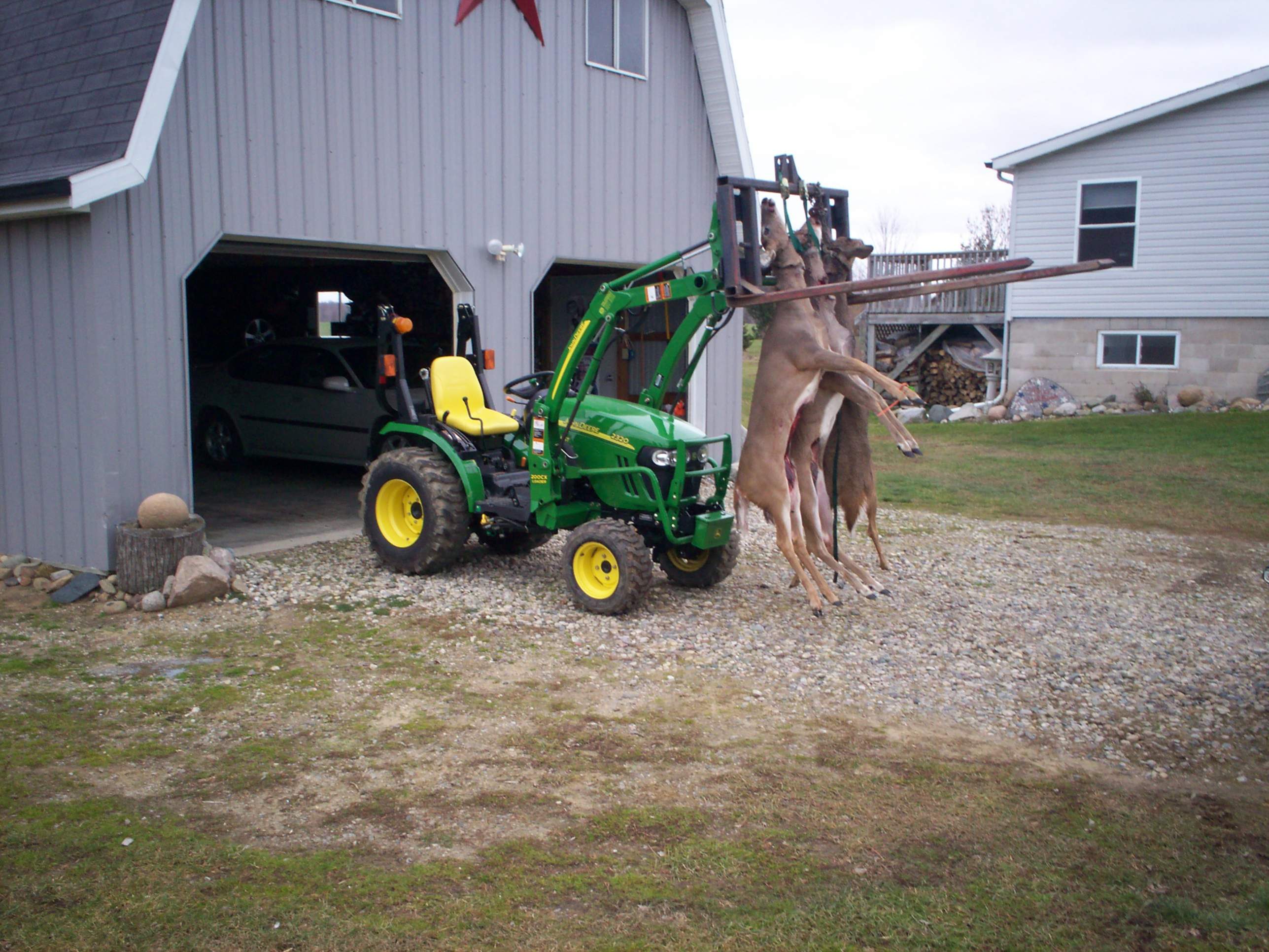

Another thing guys can do also is buy an old three point round bale mover and add the quick tach pieces for the loader. I was able to do this and got the pieces for about $40 from Deere. The only problem is the forks are not adjustable side to side but the tines are nice and long to accomodate sliding underneath large round bales. Heres a pick of mine. I can also still use these on the three point.
   / 3 POINT HITCH FORKS w/pics #14
Don't see no ''large round bales'' in that picture.:D
   / 3 POINT HITCH FORKS w/pics #15
Wish I had thought of this before I bought a home made bale carrier (it has two, 2 1/2" square tubing forks, 47" long) to use on the rear for pallets. Since I have a set of forks for my loader. Could have saved some $s modifing them, but at least I can still use the forks on my loader and have a heavy load on the bale carrier for ballast.
