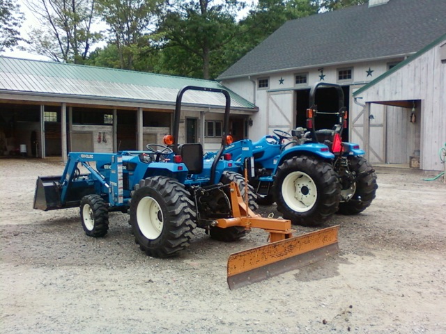

Nobody brought this up but did you check if your rear wheels are dished in or dished out?
   / 3-point hitch hitting back tires: PLEASE HELP! #16
He's dished in, as can be seen in the photo below, with his tc 30 on the left
