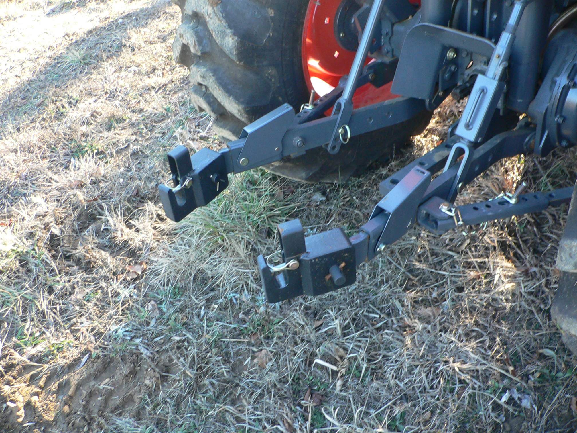

You may want to order these off ebay. Under $100 and they will work on any attachment. As others have mentioned they set back a few inches so may need a different upper arm for $20 at TSC.

CHDinCT , Gets the Pats or the pats knock off, you'll thank yourself. You'll be able to hook up that chipper in a 60 seconds , maybe another 40 seconds for the PTO shaft. and un hooking is eaven easier...
No more swearing at the 3 pt hitch!!!:D
