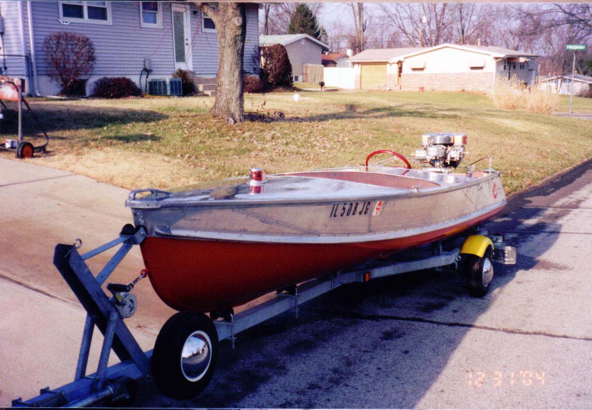

Is that Johnson a K35 by chance?
   / 3-point hitch lifiting boom
#12
Just a late 40's PO-15
I have about a dozen of 'em, including (2) WWII surplus "assault boat" versions.
And at least a half dozen of the similar sized, but totally different, Evinrude Speeditwins.
And a whole bunch of others.
Used to be real heavy into antique outboards but not so much anymore.
Here is a Po-15 on an old Crestliner I used to own. Blew-up the PO several years ago, and
sold the boat not long after:
