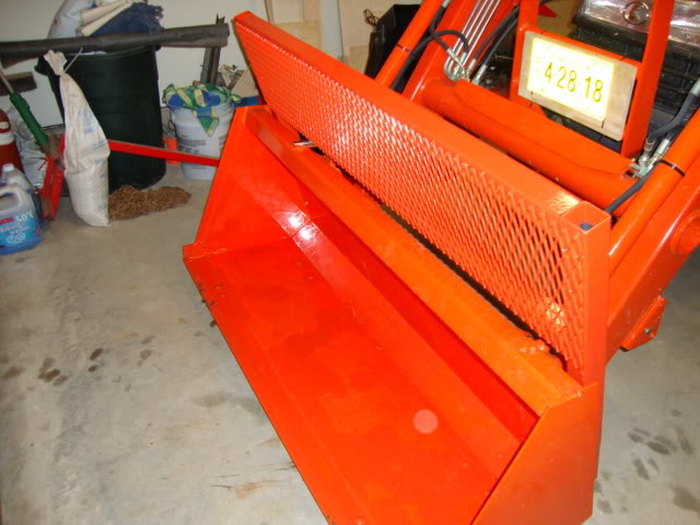

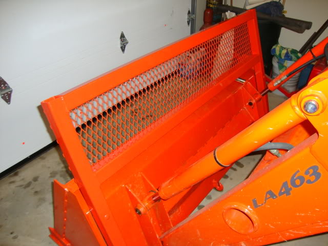

If you're looking to make a guard, it might as well be dual purpose. Mine was designed to be a snow screen originally, but I think it would work for this as well. It's angled up the back of the bucket, you'd really have to work at getting the log on top of you. I already have holes drilled in the reinforced bottom of the bucket for my winter skid shoes, I may make some short forks to bolt on there for firewood season. I really don't want to weld anything on the inside of the bucket.

Nice guard. It makes sense to have it separate from the forks for brush and deep snow handling. There have been a few times I almost rolled the top of a pile of soil onto myself. More options. Less decisions. Must think.

I used 2 inch square tube with 1/8 wall, so it's plenty strong for what I use it for. Snow is normally light enough that a full normal bucketful doesn't weigh much, and I hate having it spill back over the top of the bucket when I'm pushing. 4 3/8 holes in the bucket and a couple of carriage bolts on both sides are all I used for attaching it.
