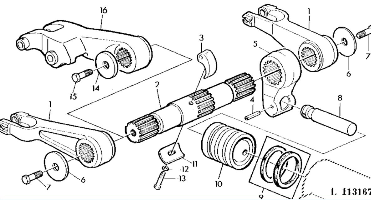

It's possible, if your connection between the rockshafts and their rotary actuator is splined, you could reassemble the rockshafts a few spline teeth upward to raise the range of motion.

The E-Z hitch advertised at carterandsonsllc.com could raise the attachment height of the lift arm a couple of inches. They have a little different design than Pat's and some others have.
Thanks! This product looks like it will work great
   / 3 point hitch not high enough #13
The rockshaft adjustment suggested above may work also.

Only one side is adjustable. I think I may need to try and find some shorter link arms.
I think you need to change the word "Shorter" to "Longer". You can control the lowest position with your 3 pt level lever meaning "length" doesn't matter. You can't raise the lift pins high enough. Extending the "radius" of your arc will make for a higher lift. Pat's quick hitches will add a few inches to the lift height and will be easier to connect.
The other thing is if you want to lift the implement higher, like get the tail wheel of a shredder higher in the air when transporting, select the lowest hole on the back of the tractor for the 3rd member connection. This won't affect the lift pin position, but will raise the tail end of the implement higher. If your implement has several holes for the 3rd member pin, like my Morra Tedder, select the one farthest back, if you can do that and still get your implement level when in the work position.
