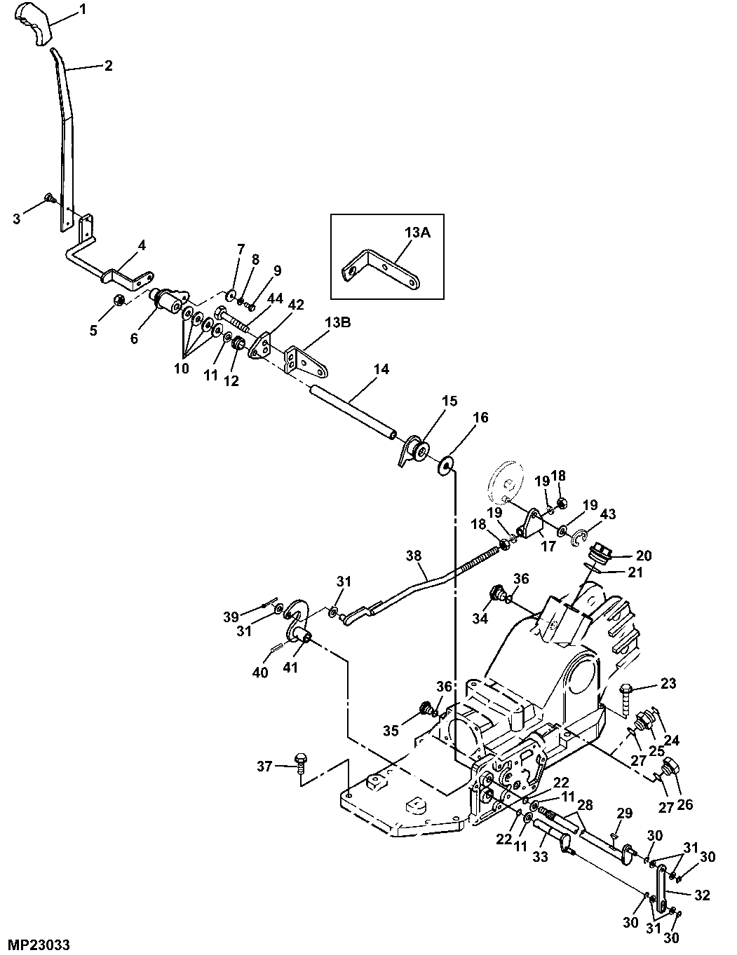

I am 99.9% sure there is no switch's on the 4x00 series machines...
Diagram below of the rockshaft linkages:

   / 3-point hitch not working #27
The 4x00 series machines used the model 47 and 48 hoes? With the early rockshaft attachment system? 3pt disabled with hoe - what type mechanism?

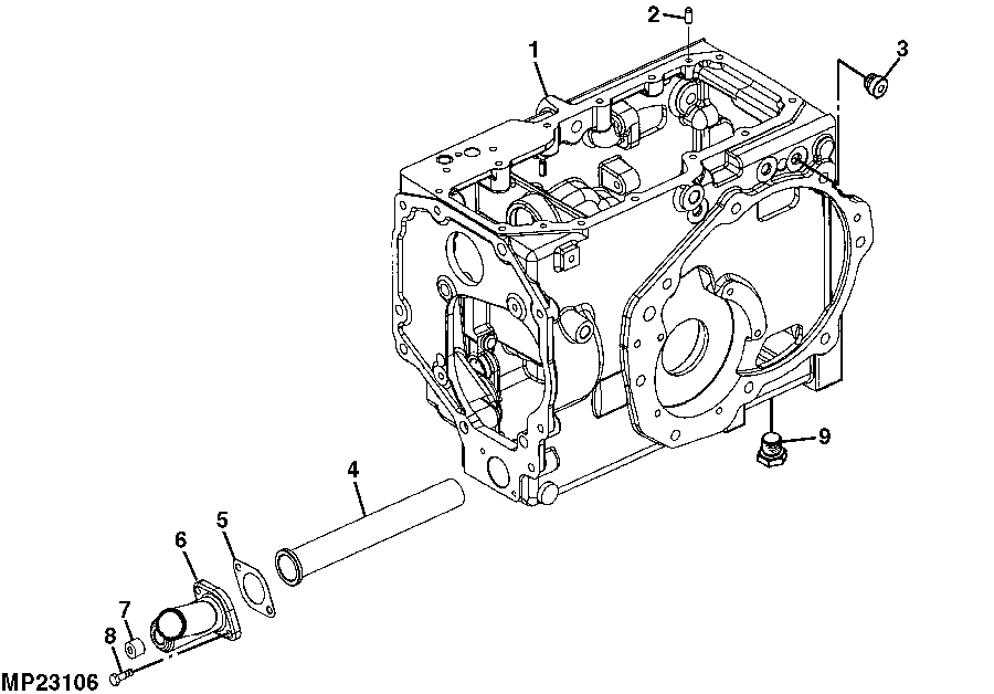

Kennyd,
Do you know anything about that "oil suction screen"
It says in the manual, that if it gets clogged the 3-point hitch won't work.
   / 3-point hitch not working #29
I have never seen that switch on mine.
Kennyd,
That's the main screen in the bottom of the sump (#4 in the diagram)...if it's clogged then the loader would not work either-and the tranny would be having issues as well.
This is a simple problem...I just know it is!
