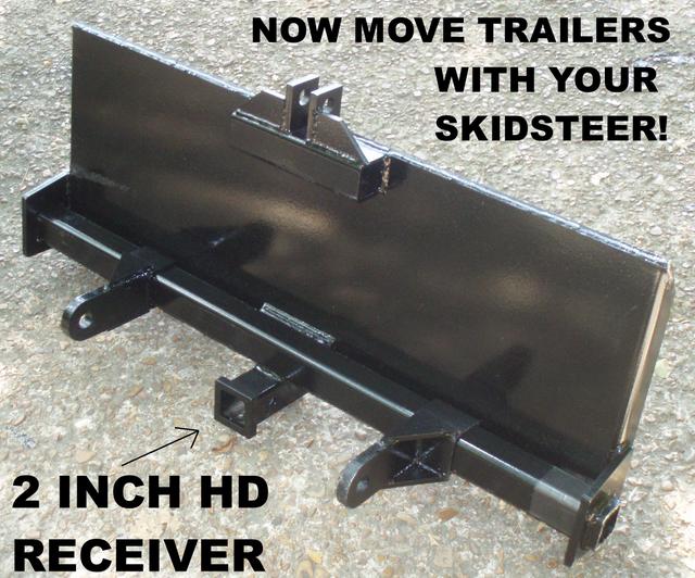

yea but the ad also says
Sale Price: $1452.00
OUCH!
I prob wouldnt buy it at that price but saved the link at some point for reference for a build it yourself project

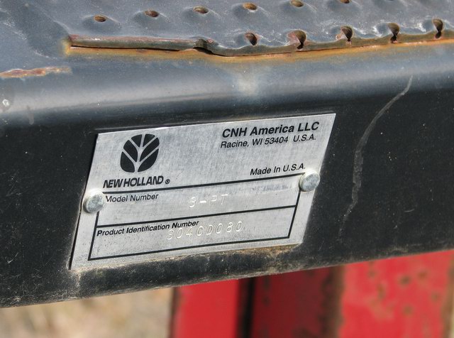

My adapter was only $250 from my New Holland dealer. I think I could do a lot of modifications for $1200.:rolleyes: For example, I could cut the lower link adapters off and replace them with a sliding rotating ball adapter welded to a square tube section fitted over the existing square tubing. I think I could do that for less than $200 more. I think you can order this from your NH dealer using the data plate info. It's probably up to $300 or more by now.

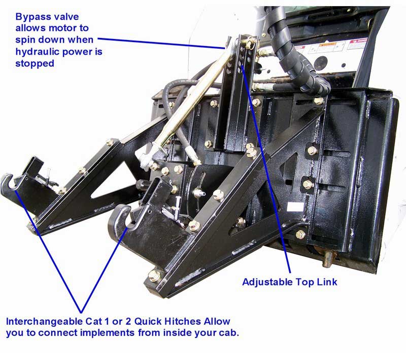

I wish I could get a better look at it. Just to see how the width adjusts
It is just a tube inside a tube which slides to the position desired. Looks fairly easy to build.
You might be able to hang some forks from the top, or make that bottom tube removable, so forks could slide on.
The second and third pictures have a hyd motor for those powered attachments.
The third picture has hyd motor and adjustable width.
