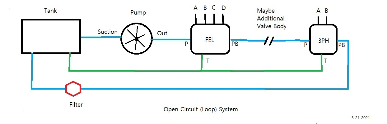

Do a drawing similar to this....
Even just a pencil sketch on paper and snap pic of it...
I wonder???.. IF PO may have used a "T" in the curl up line to supply power to 3PH because PO could not get proper PB plug?... Seem to me its the only "logic" I can come up with that would cause it to function this way......
Also wonder if FEL valve body has PB port and what type of plug/fitting it has .....

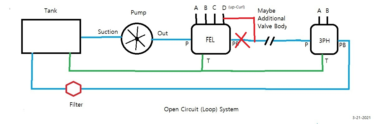

Dale
Nice picture! I was wondering that exact same thing. And with this drawing you've made it easy to see how it all comes down to whether or not his loader valve is equipped with a functional PB.
We could even draw it again - without the loader valve's PB at all - but with the 3pt plumbed in series with the curl circuit.
Two side notes: You show a PB at the 3pt as well - and that is correct of course - although not often called a PB because it is usually internally plumbed and not as easily accessible as the PB on the loader valve.
Also, I see that your drawing has the filter in the (low pressure) return line; my written explanation placed the filter in the suction line between the tank and the pump. For anyone following, either or both filter locations will work. In fact is is common to have both - one being a screen and the other being a smaller particle filter.
rScotty

As you wish....
Dale

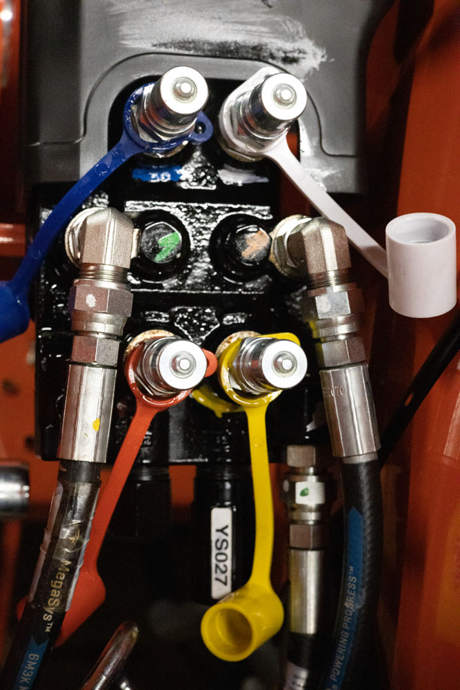

Can you post a picture of your hydraulic valve?

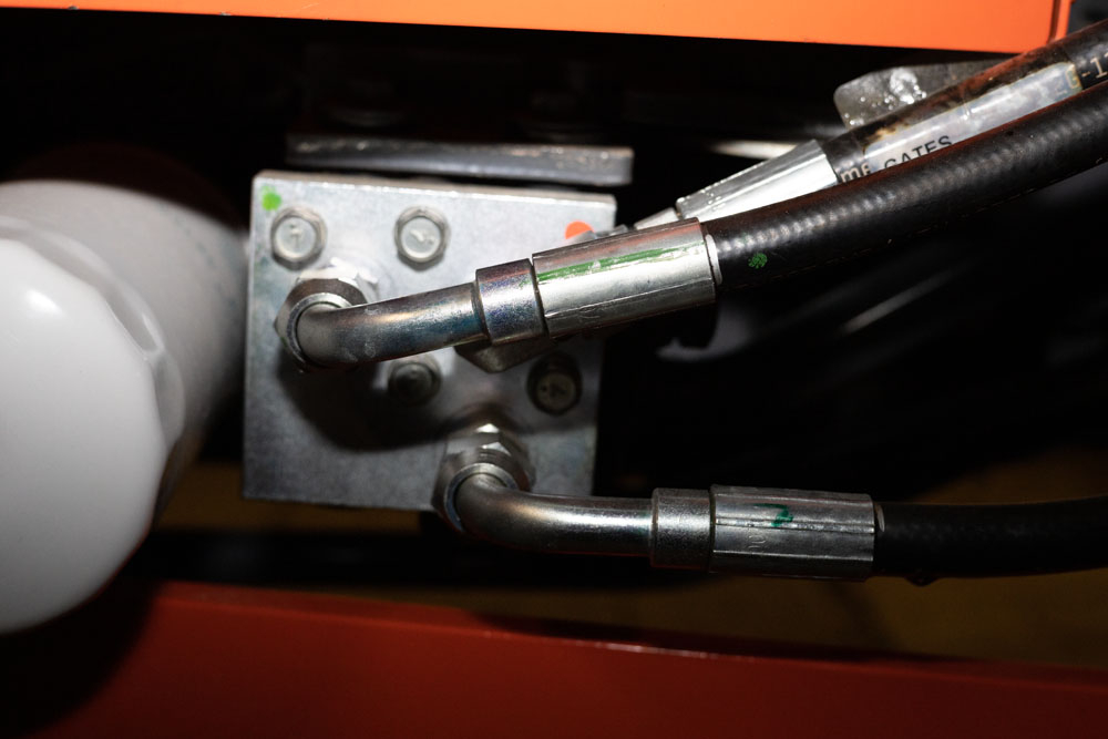

Sure. Here you go. I also took a photo down where it connects below the tractor. And I took a photo of below that block where it seems like there is a slow leak, I'm guessing that shouldn't be happening.
   / 3 Point Hitch Only Raises When Curling Bucket Up
#29
Just a comment on Aarons picture of his valve the individual spools are oriented up and down,
the two quick connects on the left are one spool the two on the right are the other spool in the valve.
When you reconnect your loader only hook up one spool to either the lift / lower lines for the FEL,
or the bucket curl lines and then try both levers or in all 4 directions if you have a joy stick.
One loader function should work either the lift/lower or the bucket curl, then check your 3 pt.
If one function works disconnect those two lines and connect the other loader lines and check function again.
Now you should know which pair of connects goes to the bucket dump/curl and which pair go to the lift/lower of the arms.
And if you try your 3 pt with both sets of connect it will provide more information.
Also listen to see if your hydraulic system dead heads and lifts the relief valve.
After testing...
Right Side (White and Yellow) is lift\
Left Side (Blue and Red) is tilt
Only able to move 3pt hitch up when tilting bucket up. I did test with only right side connected and only left side connected. With only bucket tilt connected, when I tilt bucket up the 3pt will raise to the position I have it set at on the control lever.
I do find it interesting that I can't move the 3pt at all when loader is disconnected. Perhaps thinking about the loader is complicating things? Not sure.

I would tend to believe that as been mentioned your power beyond and return to tank lines are crossed
