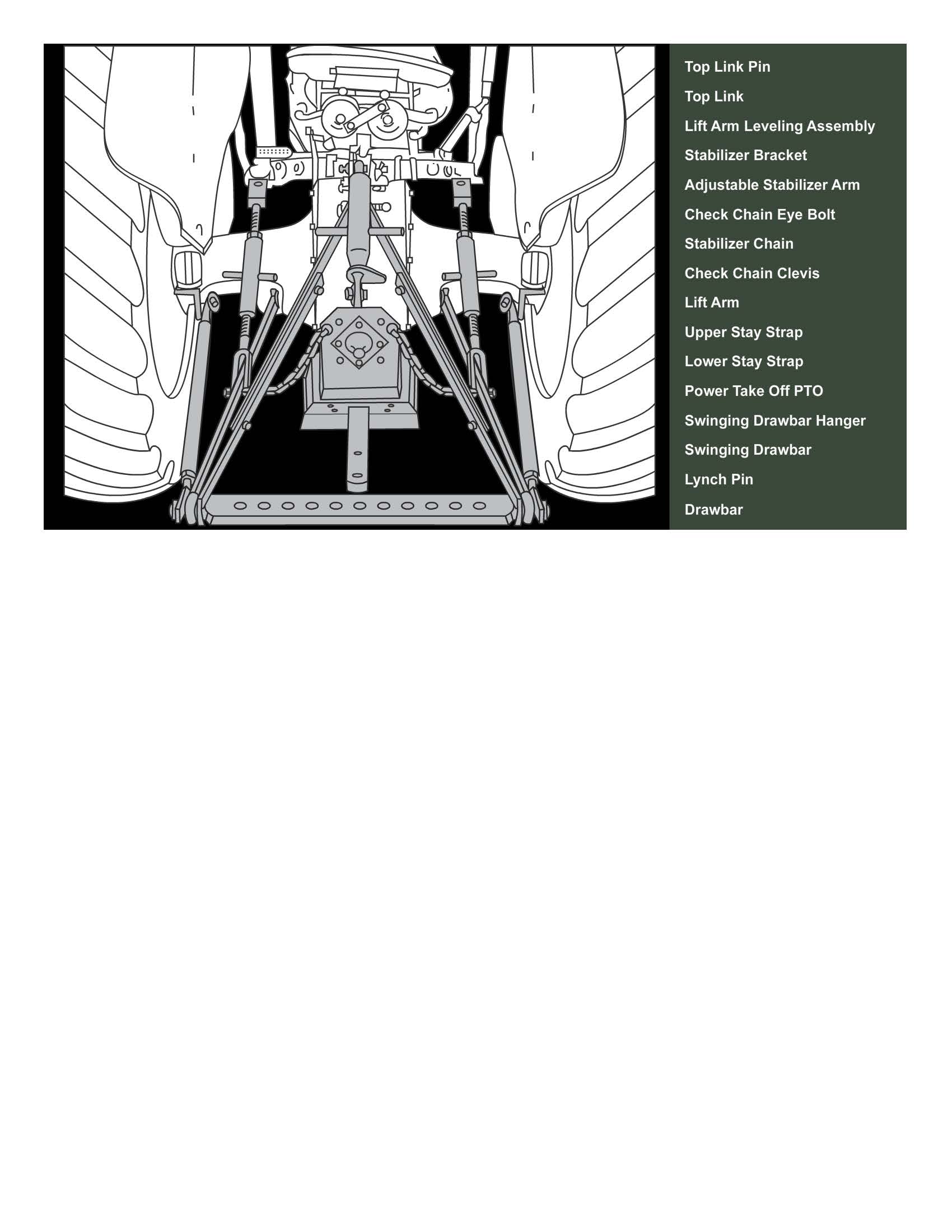

Look at the SPEECO drawing I posted and determine if all the pieces are there. It is generic so your pieces may look different but you need them all for a proper hookup and control.

Jack,
Here is a JPEG version. Content Page.jpgAlso as I stated in my first post; you can go to the SPEECO web site and match the item in the picture to the list of parts Content Page I tried this and it works, no answer why the pdf didn't work.
