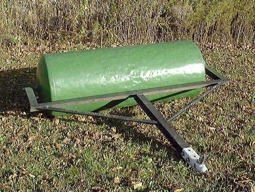

I don't know if there is such a thing as a 3pt. roller. I would think it would be too heavy to pick up. Here is a photo of a 5 ft. 1400 lbs. roller that I made from an old water tank and some angle iron. I use it in the spring to push the rock crop back down in the yard. You might be able to make one like this and use it on your driveway.

great idea Ron!! Do you just fill the tank with water or is it filled with concrete? Mike

It is filled with water and then drained when not used.

Von, I have a water tank, angle iron, and welder. Where did you get, and how did you mount the bearings for the axel to turn in?? Colud you take some pics of that part of your roller and post for reference please. been wanting to do this for a couple of years.
Thanx, Bert
