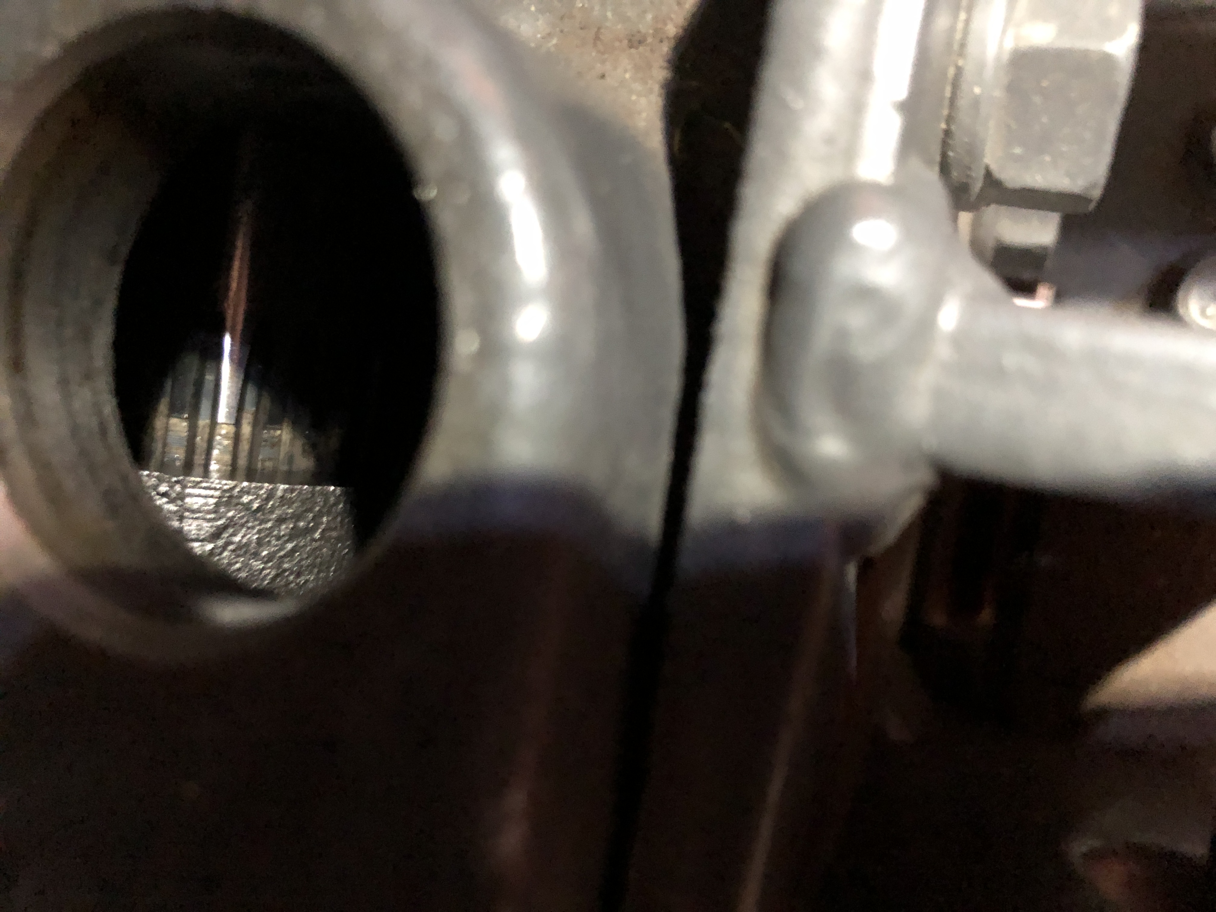

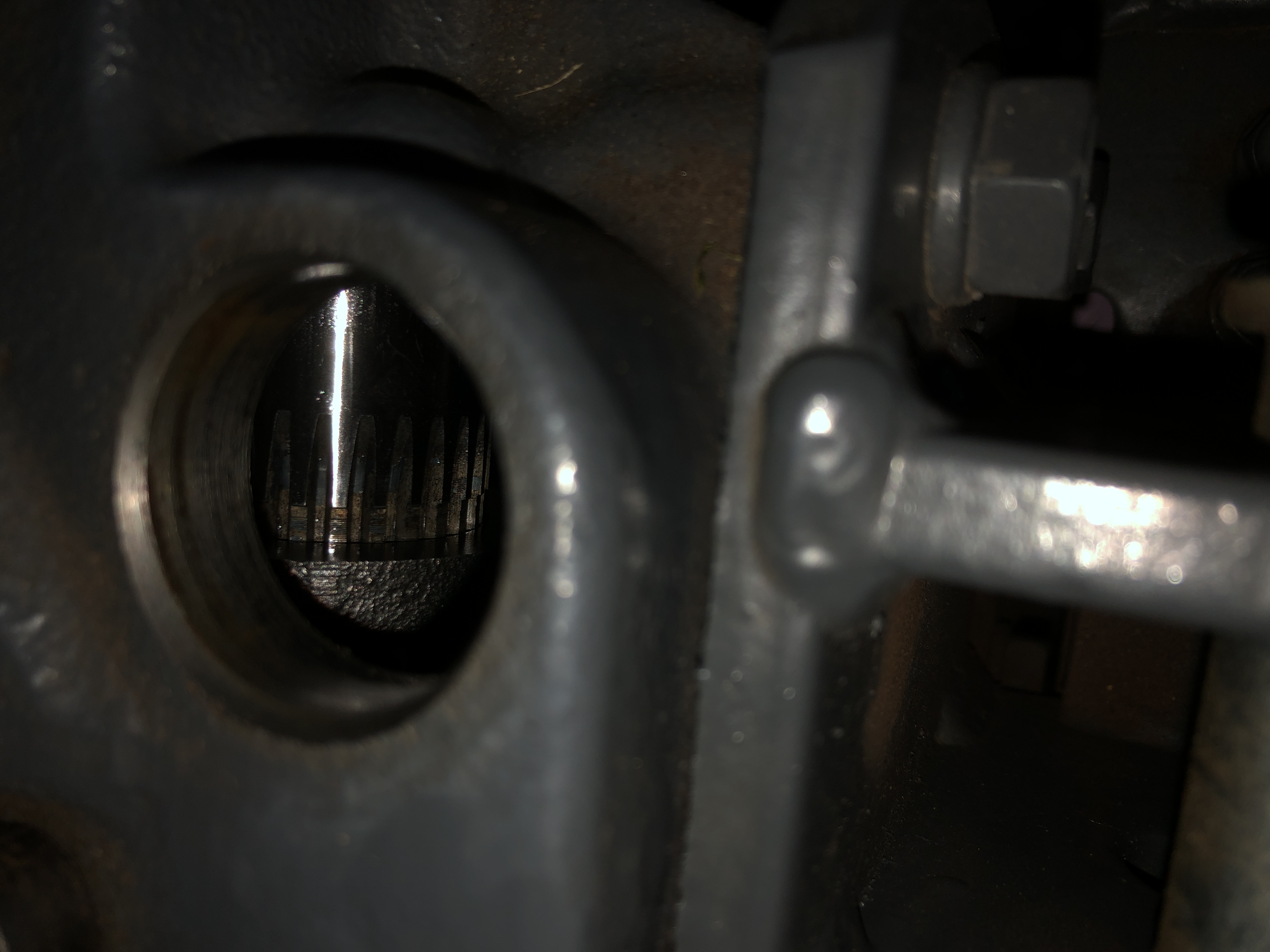

The spline is covered with a rubber cap. Thank you. When I look in the fill hole, I see this. Is it a gear? Does it move? If so how do I engage it? If I can engage it, can I do so with the backhoe attached?
I did see the "gear" move when I manually raised the hitch arms, but not by much. I was under the impression it spun.
Thanks
/ 3 point hitch simple question #4
If you have nothing connected to the PTO splines there should be no problem if you engage the PTO. I would personally remove the rubber cap first - be sure to replace it when done. I don't know that it's necessary to lube the gears in that manner but it should hurt nothing.
