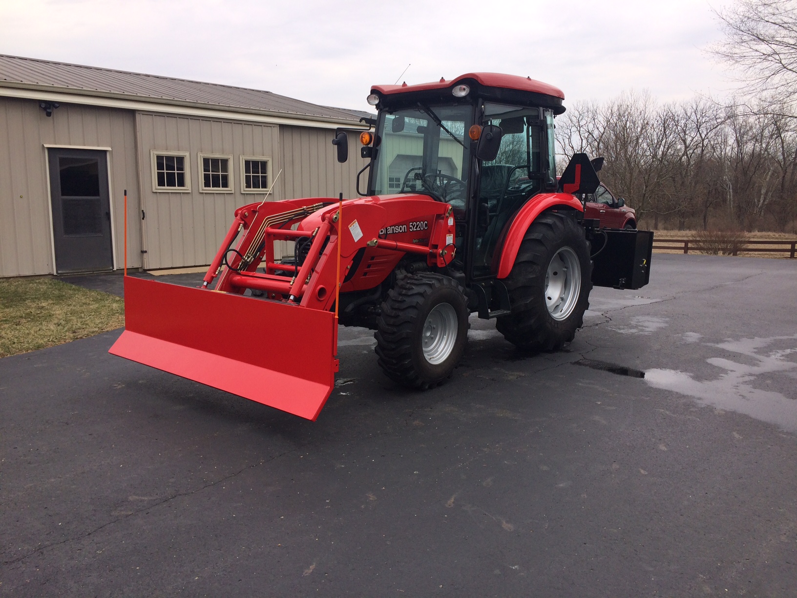

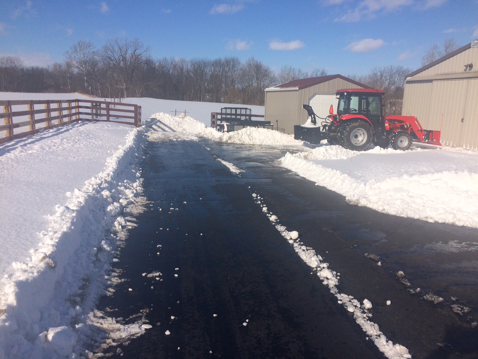

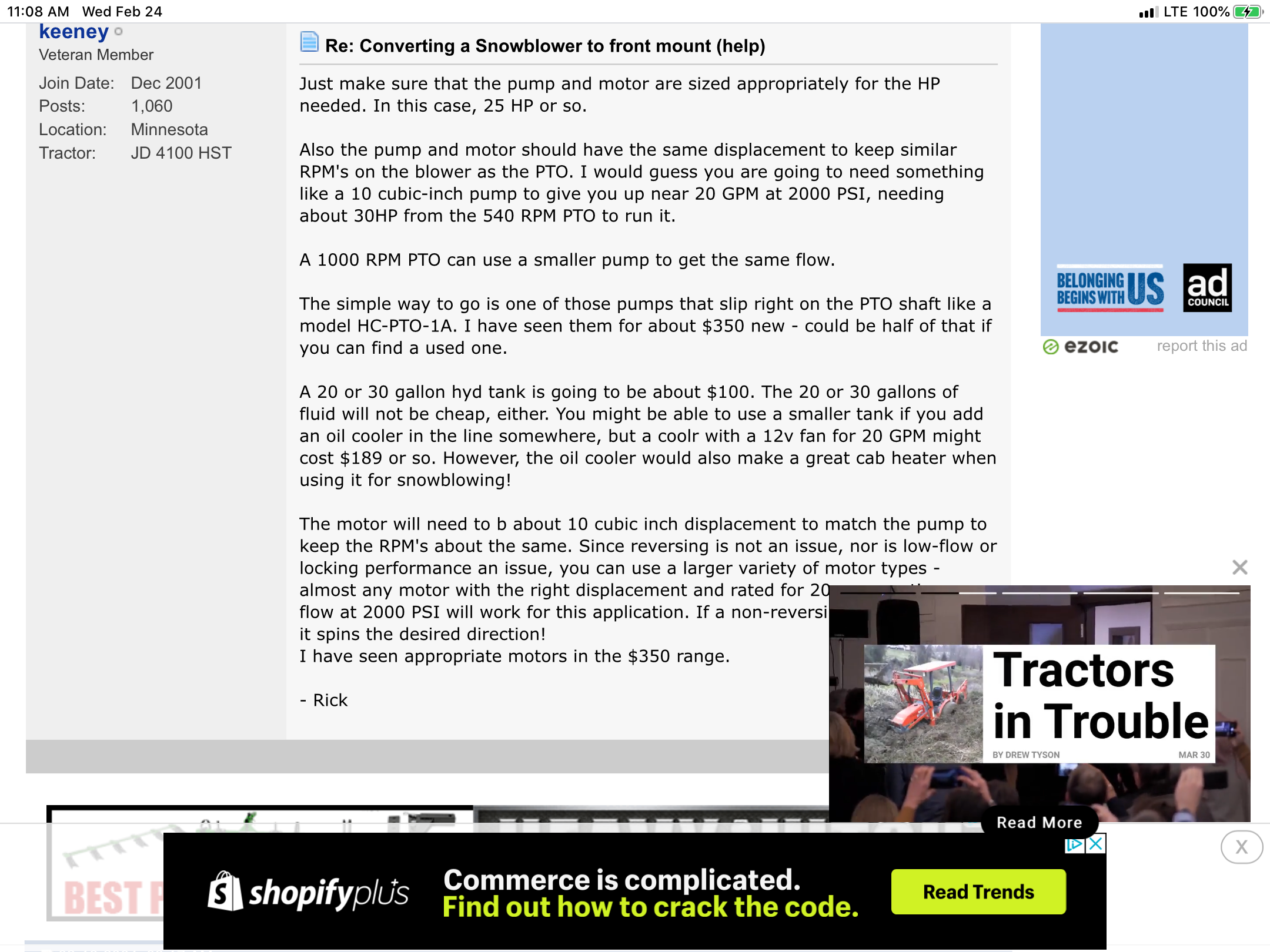

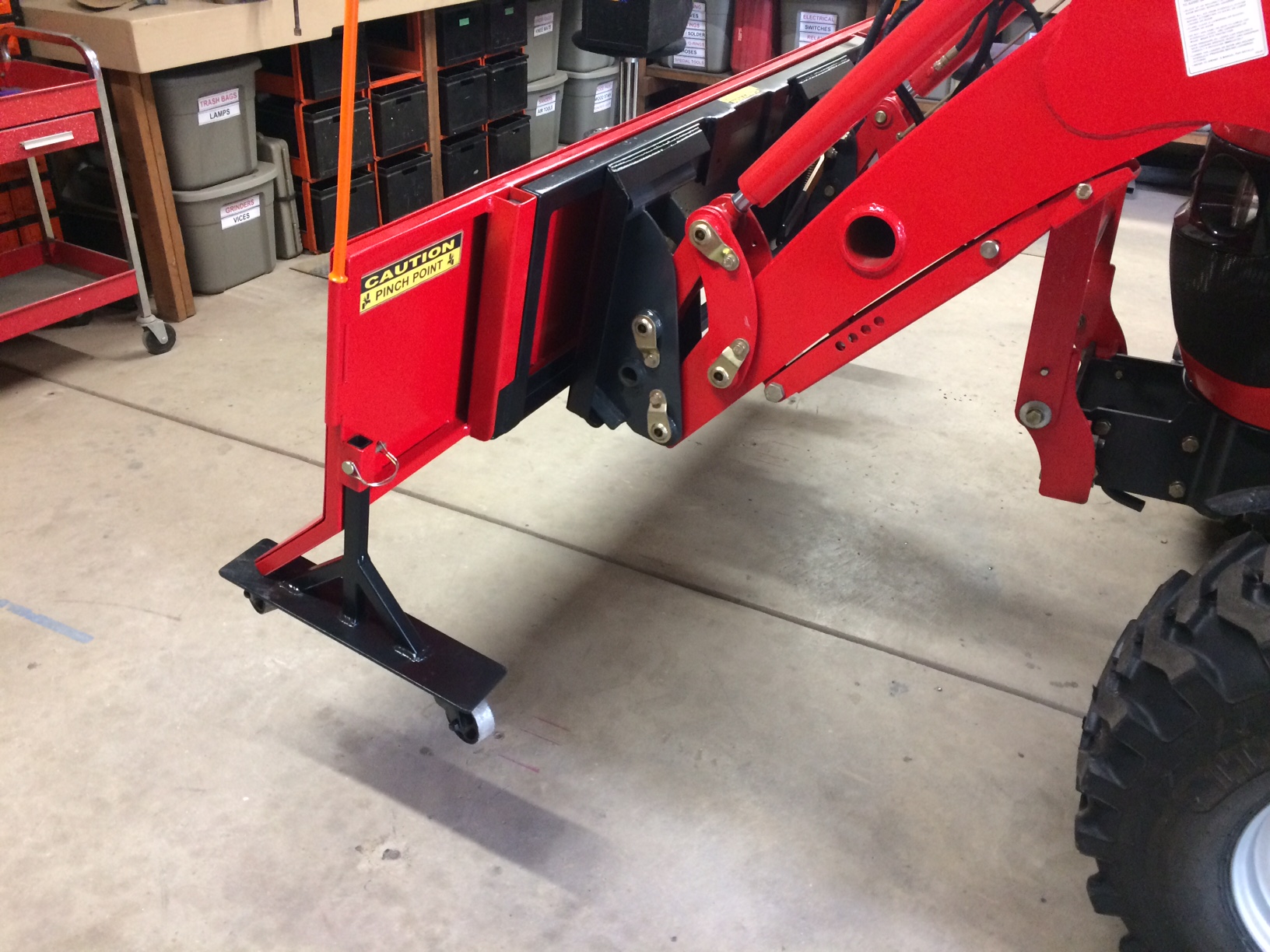

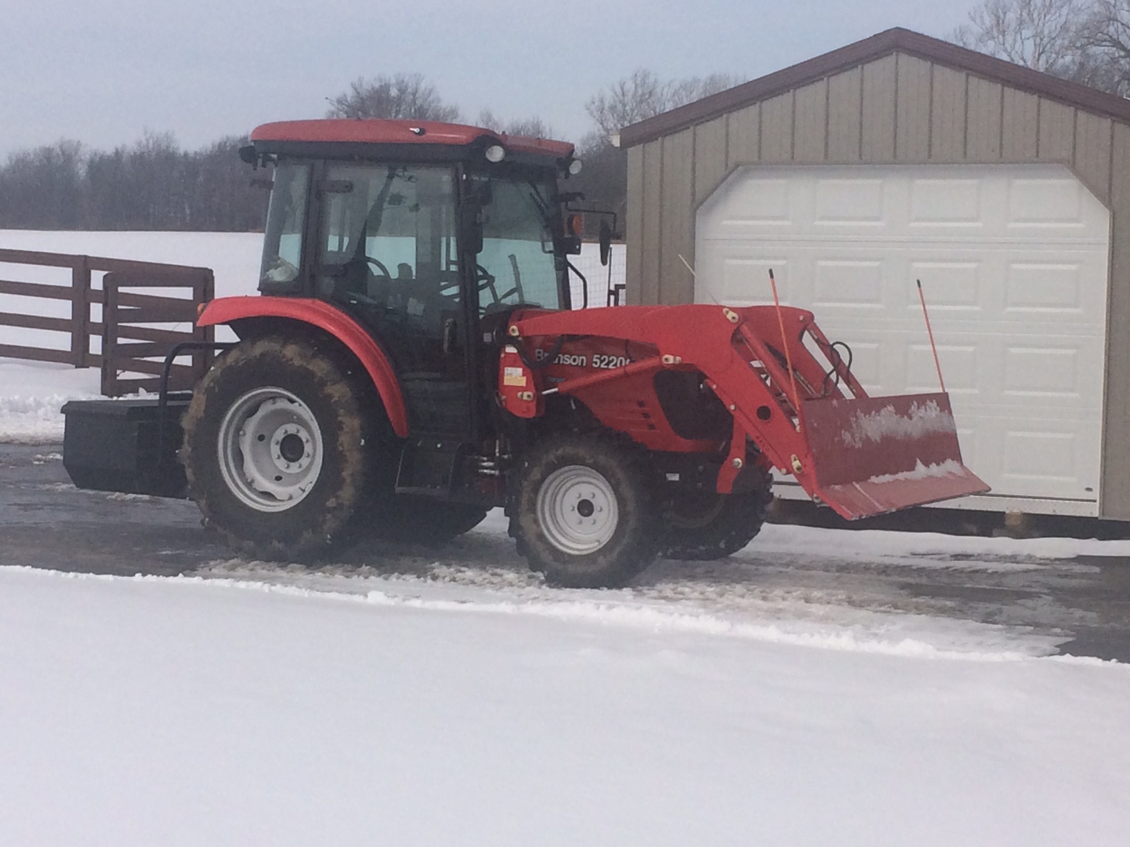

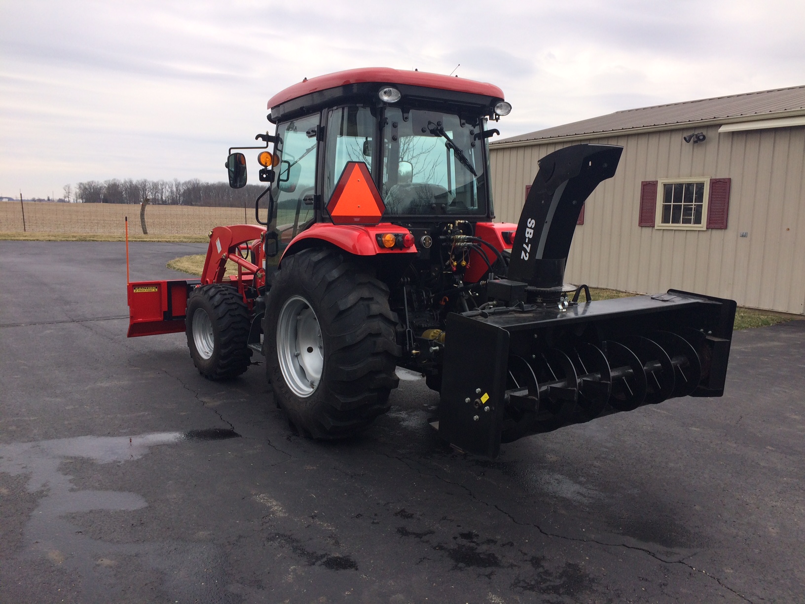

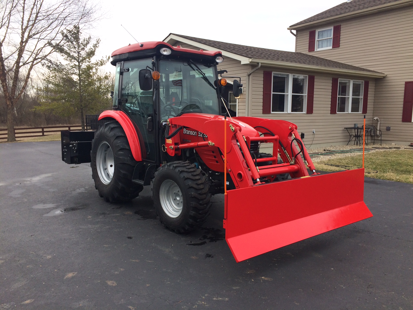

Good afternoon...
I am going to convert my rear mounted 72? 3pt hitch snow blower to the the front. Mounting it to the front, using a 雉*uick detach plate is the easy part. I do have a few questions for you regarding the hydraulics.
My tractor is a 55 hp, 47 hp at the PTO....and the snow blower is a WOODMAXX 72 in. I閾エe had it a few years and it works great....it requires( states on the tag) a minimum of 25HP to operate.
After reading your design/ build posts from a few years back, I was wondering if everything you used on your snowblower projects still works as good as you hoped?
I plan on using a 20 gallon tank for hyd fluid.
I plan on using the tractors rear remotes to raise/ lower and rotate chute.
I just want to make sure that what you used, regarding PTO PUMP and HYD MOTOR is the right size for my project?
Thank you and anyone that can offer positive ideas on this upcoming project
Older retired guy.....
John
