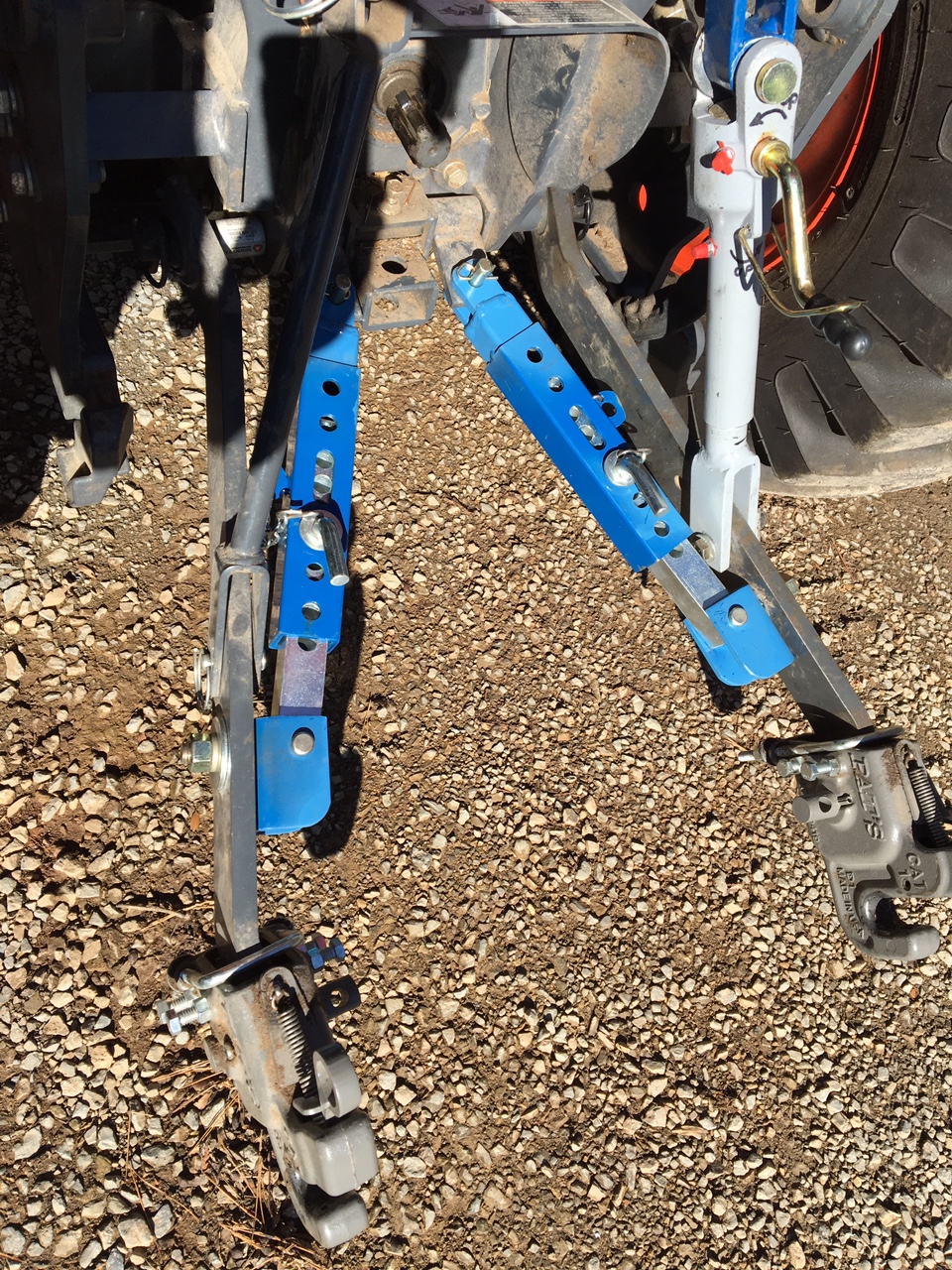

Feb 1, 2019 / 3 point hitch stablizers #4 S Smokeydog Elite Member Joined Jan 20, 2019 Messages 3,213 Location Knoxville, Tennessee Tractor Kubota B26, M59, M5030DT Modified a set of Kubota M type, blue paint from eBay. To fit both Kubota M59 and B26

Feb 1, 2019 / 3 point hitch stablizers #6 S Smokeydog Elite Member Joined Jan 20, 2019 Messages 3,213 Location Knoxville, Tennessee Tractor Kubota B26, M59, M5030DT The leveling box I got from Weavers tractor supply. Like this a whole lot better than the turnbuckle style. Must have for grade work.
