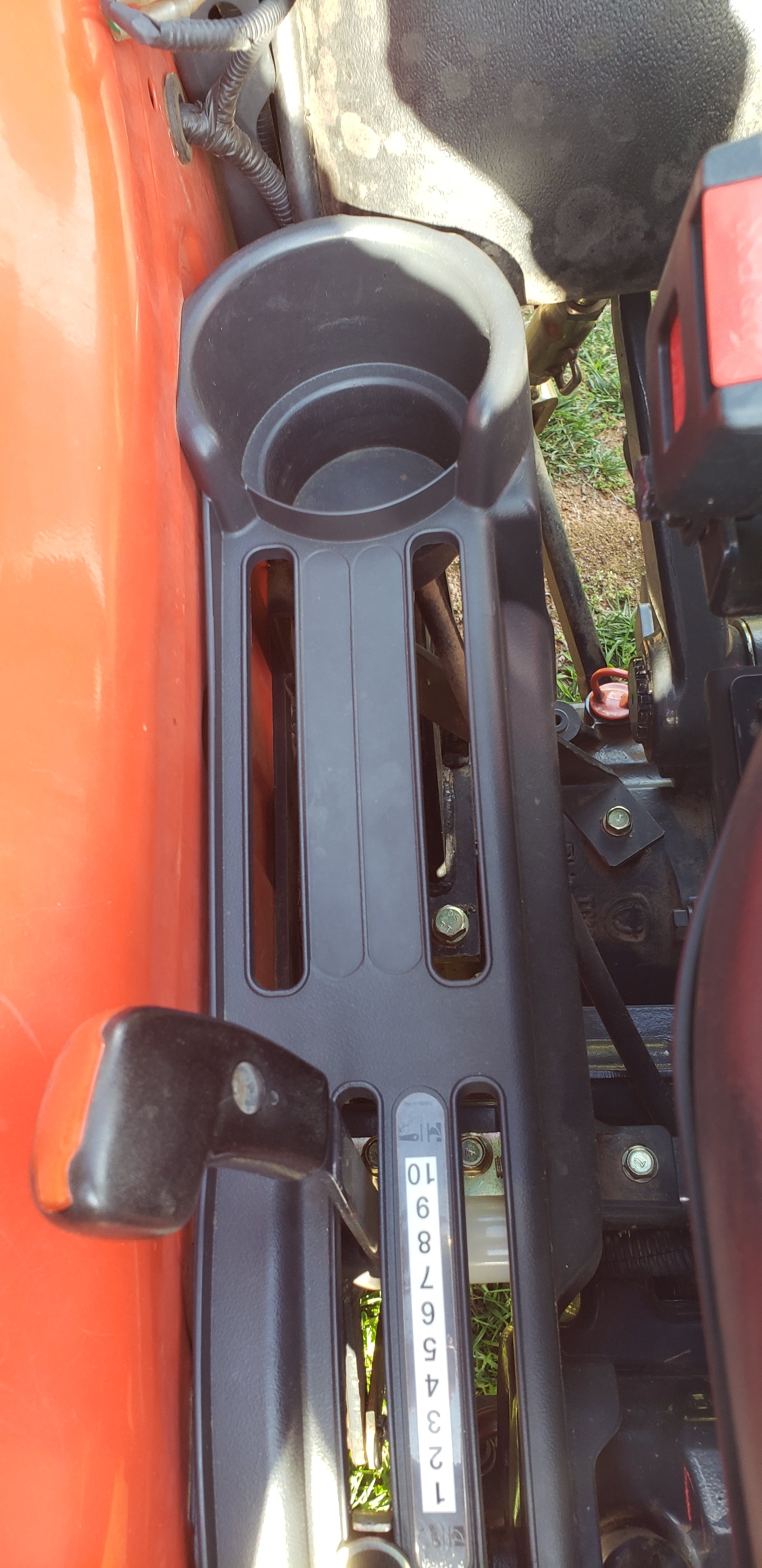

There are two empty slots on my ~2019 CK3510 between the 3 point raise/lower lever and the cup holder. Assuming these are for addons, anyone know what those would be for? I didn't see anything in the workshop manual but its also like 400 pages.

Those are for the levers that controls the remotes at the back. The remotes are two hydraulic valves that you would have on the rear of the tractor with quick disconnects so you could use those for an hydraulic top link, dump trailer, etc.

Thank you! I am actually adding a Summit Hydraulic rear and 3rd function remotes and was debating on mounting the electronic switch box between the two slots instead of the metal assembly off the ROPS. Wasn't thinking the factory rear control would be levers, assumed electronic too.

Levers allow for feathering of the controls, while electronic (without going with the super expensive proportional controls) as just On/Off. No control on how fast/flow the cylinder moves.

The Kioti version is quite well priced as well if haven’t already gone ahead with the summit rear. It was 5-600 dollars for two rear remotes if I recall.

You can also choose the type. Both with detents, both with no detents, or one of each. No way would I put up with electric controls, they're just nasty to use.
