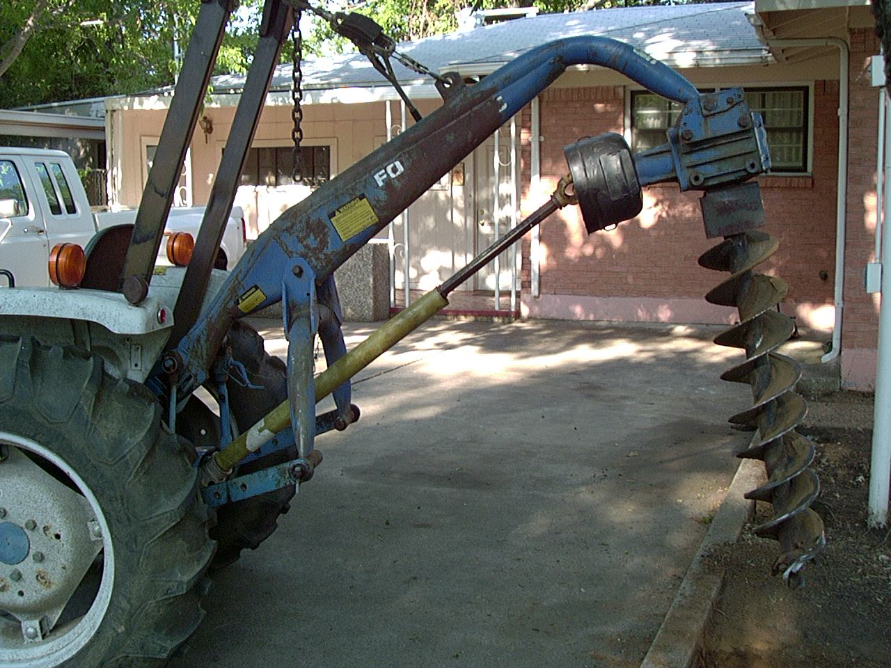

Put the post hole digger on and it won't raise
Ford post hole digger (905 I believe)
The digger turns just fine​
Why won't the 3 point hitch go up?
Here are some pics

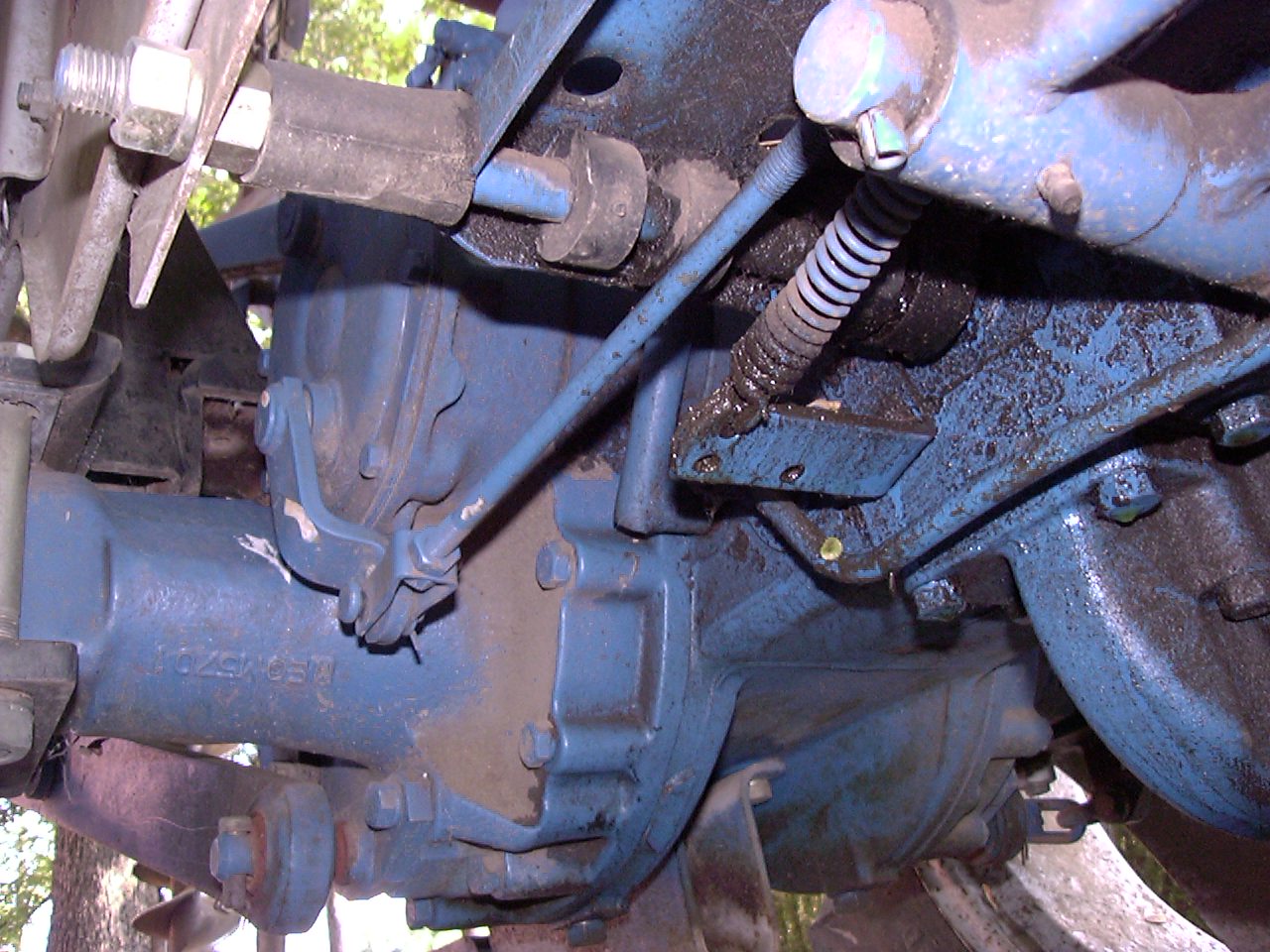

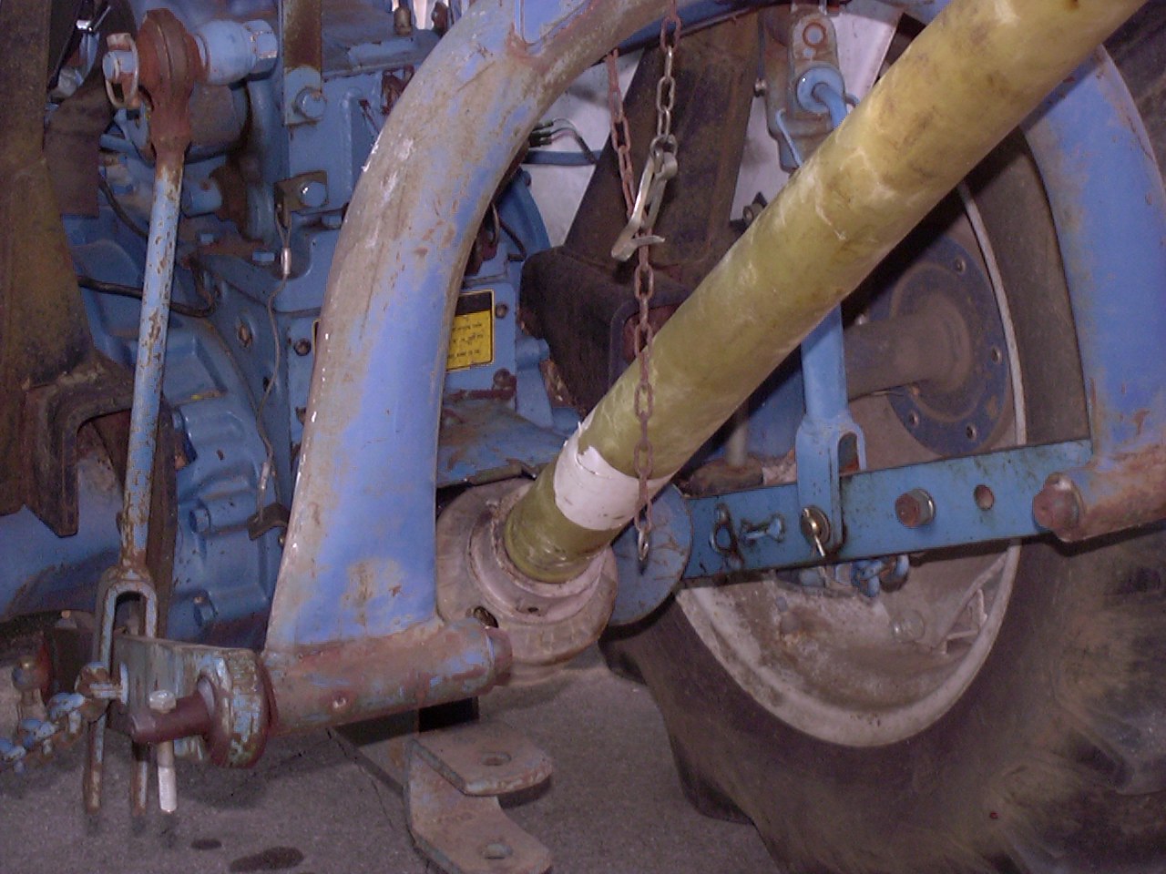

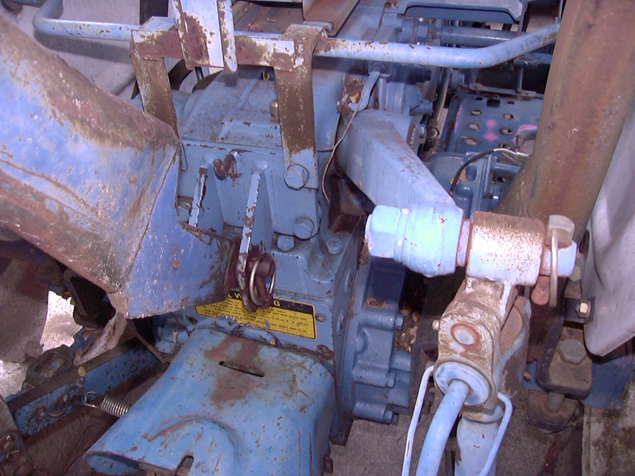

Please refer to previous post that you made . There is much good reference in there. The link that I had in there gives any thing you want to know and then some. It may bore you but it is exactly the info you need. Post follow up questions and we'll try to answer.
No pump=no flow=no lift
pump good=flow and bad lift cyl seal= no lift
there are few iterations that can cause the same.

Agreed only if you have a working pump, and functioning control and safety valves. No amount of clean oil or clean filters can help a " not pumping pump" to work. Defective valving and improperly set safety controls can not operate normally just due to clean oil either.

Some more info... the lift acted up as soon as I put the post hole digger on it. It lifted eradically in that it would be frozen then for no reason pop up into a raised position. When it was frozen I could feel the hitch trying to lift but just wouldn't do it. By putting the lever down I could feel the pressure to lift go away. Now I don't feel any of that action and it isn't 'poping' up into position anymore.
Is the pump the same one that operates the front end loader? That works fine.
