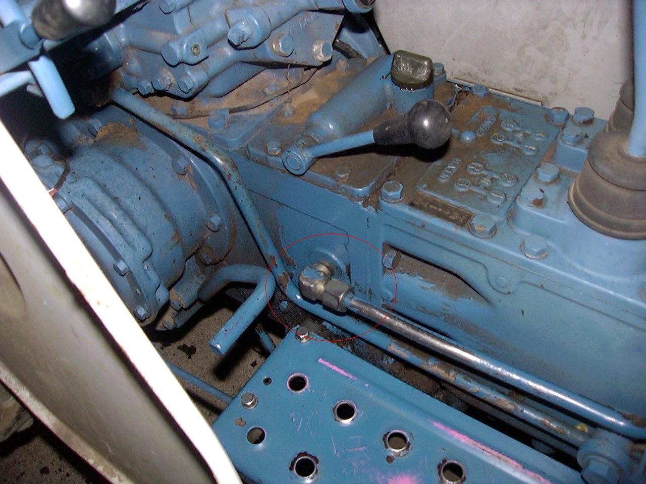

I found another very minor leak on the rigid pipe shown below. The NH site had a detail of this section and it doesn't show an o-ring but only a "fitting assembly" but I'm pretty sure there ought to be an o-ring in there. I'm going to replace this o-ring, providing there is one, and the 2 on the outlet pipe I sucked the oil from. I'll let you know how it goes and thanks again for the help and all the great resources.
Then I may give the tractor a good bath!
Sevan,
The hyd elbow is JIC fitting where it is connected to the rear diffy housing. it is tapered, if it leaks there it might be a bit loose. The other side of the elbow is compression fitting and may or may not have an oring. I guess it does not have an oring and might have a ferrule or flared. Some may like to put Teflon tape on the threaded part but not all approve it as it might get in to hyd spool causing problem. Since this connection is pre-filter before any control valve I think it'll be okay. I will not go heavy on teflon and make sure wrap the threaded part counter clockwise and not leave anything loose hanging from the end. before any dis assembly I get a crescent or open end box wrench on the outer nut and tighten it a bit to see if that makes any difference.

After cleaning it up I found it is leaking from the connection to the rigid pipe and not where the fitting screws into the oil sump housing. Even as weathered as it is I believe I do see remanants of teflon tape on the fitting. I'll try tightening the pipe connection first.

   / 3 point hitch won't lift #24

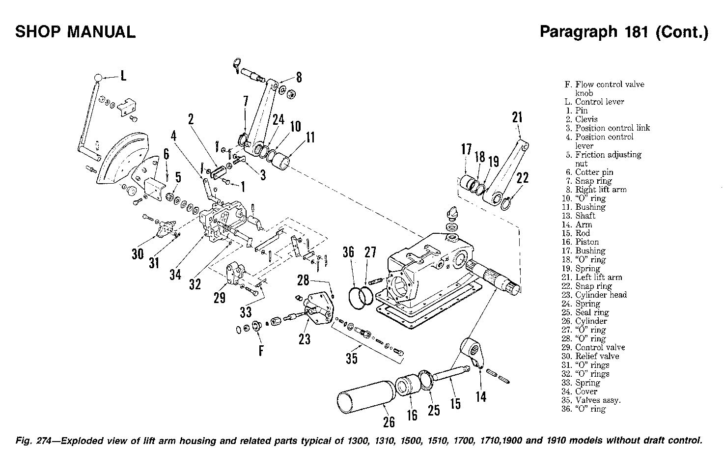

Are you referring to the 'lift cylinder' piston seal?
When I recieved the operator's manual I was suprised to find the IT FO-44 Shop Manual. I believe you have the same manual so the lift cylinder piston seal (#25 below) is shown on page 99 and attached here.
Yes. Yes, it is the seal. Take a note that part #'s on FO-44 may not be the same as NH site. The seal is right but it is actually numbered #19 on NH website rather than #25. Must use/buy the following. Take a look at the lip orientation on the seal, it is a one time deal, can not remove the new seal without damage to it if installed incorrectly.

It is done from the front side by removing the cylinder head but the lift arms and shaft must be romoved? Once the shaft is removed first then everything from #13 through #19 (NH numbers) ought to come out the front side, is this correct?
Thanks for the pics. It's difficult for me to envision the job from a figure in a book.
It looks like I'll need to replace about a dozen o-rings and a 'dealer-ordered' seal.
