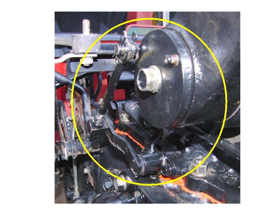

After replacing the piston seal ring on the hydraulic lift, the lift arms raise. but don't lower. The position of the end cap on the left lift arm controls some type of valve (pic below). Is this a pressure relief control ? Could the position setting of this control be the problem ?
   / 3-point Hydraulic cylinder has flow by #40
I don't think it controls a relief valve but really don't know what it does. Any reason to believe it is in a different position now then before? If not, doesn't seem reasonable that would be your problem. Do you have weight on your 3 point? Is the stop valve open?
